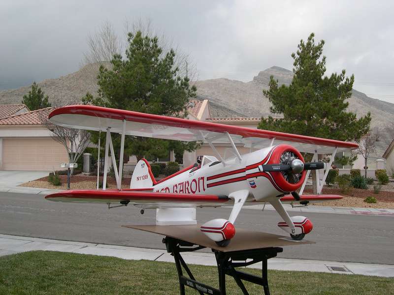

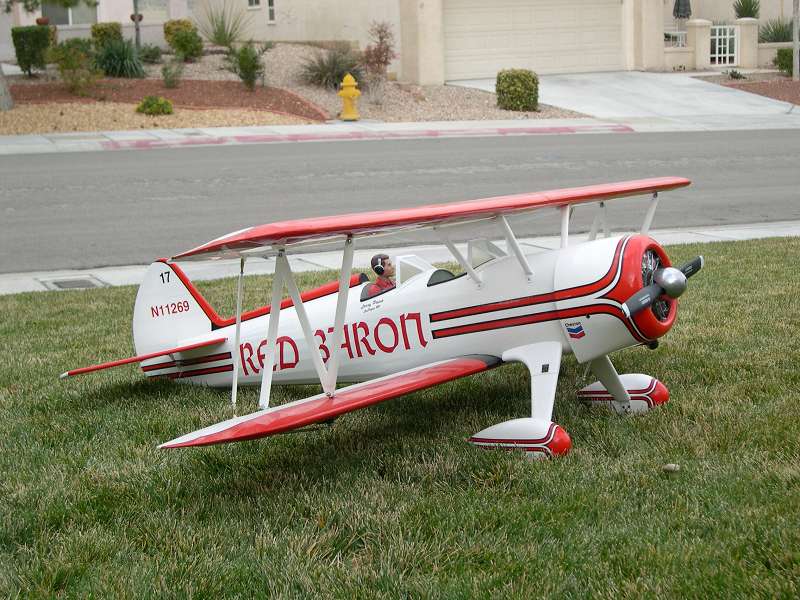

It is a great plane..you can fly it docile or a barn burner....depends on the engine & prop.
I am flying mine with a YS-120, Swinging a 16 X 8 prop. There is plenty of room for a smoke system....I plan to add one to mine when I have time,
