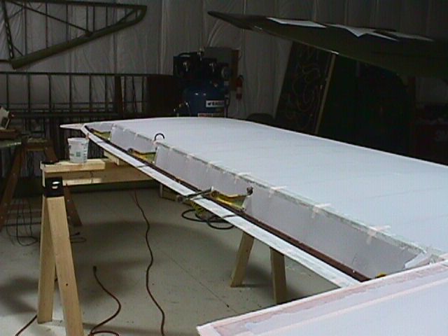

Here are a few pix of the full size Stearman you saw earlier after we covered it.
Just like covering a big model airplane!

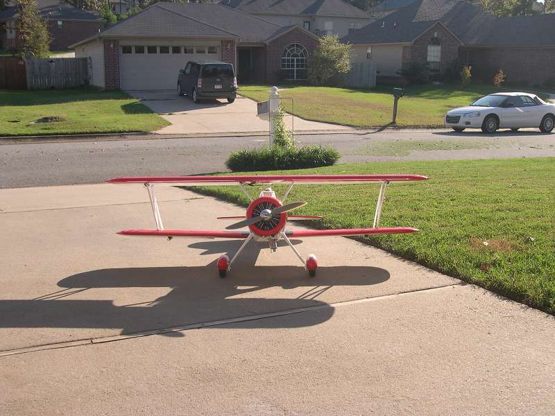

the Saito fits perfectly in the cowl. I will attach pictures of the front for your review. I used Futaba s3004 with a six volt battery. It gives me 58 oz of torque on each servo. I also used servos in both wings instead of the slave hookup. I read too many posts regarding having trouble getting the slave bars to align. It flies great though.
I put the engine in inverted, and only had to cut enough from the bottom of the cowl to allow the muffler to get through. I also cut out a section of the dummy engine, as in the instructions, to allow some air flow. Let me tellyou, there is no worry about power with this engine!
Good luck.

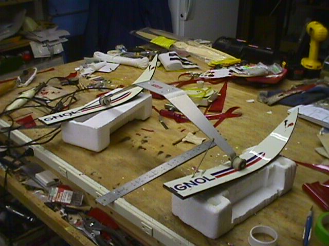

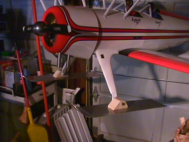

Well guys, as I said in an earlier posting it has been snowing up here in Vermont. Here are the ski's I built for the Stearman today. I plan to fly it tomorrow. Enjoy. bird.
Next EDO floats for the summer!

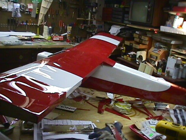

Here also is a bird I have flown on ski's. It is 27 years old. It is called 'Sapphire'. A friend of mine in Valpariso Florida designed and built it. It has a seven foot wingspan with a naca 2414 airfoil. Very steady flyer. The fuse was blue and white. The wing was blue LE. white MID. and red TE. I guess it isn't Sapphire anymore with the red and white aye?
It was tri gear and I converted it to tail dragger with the option to convert it back and forth. Also have a set of floats for it.
The ski's are cut off of cross country ski's because they are narrower than down hill. I cut the wheel hub rims down so they would fit flat and drilled holes in front and back of the hub and wrapped many winds of string and then thin CA'd it all and there you go. A 4-40 wire with a Z bend through the ski and a hole in the main gear leg with a U bend.
Enjoy. bird.

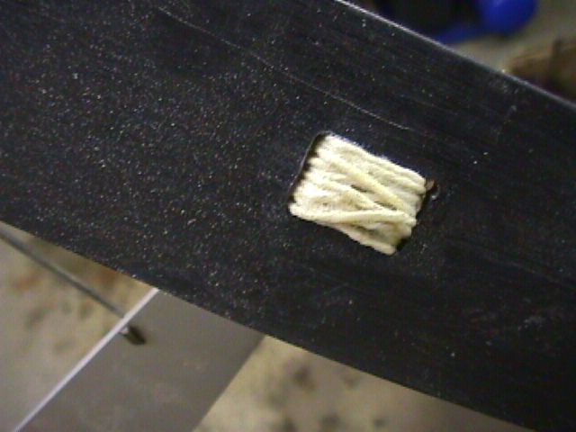

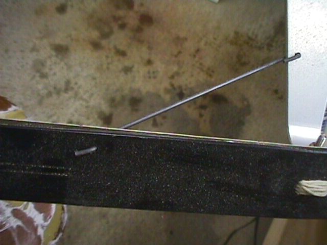

Here are some close ups of the ski's.

I used the tank that Great Planes sent me. It is small for the amount of gas that the Saito 180 uses. I could use some help on a bigger tank.

Your Stearman looks great.
I understand the 180 requires at least a 24oz. tank. Do you think ther's enough room?

There seems to be a lot of room in this plane. I wanted to add smoke later on, so I didnt want to fill the tank compartment with a larger fuel tank. I may have to though because the Saito 180 is not exactly fuel efficient. I get about a 9 to 10 minute flight at best. I have ran this one out of fuel, and the dead stick landing was not what I expected. It actually performed well. Had to change underwear after though!!!

Bigbird3,
I love your shop. There is something going on there!
Oh....nice plane too.

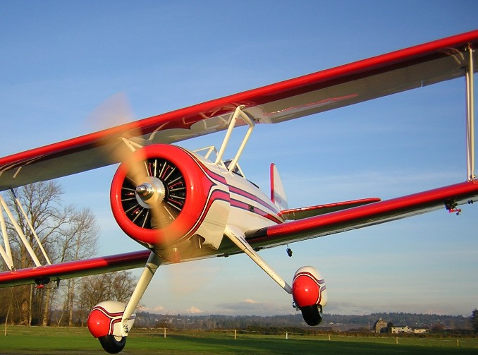

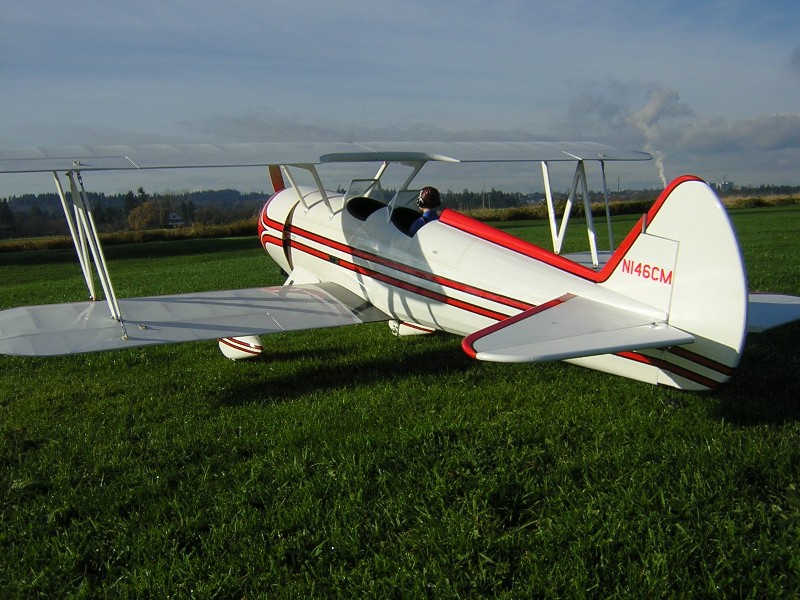

I have 10 flights now on my Sterman and found the way to stop the bouncing. Keep the tail up on landing. Don't flair out to a three point landing. You have to be dead on not to bounce. With the tail up, the plane is still "flying" on the ground. When you can't hold the tail up anymore, the plane will be going slow enough not to bounce. Works every time.

Thanks Ron. I spent all day changing the shop around trying to make more room and make things fit a little better. Yesterday a friend asked me how many planes I have and I figured maybe somewhere between thirty and forty. I counted them today. Between Kits, boneyard, ready to fly and in between I have 53! Whew! My shop is like a five pound bag with fifteen pounds of crap! I've got to thin out the herd some day. bird.

I agree. Plus, there is nothing pretier than the mains touching and the tail slowly falling to the ground.
Yours sure is pretty. That picture looks like you almost ate the camera.

Well, I kind of cheated. I had two guys hold the plane while it was idling and cropped the picture so you can't see them. Here's some more pics.
