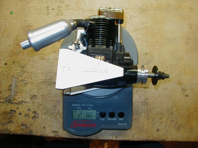

ORIGINAL: jhogie31
I use a Saito 1.80 and had to add ZERO weight!! It balanced perfectly without even installing the weight box.
How did you do that? I have read a lot of other post of guys needing a lot of nose weight, except for most of the G26 guys that seem to get it done without nose weight. I installing a lightened G26 in mine. My not get any good flying weather till spring. If I remember correctly the Stearman was flow from the rear seat, and the passenger was in front. that would mean your Srearman is flown by an Amazon blond chick. Cool idea.
Ron

A lot of the posts that I have seen are using Saito 1.00. This engine only weighs 19 oz while the 1.80 weighs 31oz. The G26 weighs 53 oz. I guess the extra weight with the Saito 1.80 gave it the necessary nose weight to keep it balanced. I, like yourself, was shocked because of the weight box that you have to build within the ARF. I was expecting it to be extremely tail heavy, thus needing to add the dead weight.
Shocking as it may sound, it balanced perfectly. It flew as if it balanced perfectly as well. It acts as if it is a tiny bit tail heavy, but not enough to add dead weight to the plane. In fact, the CG on my plane allows it to flat spin. When I put smoke on it, it will be even more pleasureable.

My G26 is at the RCignition shop right now getting a lightening and ignition job, so I can't compare weights yet.
My G26 with the motor mount and stock muffler weighs 65 oz.
My Saito 180 with Hangar 9 motor mounts weighs 40 oz. And I carry 22 oz of fuel at takeoff.
I have already got an Abell mufffler for the G26, it is several oz, less the stock one, and I think the G26 should be around 10 oz. less including the ign battery. I plan to carry 10 oz of gas. So if I am estimating correctly my takeoff weight should be about the same with either engine.
I am pretty sure I will use the G26 here because the big SAITO has found a happy home on the ULTRA STICK LITE.

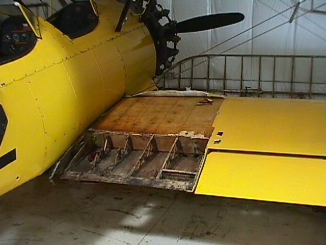

Here are a few photo's of a stearman I am working on. bird.

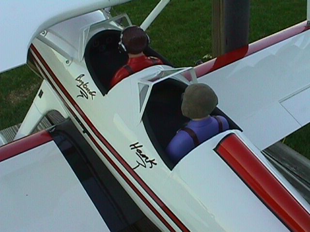

Now, here are a few of my model.
The mustach is made by gluing the end of a paint brush on with med. CA while still on the handle. Then cut off and trim.
The leather helmet is from an old latex DGA figure I had laying around. Fit just right. The pilot actually looks like my friend Hank who owns the full size stearman. Enjoy. bird.
By the way, be careful about how hard you land. It will crack the molded fiberglass on the gear. Also, Use pliers on the cabain struts to ajust them or it will crack it also.
