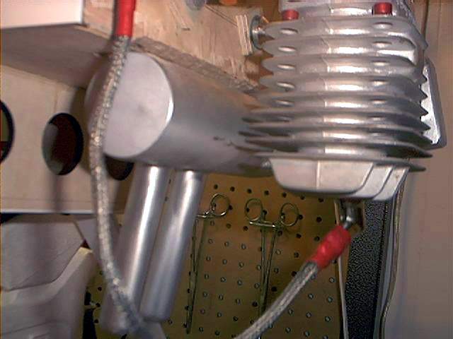

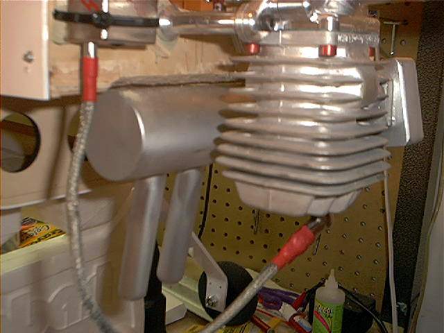

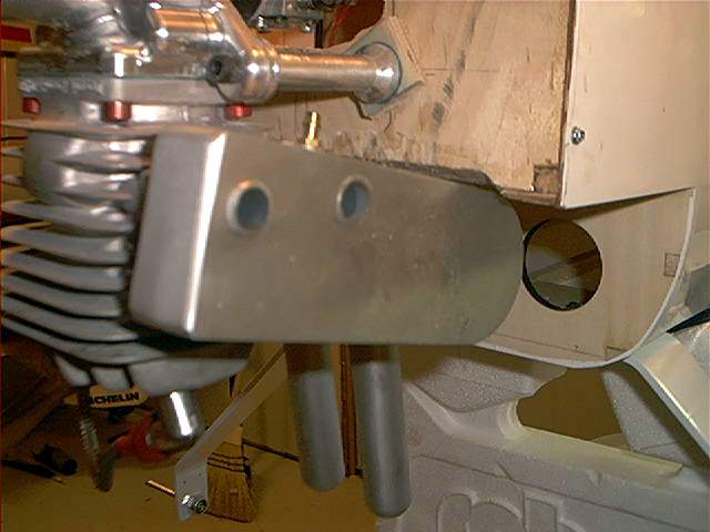

Old 09-19-2004 | 10:56 AM
  #315
coony2787's Avatar
My Feedback: (33)
Posts: 870
From: Oxford, MS
Default RE: BME Edge?
I thought i would post a couple of pics of the engine mounting. I still lack tieing up some wires but you'll get the general idea.
Chad

Old 09-20-2004 | 04:03 PM
  #316
Joined: Oct 2003
Posts: 21
From: west jordan, UT
Hi coony. I just received my edge and was trying to figure out the right thrust. So if I am reading your post right. I need to glue the right side of the fire wall back 5mm. And then mount the engine 5mm left of the center of the fire wall? And this is based on the view from the cockpit?
Sorry if this sounds like a dumb question. But this is my first plane where the fire wall and blind nuts were not already installed.
Thanks for the help
Old 09-20-2004 | 07:40 PM
  #317
coony2787's Avatar
My Feedback: (33)
Posts: 870
From: Oxford, MS
Yep you got it right. Mine turned out great , motor centered perfect in the middle of the cowl with those measurement and the spinner lined up with the cowling.
And yes right and left as you are sitting in the plane
No such thing as a dumb question. It's when you not sure and dont ask is the problem..............
Chad

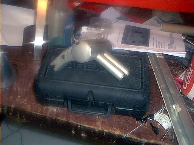

Old 09-20-2004 | 10:23 PM
  #320
coony2787's Avatar
My Feedback: (33)
Posts: 870
From: Oxford, MS
I have 2 styles of pitts muffler's and both had to be ground down to fit .
The one that is in the picture is a B.C.M i dont know what that is but it is stamped in the muffler. I got it off of ebay for 25.00 and i just took a gamble that it would fit one of my 50cc engine and heck it fit my DA and my ZDZ. I dont think i will use it on this plane. I think that stands for bisson cutom muffler.
Here is a pic of the other muffler. It is a SL 2123 i guess it is slimline.
It just seems that with 2 muffler that one would fit and wouldnt have to cut the firewall. Oh well just my luck at least i dint have to cut all the way threw the firwall to get it too fit.
Is anyone else worried about the top of the firewall not having any support ? Just seems that if you had a hard landing ( heaven forbid) that the downward force from the wieght of the motor just might pull the firewall off ? A hard blender or parachute might even be able to jerk the motor off maybe ? Or did i miss something there in my kit and there was suppost to be more wood to the firewall instalation other than the tri-stock and firewall? Any thoughts ?
Chad

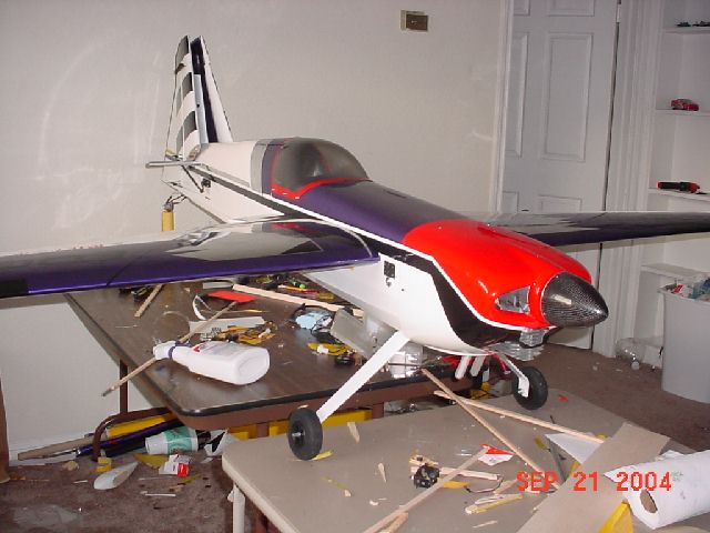

  #322
Dago Red's Avatar
My Feedback: (11)
Joined: Aug 2002
Posts: 2,921
From: Orange, TX
getting closer, just need to get the chargers for the 2400 6v Mah Battery, and a prop.
ID:	175720   Click image for larger version
