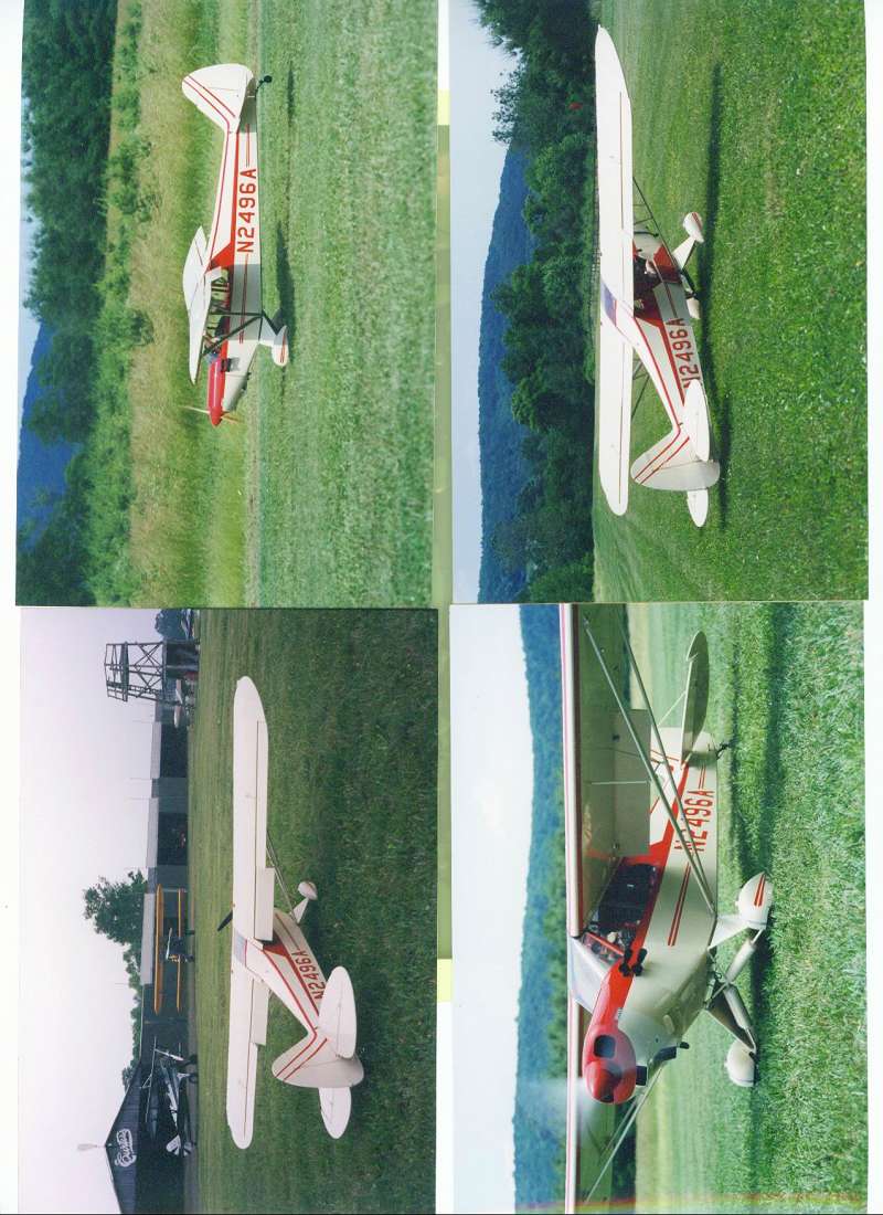

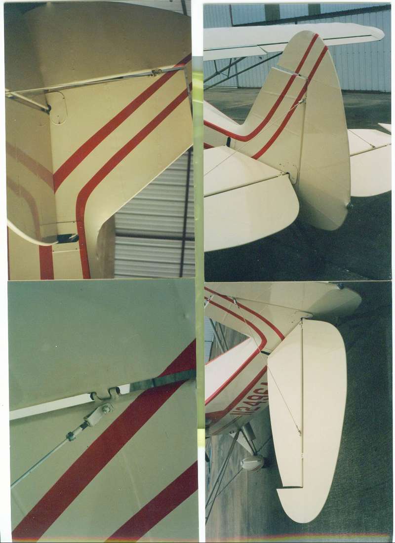

here are a few pics of my 1/3 scale super cub--a reproduction of my full size plane -the pics show details of tail wires , stab mount , cockpit ,etc. have more if folks need 'em

WOW!!! Awesome! Was this a kit? More please.
Is the picture of the tail bracing your real one or the model? Excellent shots.

no Bud is a scratch built 12' original design- OS 300 twin with on board starter -flies very scale - flown @ Top Gun ,Masters, Nats etc.

the tail bracing pics are of real one -am looking for model pics of tail maybe these will blow up enough? at any rate - they are made up of brass and Dubro forks filed to scale profile -exactly as pics of real one-hope it helps

Very very nice Phil....The N number looks familiar, was yours the one the hanger 9 ARF was modelled after? Where in the world did you get the plans? Thanks again, excellent workmanship.

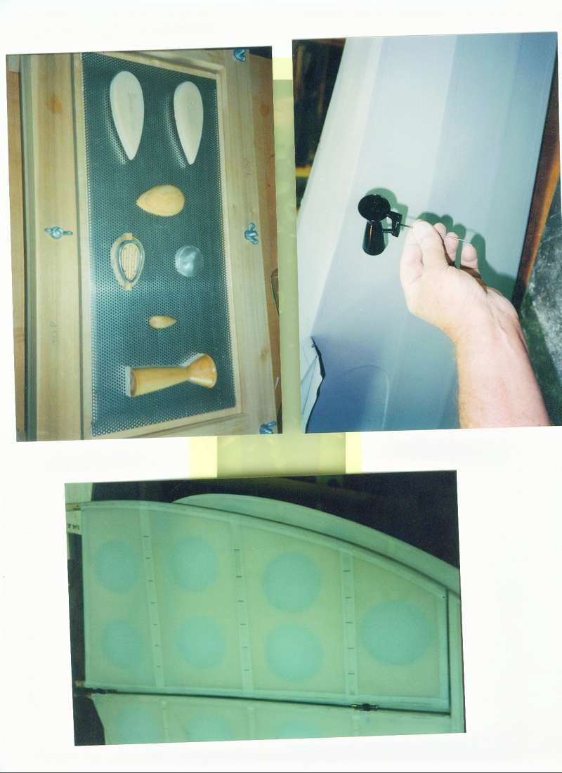

well- I drew the plans - mostly from measuring my plane -took three tries for virtualy every part - thought I knew exactly how they looked since I'd rebuilt the full size twice - wrong -
yes it was the model for the hangar nine - they did a decent job too - I have one and fly it a lot.
The cowl and wheel pants are from my plugs -fiberglass- there are 23 ABS parts from my molds that I vacformed-such as the steps on the pants, aileron cable covers, venturies etc.
I used Balsa USA's windshield, rib , and most of their gear -wonderful folks to work with.

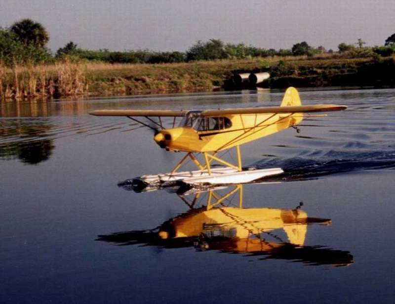

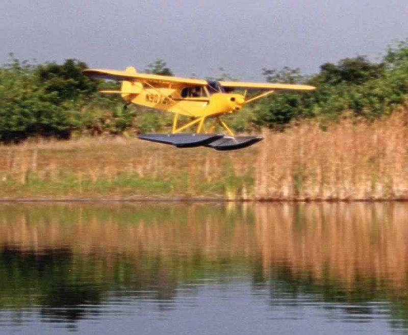

btw-thanks for the compliments - it was a labor of love -would you believe I also made an L-21(super cub L-4 ) from the same drawings and pics of the full size put a 3w 80 in it and used balsa usa's floats -fly on land and twice a week on water-ultimately I intend to make the floats amphib-big job to get it right though

this was the prototype -balsa usa floats, j3 and my cowl-feasability study
