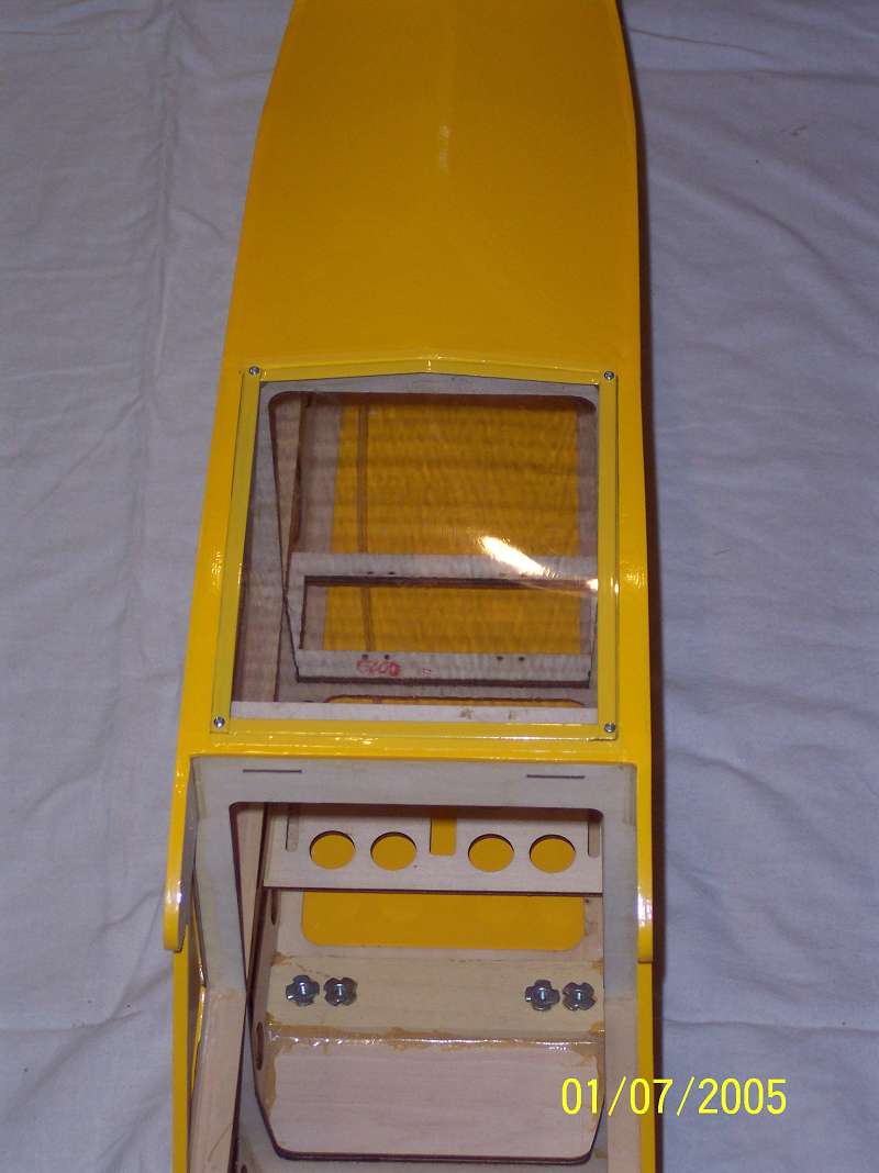

Hi Bud, I'm going to try to send the photos.

Looks Good Andy, that should hold real well. How about some pics of your engine installation?

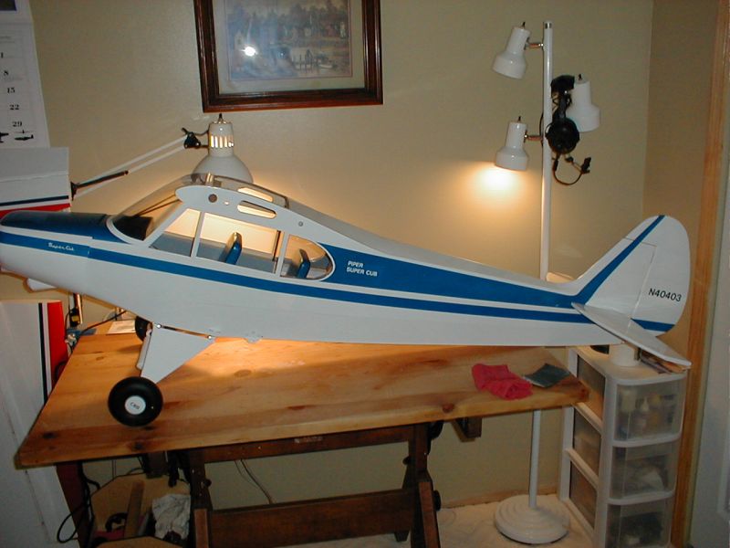

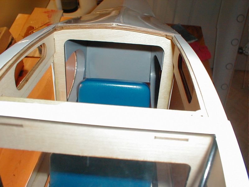

Ric, what glo system are you using? I bought the electrodynamics setup for mine. I'm working on my interior now...got some pictures from the super cub .org web site. Still a long way to go. Not scale by any means but it does dress it up a little. Here's one pic of the rear section and one showing a portion of the side panels and seats. Just 3/32" balsa, I filled the grain with moistened drywall paste and sanded most of that off and painted with LustreKote...no weight to speak of.

Looks good, better than where I am right now. I plan to use an Electrodynamics 103, I have one on another 160 and it works like a charm. Maybe I can put the status light on the instrument panel if it isnt too far out of scale. I like the idea of hiding the switches and fuel valve behind the cowl cheeks, will probably do that. Cant work this weekend, will be in your neck of the woods (Laytonsville Md) with the grand kids.

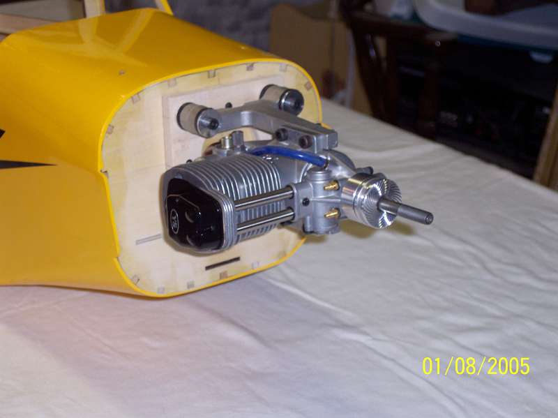

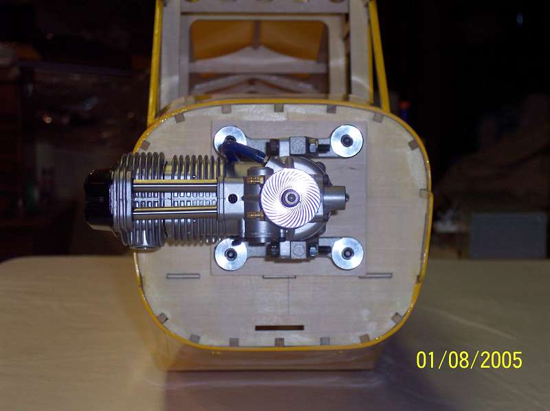

Hi Bud, I'm sending pics of my engine installation. It's a YS140sport fits in great. Your cub is looking great. What did you use to make the seats? I thought about using foam and painting. I have a ways to go before I get there. Now that I see your cub, I wish that I had the whit one. The yellow will look good.

Nice clean engine install Andy, glad it worked out. I got the seats from a flea market, it was a dynaflite 1/4 cub interior kit..vacu formed seats. No longer made. If you can get some urethane foam it will accept paint. Kinda itchy to work with.

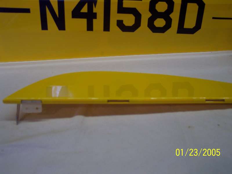

Try as I might, I can't seem to get a close gap with the hinges supplied with the kit. The barrel is kinda wide. I had a hard time getting the slots deep enough with a #11 blade. I thought about putting a recess in the stab and fin to sink the barrel in or to just use ultracote and seal the gap so it looks better and prevent flutter. Suggestions anyone?s anyone?

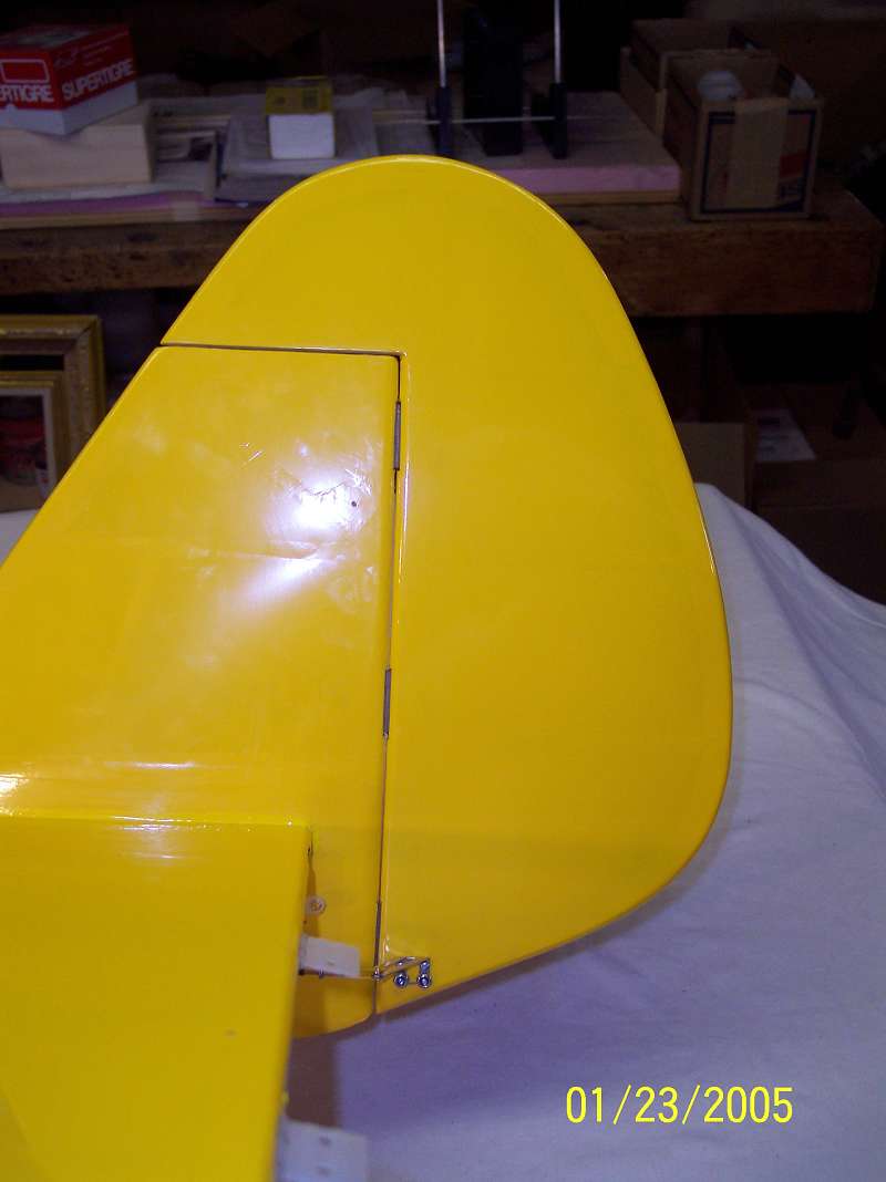

Hi Rubyred, name is Andy. I am building the same DPM super cub and I am having the same trouble with the hinging. I peeled back a little of the covering on each end of the slot and with a razor I cut a v groove to accept the barrel of the hinge. I send pics. After the slot is cut, I stuck the covering back with a trim iron, very neat. I get a good tight gap but it can't be totally closed. They simulated a real cub by makeing both edges round and that will not allow for a toatally gap less joint. I don't think that a totally closed gap is not necessary in a slow flying cub. In my picture I get a very tight gap. Be careful not to squeeze the gap too tight as it will not give you enough travel.You can see a little trim tape used to fill the glue joint of the stab. The color is a little off but it still looks good.

Andy,thanks, good idea. Your rudder gap is more to my liking and I think I will give that a try.

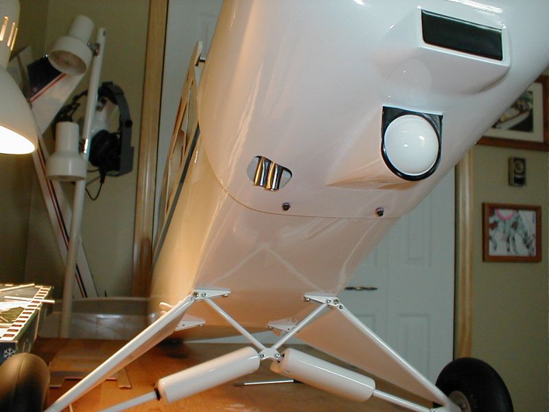

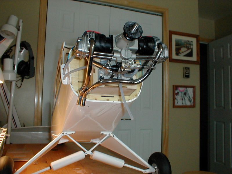

I finally got around to my exhaust, after going through three pieces of 3/8"x 19" plumbers chrome plated copper pipe and a brake line bending tool and about five hours and many cups of coffee I have it done. The fuel fill and drain line is to the left of the picture on the side of the fuselage as is the overflow...I used the piece that the manual said glue into the slot at the bottom of the f/wall and mounted it here, hidden inside the cowl. The switch will go on the other side also hidden inside the cowl. Should have a unique sound with one header pipe shorter than the other? Still lots to do.

Bud, the exhaust looks really great. I got the pipe and gonna do mine the same way. I need to find a bender first. Anyone know where I can find some seats?

Looks great, but I hate to be a party pooper, but for cooling isn't the exit supposed to be at least twice the size of the entry point?
Just asking

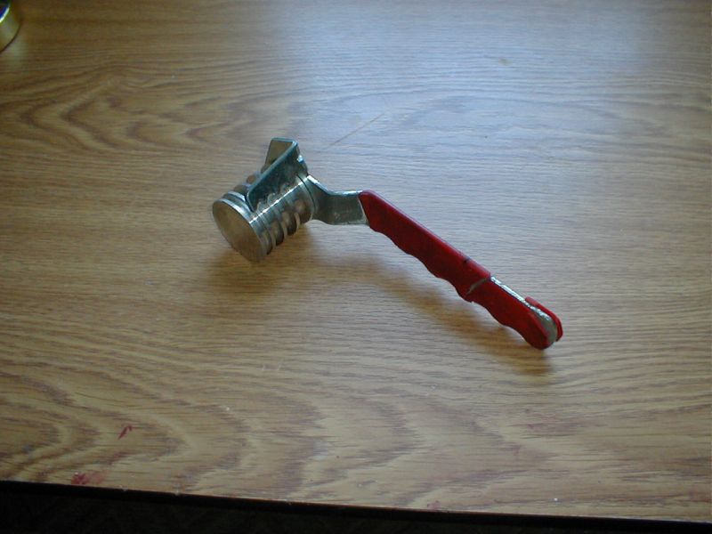

Lee,
Must not be so because the very expensive flex pipe they sell for this engine has the same diameter at both ends. I've never seen any as you mention.
you brought back memories of otis AFB....I spent some summer camps there when I was young and in the ANG out of andrews AFB, 1953 and 1954 as I remember. We had my favorite plane back then, the P51 before bringing in the F86.
Rubyred,
You can get a brake line bending tool at any automotive store...here's a picture of mine. You're on your own on the seats...I got lucky and found mine at a flea market from a discontinued dynaflite cub interior kit.

Sorry, I wasn't very clear. I was speaking about the cooling holes for the engine and not the pipe. There isn't a big enough hole in the bottom of the cowl to allow hot air to escape. That ratio of cool air in/hot air out should be 1 to 2. Don't want your nice twin to burn up too quickly.

Guess I misunderstood....That's something to look into but after looking at Dick Pettit's cub with the same engine I see no enlarged exit hole. I have pictures of other DPM cubs and see none there either? Perhaps Dick Pettit can better answer that question.
