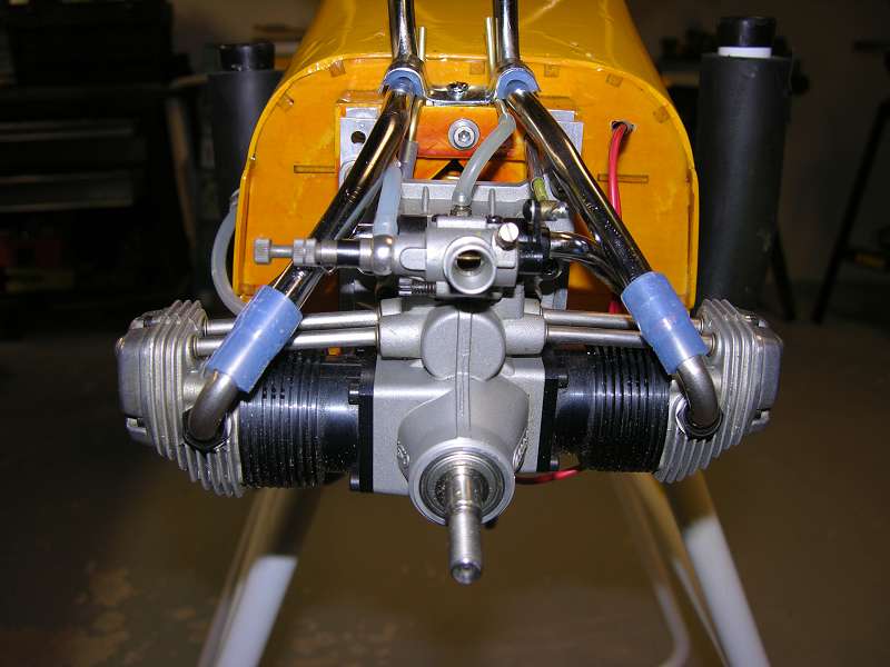

Looks real good Ric, now that you have yours done check out this link someone sent me.
http://www.keleo-creations.com/Twins/OS.htm
What are those blue sleeves? I like!

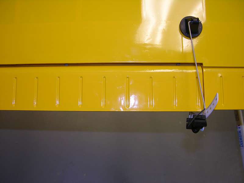

Has anyone had trouble getting the correct throws on the ailerons as suggested in the manual which is 1 3/8" on hi rates? If I do I end up with a 3/16" gap on the bottom side of the wing and a noticable gap on top. Haven't glued anything yet.

Hi Bud I had same problem. The instructions infer this by saying you might have to stand off. I got my throws and have a gap like you. I set my flaps so they were even with the ailerons and it dosn't look to bad. Only thing is they don't align with the wing tip.

That's the part I forgot to mention....it doesn't align with the wing tip. Thought for a minute it was just me having that problem. Thanks,

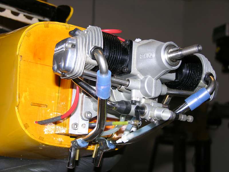

I was aware of the Keleo exhaust extensions. I didnt go for them because I was concerned about clearing the inside of the cowl. The angle of the exhaust pipe has to come close to the engine crankcase to stay inside of the cowl, especially for the left cylinder which is offset closer to the prop by a small amount. They look like they have the right shape, but the actual dimensions are key. Also, where they come out of the bottom has to be right. The only way to find out is to buy one, kind of expensive experiment. I got the blue silicon tubes from a hobby shop, they are used to attach tuned pipes to mufflers. They come in various sizes. also had a little trouble getting the full throw on the aerilons, I compromised between making a grotesque gap or less throw. I got about 1 1/4 ". My Sig 1/4 scale cub has been flying well for years with less throw than that. If you mix in rudder, the result is even better.

I have been talking with Keleo on his exhaust for the OS 160. Apparently with some pictures of the engine installation mainly head on and at 90 degrees to the firewall he can lay a protractor on it and setup his jig. I told him about my concern of the right cylinder exhaust hitting the cowl and he is going to see what he can do about that clearance. He is busy now so Im waiting for a time table on when he can get to mine

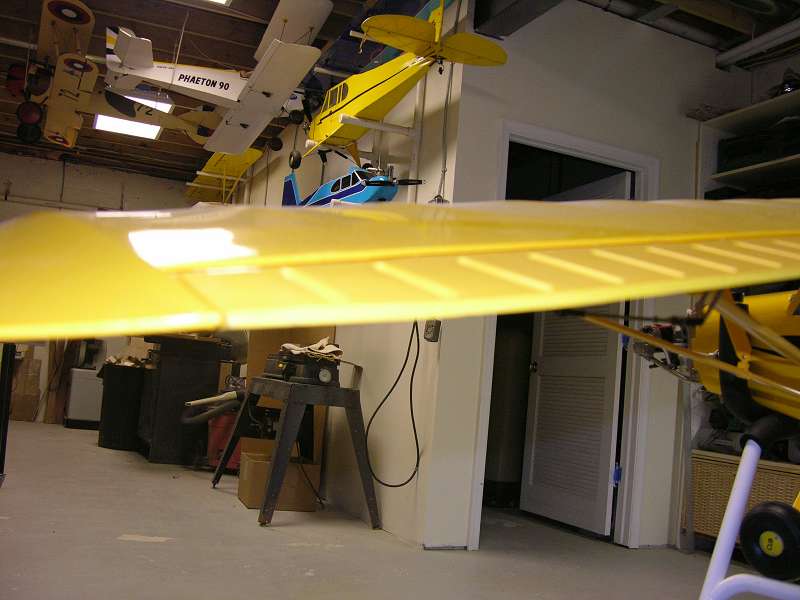

O.K. Made my decision....i'll compromise and set for 1 5/16" hi rates. I'll use hi rate ailerons and lo rate rudder and elev and mix in some rudder. If that don't work i'll build a bigger cub
Ric...nice shop! Is that a nieuport 28 hanging up? Proctor?

Yes, that is a Nieuport 28, Balsa USA. It had a G 23 in it, I am converting it to a 3 cylinder Saito 170. The fuel proofing on the colors is the big hurdle. I have too much stuff, I'm going to try to sell some at the Central Penn flea market in March. I'm going to be in Laytonsville all next week watching the grandkids, no airplane work for awhile.
