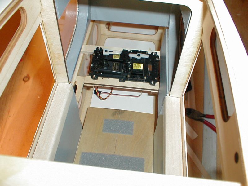

I went through this thread looking for ideas on where to locate the throttle servo for the OS 160 FT. I didn't see anything in the photos. Looks like a tight fit since the link wire must be run low under the tank tray, and I'm not sure where to put the servo. Any suggestions?

Daniel,
Sending a picture of my servo installation. I moved the tray back some in order to get the rear seat positioned in a more scale like fashion. The throttle servo is the one without the arm. I bought a package of HD arms from the hobby shop which had a longer arm in order to reach the cable which is on the right side of the plane and behind the panel I built from balsa. I drilled holes in the existing framework and ran the cable through them to the 160. Not hard to do at all. Look close and you can see the black cable sleeve on the right side.

Daniel, I was just thinking, how about using a sub micro servo for throttle? You could mount it just about anywhere up front and even on the engine box. This might not work out since I haven't researched it for mine yet, but was thinking when you use small stuff it makes location easier.

Good thought, 3-2's. I would use a micro except I have none and I need a trip back home to the world get one. I have dozens of standard sized servos, though, so I'm stuck with that for now. I mounted my servo almost on the floor behind the third bulkhead from the firewall. this gives me a straight shot to the throttle arm with the supplied wire. Looks like I will have plenty of room for the other goodies to fit.
