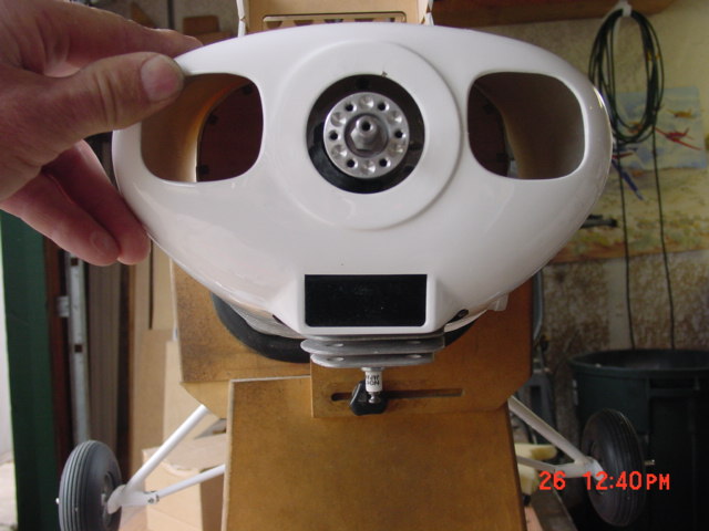

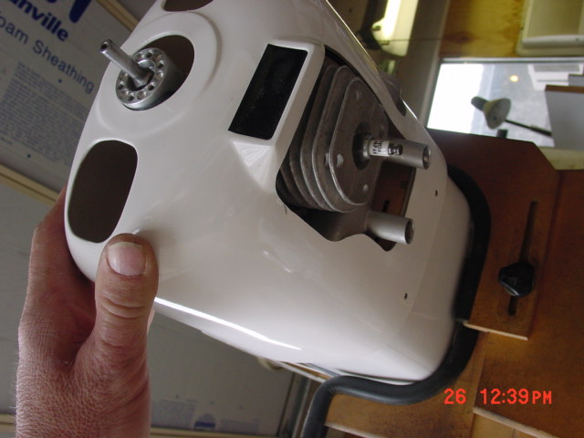

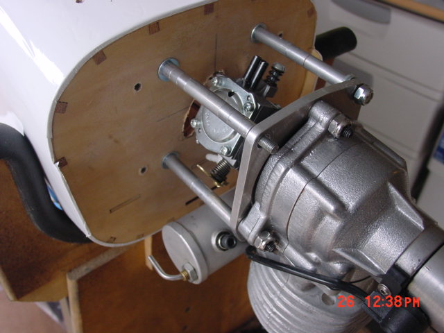

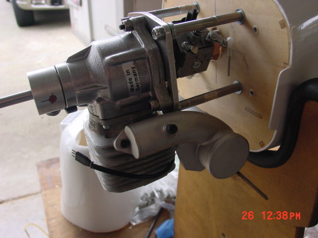

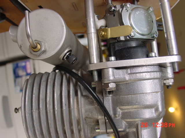

Default RE: Dave Patrick super cub
Hi Bud.
Here are a few photos of my 3W24 in the DPM clipped wing. Hope these help you or anyone else contemplating going gas instead of glow. Regards. Dave

Old 02-26-2006 | 10:09 PM
  #637
Hill202's Avatar
My Feedback: (24)
Joined: Jan 2004
Posts: 1,351
From: Peachtree City, GA
Looks good. Were your wheel pant brackets loose?
Old 02-27-2006 | 12:05 AM
  #638
My Feedback: (128)
Joined: Mar 2004
Posts: 31
From: Cottonwood, CA
1 was unattached. I enlarged the hole and used a mini torch and solder. I built the solder up and had good flow, when cool, I filed it off almost flush. Then a good clean up with lacquer thinner and white paint. It is a good repair and will most likely hold up. Regards. Dave.
