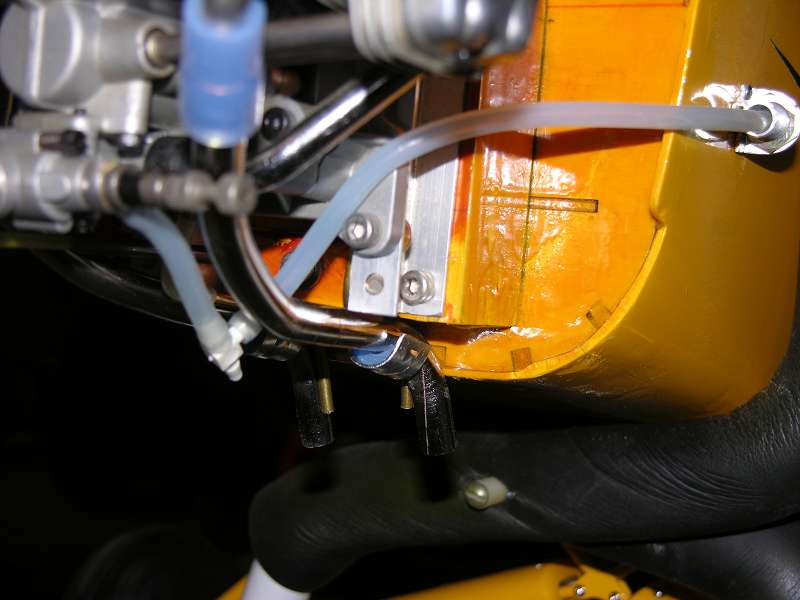

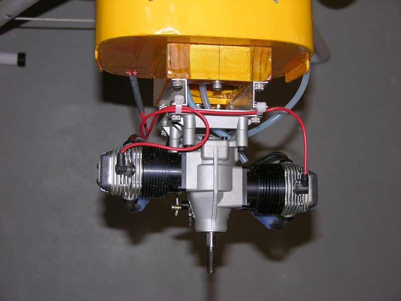

The dimensions that I used are as follows:
Wood spacer = 1 3/16
aluminum channel mount = 7/8
Engine height = 4 3/4
Total from firewall to prop washer surface = 6 13/16
This build up gave me the 1/8 clearance from the back of the prop to the cowl.
I used a two piece spacer arrangement, wood and aluminum, as I described in my earlier post. The dowel stand off system described by Dick Petit in earlier posts is an easier way to do it, but I prefer a solid continous mounting surface for the engine that the metal channel provides, and I like the shorter mounting screws, although there are more of them. The wood spacer mounts to the firewall into the captive nuts that are factory installed, and the channel bolts to the wood spacer into brass inserts. I offset the channel mounting bolts from the engine mounting bolts so I can remove either piece as an assembly. There are holes drilled into the flange of the aluminum so I can come straight in with a hex key to undo the bolts. The result is a solid engine mount that would be a better protection for the engine if I ever do a "face plant" with the cub. This probably weighs more than the simple dowel stand offs, but I will need nose weight anyway, even with this setup. In another airplane using this arrangement, I was able to mount lead pieces directly to the metal channel to get advantage of a more foward placement. I dont think I will need balance weight on the cub once I install the on board glo system under the fuel tank. I hope this helps. I love this kit

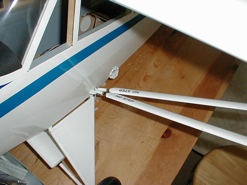

I'm nearing completion of my DPM cub and am wondering how I'm going to transport the wings. Now that I have the struts all adjusted I hate to pull them apart to fit in a wing bag. Anyone gave it some thought on how they are going to transport the wings?

Just an additional thought on the engine mount. If you decide to use a channel like I did, try to find one that is deeper than the one that I have (7/8). Ideally, the depth should be as close to the final standoff dimension that you need without having too thick a channel wall. Then you could use a short bolt through the lower flange into the firewall captive nuts, and short bolts through the upper flnge into the motor mount. The closer you get to the standoff dimension you need, the smaller the wood spacer box has to be. The goal is to avoid long bolts. Good design practice should load a bolt in only in tension and shear. whereas bending loads are detrimental. Its hard to avoid bending loads when you use long bolts, a large clamping surface helps.

I went to home depot and got my C channel. The largest size was 3/4 of an inch. They did not have 7/8 C channel. do you mean i should use C channel that is 2" or larger instead of 3/4? I guess i will have to use the 3/4" since it was the biggest they had. Could you tell me how long the wood pieces were on your box? It looks like you epoxied 2 short pieces between 2 longer ones. Thanks

I made the vertical wood piece 4 3/4" long, the horizontal was 2". This put the channel in the center of the wood spacer, and the length was enough to allow a straight shot with a hex wrench. It was also able to fit inside the cowl without shaving corners. What I meant with the channel height was to try to make as much of the standoff dimension come from the channel piece instead of the wood spacer. You will need to get around a total of around a 2" standoff from the wood and channel combined, using the OS 160. A smaller wood piece shortens the bolts needed to mount the wood spacer to the firewall. You can glue them instead, but I made mine removable. The problem with getting a deeper channel dimension is that with the limited stock that home centers carry, when you go up in size, the channel wall gets thicker too, and it gets out of proportion for our use. Taller channel sections with thin wall sections might be available from scrap pieces from aluminum storm window sections.

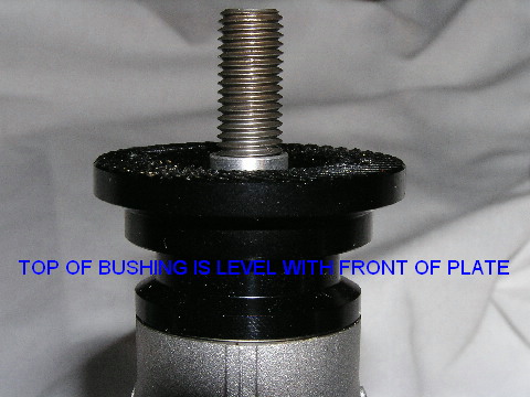

BUD, got my adapter BUT have had the ?? dry heaves - montezuma revenge going on, so haven't taken pict . The bushing did come with adapter, that goes in back plate BUT!!that OS 160
had a recess area in the orginal prop backing hub, which allows the Tru turn bushing to fall right thru the tru turn back plate ?? and reside in the recessed area - so it does not good holding the Tru Turn back plate concentric to prop shaft - gonna hve to find something else ie. bushing or something as long as the recessed area is - OTHER wise bushing with Tru Turn -simply slides on down prop shaft .. te

Hey Tom, If you call Tru Turn they can supply you with the correct 12mm adaptor for you. The hole in the spinner back plate should be 12mm also. I have the same engine combo also and it works great. Fired it up yesterday for the first time runs great.

Hey, Thanks for the note, was reading on the package " 8 mm" bushing Hmmm needs to be at least longer - 2 x as long , trying to figure "how" to upload a pict ?? think i got it ?? yep supplie bushing from TT falls right thru spinner backing plate , and sits in recess of org prop backing plate .. te

put a bit of thin ca on the outside of the bushing while it is in the back plate of the spinner. Just make sure its flush on the prop side. No load front to back. Load is side ways spinning.
