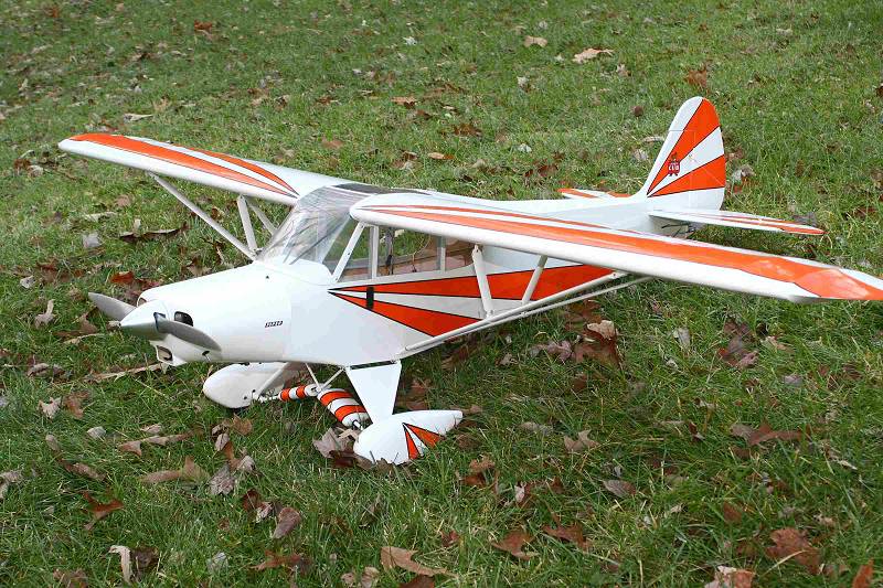

OK, I'll be the first.
Stock all-white DP Super Cub Clipped Wing with OS 160 twin.
I put the orange sunbursts on along with striping tape.
100% stock, 15.5 pounds with onboard glow lighter.
To be flown in a week or so.

Beautiful Dick! I wonder if DPM will ever offer the wheel pants and wings so those of us with the full version can have an option? I asked awhile back about the pants and was told they could not be purchased seperately. I assume the cowl will fit the original version...I like it better than the one with the oil filter.

pettit is the surburst from the factory there is one for sell on rcu just like yours yours is nice [&:]very nice going to get the credit card thanks[&:] frank

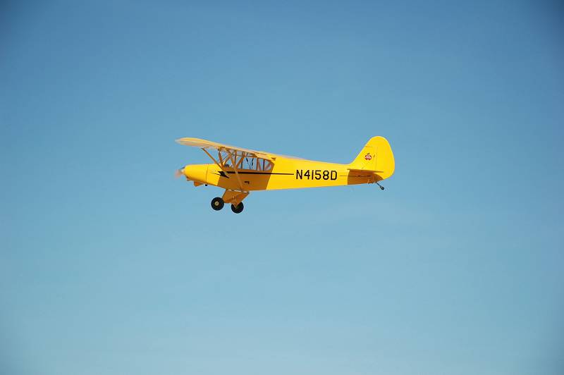

Here's a pic or two of my Super Cub flying which I neglected to upload previously. It flies! Here we are flying at an old Gulf War vintage Apache pad in Dhahran, Saudi Arabia.

Daniel, Wow, what a flying site you have. So, is the cub fairly easy to land smoothly on a hard surface without allot of bouncing? I always have prefered a grass runway for taildraggers for a smooth landing. I see your using the flaps. Are they fairly effective for landing?
Nice job, Mark

Good question, Mark. The Cub proved to be a little bouncy when I tried full-stall 3-pointers (I tested the gear pretty good). It definately flies like a Cub. Wheel landings are better and easier to pull off, especially if there is much wind to contend with. It also flies like a Cub in the air - lots of rudder required for turns, etc. Like they say, the Cub is very easy to fly, but very difficult to fly well.

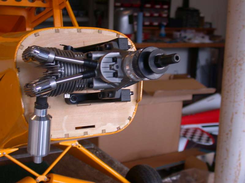

I've had one person tell me that the Saito 150 will fit in the supercub and one tell me that it will not. Can someone let me know if it will fit without cutting the cowl?

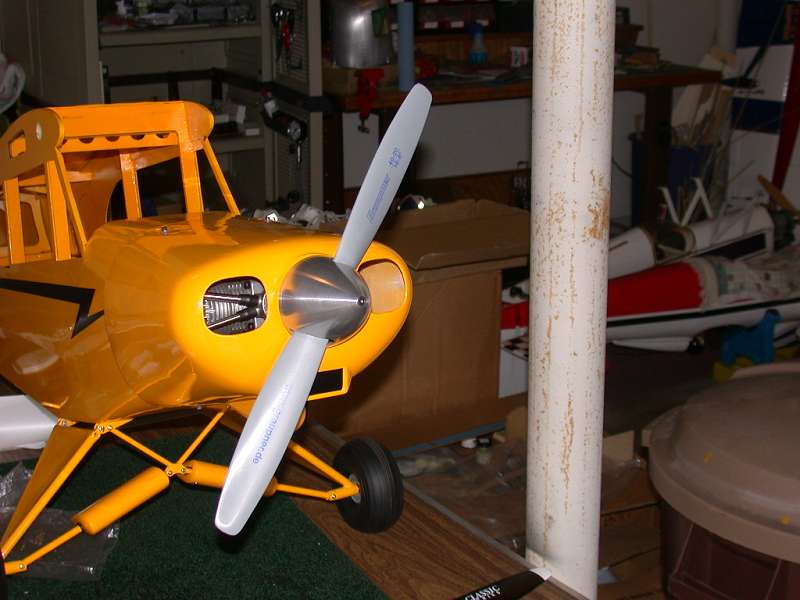

never mind after reading further I don't think it will fit. How about the saito 125 for the clipped wing version?

ORIGINAL: Hill202
It will fit.

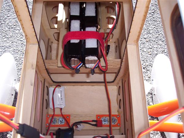

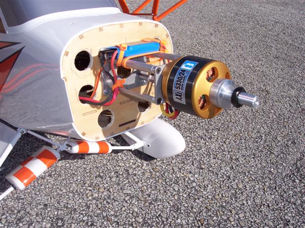

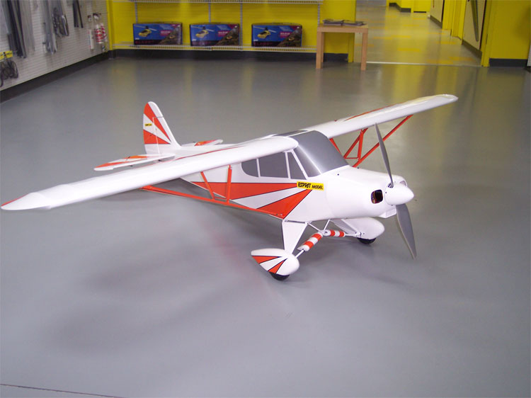

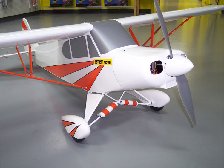

I went electric, nice clean, no death sticks, and QUIET
http://www.espritmodel.com/l_piper_pa18_cw.html
www.espritmodel.com
Piper PA-18 Super Cub (Clipped Wing):
One of classic models every one of us must have. The Cub is also our biggest and heavies plane so far we have converted to electric. This model is pure joy to fly, scale like performance, smooth as a silk.
AXI 5330/24, TP6000 10S3P Li-Poly battery pack and APC-E 21x14 propeller.
Flying time is around 20 minutes per charge.
Wingspan: 88"
Length: 72"
Weight: 16.5 lbs.
