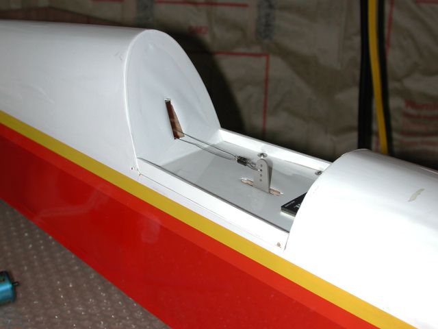

Only mod was to side mount elevator servo under canopy
for better pull pull geometry and mount throttle servo just ahead
of stock location for balance. Rudder servo then can be centered
in stock location for best geometry. I guess shade will have to
protect canopy on bright hot days. I tried to reheat but only
worsened condition. A new one is 12 bucks & shipping.
Polycarb plastic would have been a better choice for canopy.
It looks like and melts like byutelene.

Ysman,
Would you post a picture of your pull pull setup. In particular your elevator installation.

Iwould be happy to. I have a friend with a digital camera
and it might take a couple of days for me to get it.
Iam trying to upload some quick cam shots for now.

Thanks for the pic. When you said under the canopy you meant it. I thought maybe you had rigged up something under the cockpit floor. That is a good idea. I am thinking of putting the servo under the cockpit floor in the main body tube. In that way I would still have room for my pilot, Tigger ...

Here is my copy cat of ysman. Photo 1

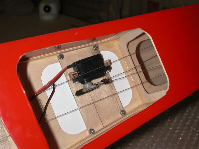

What kind of cables are those that you're using?
Old 09-15-2002 | 04:58 AM
Posts: 37
From: Lower Alabama
Default Dp Ultimate 40 First Flights
The control cable is double spun kevlar. It is
extremely strong and wont conduct emf.
You should find it or be able to order at the hobby
shop. To attach it you simlpy tie a knot and apply
thin CA. The shrink wrap simply hides the knots.

I see you used clevis on both ends...what brand pull-pull clevis/eye worked well here? I looked at Dubro 2-56 pull-pull but the hole looked rather small on the eye and didn't seem as if I could thread 2 wires through it for the elevator servo.
Old 09-23-2002 | 09:14 PM
Posts: 37
From: Lower Alabama
The clevis assemblies that came with the kit are used
on the servo. I used Sullivan clevises/eyes for the control
horns. Adjustment is made at the servo clevis. The control
horn clevis/eye is CA'd to prevent turn out. I thought the
supplied pull pull clevises were really nice! Just not enough
of them. I am not particular to the described installation
method in the instructions. It is sound but I perfer to make
adjustments at the servo in order to keep geometry as true
as possible. I also did not like the mechanics described in the
installation of the aileron control. I think it limited throw
volume way to much.
ysman

I might have to look at the sullivans or resort to wrapping around the servo horn as shown. The hitec horn I'm using is HUGE (big red one) so shouldn't be an issue of it making it's way through it.
Question. what difference does it make if you shorten pull cable at servo arm or control horn? end result is the cable is shorter so don't see why that matters?
As far as aileron the only thing I changed was not using 5/16" out from the center of the servo. I used a hole a bit further out to get more throw and changed aileron interconnect rods to 4-40 as many did here.

It is not completely a matter of tension adjustment.
It is more a matter of how strait the cable is when it exits
the fuselage. Being the exit holes for the cable are closer
to the control horn, it is reasonable to control the amount
of deflection at the servo horn. Most modelers like to take
advantage of full mechanical throw volumes and servo
travel volume in order to set a greater envelope of
control conditions. Also, crossing the rudder cable in the fuse
allowed me to have near perfect alignment to the rudder
horns. The elevator servo mod made also near perfect
alignment .
ysman

I did the "YSMAN" mod on the elevator. Took some extra time but at least I know the geometry is correct and I just cut holes in the covering to get a straight path as the path was not in direct line with the hardwood on the fuse in front of the stab. I just did the rudder but noted the alignment was probably not perfect so I'll just turn my control horn around 180 degrees and see if that helps get it straighter.

So about the Kevlar Pull-Pull on the rudder. Crossing them is a really good idea to get the run as straight as possible. Are you worried about the two "Kevlar Strings" rubbing against each other where they cross?? (it looks like they're running out in the open) Just like anything else, I'd think the friction from them rubbing against each other would weaken them. Being it is only the rudder, you'ld probably not loose the plane if you lost control of that surface....So i guess it's not ultra-critical.
