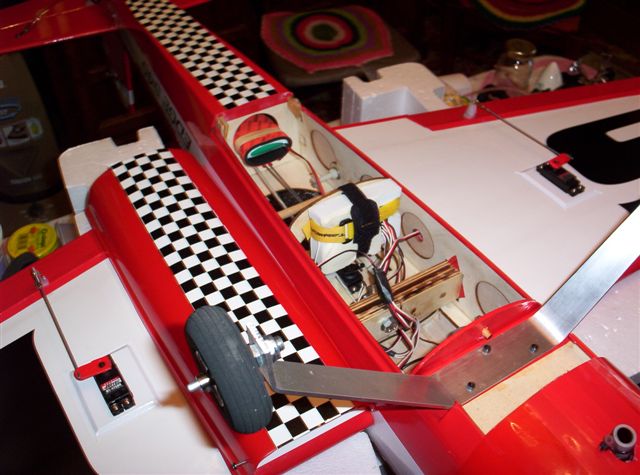

Hello VF fans. I can't blame the weather on not posting lately,,,, just busy building computers .
My elec prop adaptor idea didn't work out too well. At first it did. But on the 3rd time removing the wings the threaded shaft spun the epoxy and I couldn't get the nut undone. Billy,, a friend ,,,stopped by and basically drilled a hole through it and with brute muscle snapped it in half for me so I could remove the wing half. Back to the drawing board.
I tapped some 1/4" nylon bolts with adjustment nuts into the wings and all is well now. Gotta experiment you know. Sometimes it works and sometimes it fails.
Anyway,,, my Edge is complete except for an engine. I can't force myself to rob Peter to fly Paul. (OS91-FX in GiantScaleModels Spitfire) So I'm going with a Saito-100.
My VF came with all the latest modifications like the taller landing gear and the new idea for mounting the belly pan. Seems to work fine . We'll see once I'm wide open headed into the wind. LOL ,, My buddies love to run out and catch falling parts from my make-shift airplanes. hehehe
I went with the Sullivan tail bracing. I used the Kevlar and painted the wires with black Monokote brand paint. The tailwheel kit is made by Kleet. I used axles instead of the supplied bolts. And although I haven't installed them yet... (never do until after maiden flight) ,,,, the wheel pants are from a .46 U-Can-Do. I had a couple of pair laying around. They are a perfect match in size and color.
Using a Du-Bro 14oz fuel tank with the protruding lower front to protect the fuel tubing from pinching.
Used extra large CA hinges installed the long way to cover more gap area. Besides there is only a half inch of wood along the trailing edge of the main wing to glue into anyway. I can pick my Edge up by the control surfaces and shake it as hard as I want without slippage. The pic of the tail section shows how wide these CA hinges are .
The RX is a Futaba 8-channel PCM1024 with a 1800mah Nimh pack. My TX is a Futaba T7CAP.
I used Hitech HS425BB servos for the ailerons. A Futaba digital servo for the elevator. And a Hitech Hi-torque digital for the rudder.
The throttle servo is a HiTech HS81 .
Last but not least I stole RCFury's bottom wing decal idea. Well,,,, at least I changed the wording a little. Right Fury ? lol
Can't wait to fly this bird.

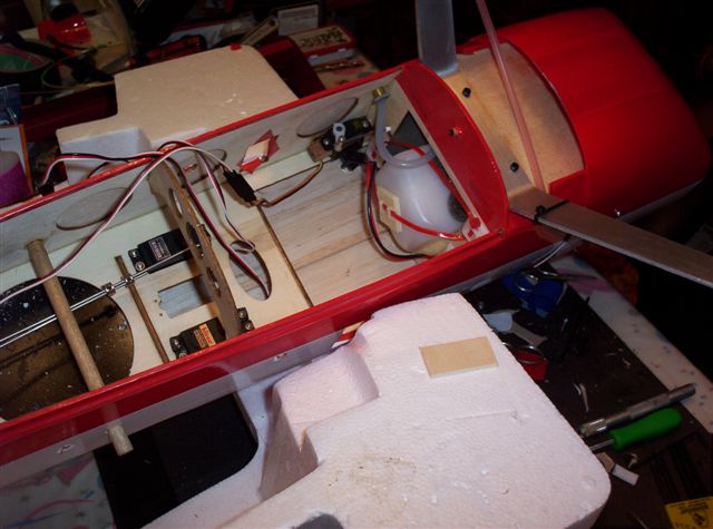

Just thought I'd post some pics of where I'm at now on the Edge build.
Thanks to many who have posted on this thread . It really helps having all the pics and certain text saved to my computer for reference material. For instance the throttle servo placement. Or the wing halves bolts.
I got the engine, fuel filler and remote glow starter mounted yesterday. I also screwed up and put the fuel dot on the bottom and the remote on the top. I'll have a bit of overflow from the tube when fueling now,,, but I can live with it.
My good friend Billy came over last night and did the cowl for me. He did a good job . I trust his skill with a dremel better than mine. LOL. I tend to get holes bigger than they need to be sometimes. (VISIT GRAND CANYON NATIONAL PARK)
I am picking up a muffler elbow connector today so I don't have to put a big hole in the side of the cowl. After that it's just a few little decals,,, a bigger spinner,,,,,CG'ing to find rx and battery placement and run the rx antenna tube.

Sturtz, I like the way you braced your fuel tank....very clever! [8D] I just used a piece of balsa to keep mine in there.

The used Saito-100 I bought from a guy in Texas started the second I touched the starter to the spinner. Lucky me.
Had to go back in and adjust the throttle rod guide a bit but it's smooth now.
Strapped the RX to the main belly former and put the wings on. I CG'd it at 4-3/8 inch with a GreatPlanes CG machine.
With the battery in the rear fuse opening it cg'd perfect. It will be heaviest at the nose with fuel added. Just right for cutting through the Okla wind.
All that's left is to figure out how to secure the battery. Install the switch/charge jack. Do a final lining up of the control surfaces and recheck the throws. And last but not least ,, a good solid range check. Oh yea,,, put the rest of the decals on and do an after-build cleaning .
I will have to cg it again when I install the wheel pants. But I like to maiden a plane without them on just in case of a grass landing during deadstick, etc. Another reason I often leave them off is because I fly at a few fields out of town that are ,,,let's say,,, anything but smooth grass runways. Let's even go as far as saying ,,,, gopher holes and small cedar trees. But my main field is very nice , with a paved runway 255ft x 27ft lined up at a perfect 360 to 180 degrees. A nice large apron and plenty of room in the pits. It also features a shallow lake within walking distance that's perfect for float planes.
The photo of our field was taken by satelite. The ground shot is looking across the apron to the pits. That's my GSP Spitfire in the shot.
More to come as I near maiden flight time.
BLUE SKIES !!!

Well,,, it's finished. got the battery, decals and canopy installed the way I wanted and took some photos.
It's on charge now waiting it's maiden flight. Been a long build compared to some other ARFs I've had. But it was all worth it .
Learned several new tricks building this one. And I think it advanced me in my modeling and my think for yourself outlook on ARFs and kits.
