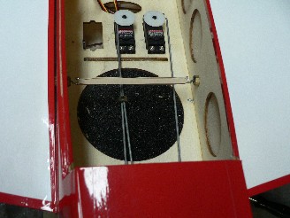

Here's some photos of the "Seagull Edge 540 wheel pants. Also, I included some shots of the wing TE hold down modification using #64 rubber bands for those builders who may now be familar with this method.

The wheel pants look good. I see you went the same way I am with the spinner, white.
I'll try and post a pic or two of the pants I have. I put a small piece of wood on the inside and want to get some CA to put around the screw holes before I mount them.

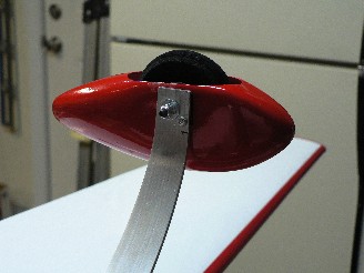

Here are a couple of pics of my wheel pants. I decided not to paint them, for now.
I'm going to cut my cowl tonight and put on the tail wires in the morning. I just need to drill the holes for the wires.

Salty, your plane is comming along great!!! is that the 91fx? Im sure that will really make the plane sing. Have you thought up a way to mount your antenna? If i might add I tryed routing the wire inside the fuse to the back but, for some reason ive been getting a little bit of glitching at some distances. I then basicly routed the antenna on the outside on the bottom of the fuse and havn't had any problems. I took some of the extra covering VF provided and taped it to the bottom. It does get quite messy with a lot of flying but the covering is pretty tollerant with the oil mess.
I can add pics if needed.

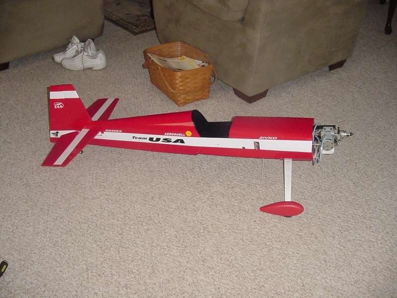

Here is one more pic I took.
When the plane was sitting on the table I thought the wing looked like it had dihedral so I took out my trusty ruler. There is a 1/4 inch difference from the root to the wing tip. [:@] I may be able to get this out with redrilling the wing bolt holes.
Is it worth the trouble I should I just go for it?

Mine had a tad bit of dihedral in also. Maybe it was designed that way. Personally i would just fly the thing. When i flew my plane its very true in whatever direction ive point the thing.
then again i can be a little picky even on the smallest of things. Fly the plane if i feel you want to take the time and take it out (i wouldn't) go ahead.

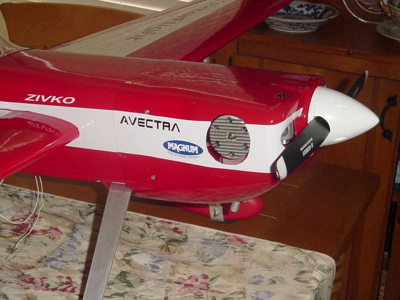

The pan came in last Thur but I wasn't able to put it on until Sat morning. I think it looks great.
I got my pilot installed and it's all ready to go fly. I may try to take it tomorrow or Thur. If I can't either of those for some reason I'll go on Sat for sure.
Here are a couple of pics for ya.
