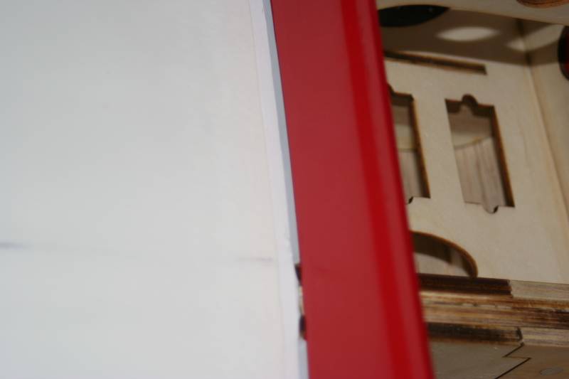

What do you guys think about the gap on the bottom of these wings? It is in the center section of the wing. I like how Chuck always me tell it is very easy.
[8D]
Let me know what you guys think.
[8D]
