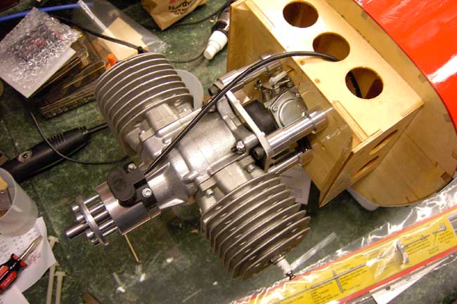

In regards to soft mounting the BME 50, I spoke with Keith of BME and he said it is best to hard mount their engine or any gas engine. You guys were right! He said at running RPM (3500 to 4000) the gas engine will vibrate more and tear up the rubber mounts in no time. He gave me a work around for the Du-Bro soft mounts because I had already drilled the firebox to accept this engine mount. Cut the rubber bushing flush with the mount and cut the aluminum bushing to fit. This will change the mount from a soft to a hard mount. (See picture) He recommends using the Hanger 9 hard aluminum engine mounts and they are a lot less expensive. ($9.00 vs $32.00) Thanks for the heads up on that one.
Is this mounting strong enough or am I missing something? The aluminum standoffs are 1 1/2" long. This is needed in order to get the necessary 7 inches Great Planes calls for. It looks and I might be wrong but the engine stands off the firewall quite a bit. Was this fuselage designed correctly or is it 2 inches too short?

RCGuy,
You should be fine, look at mine. It's 2-1/16 inches off the firewall.
Andy

Soft mounts on any of these small singles - is a no no -
The problem is not so much the inherant out of balance of a bigger single - but-- is simply the kick of each firing and the reaction.
Th twins the same size - if they have the same powe - will also kick -as either engine fires ONCE each rev - ( the twin fires both cyls at the same time.)
The engine ignition system used on a lot of singles - has a retard which softens the blow at lower rpms but if anybody has a mount which is very light and eliminates this power pulse - I would like to see it - (I have seen the ones currently on the market and the European shock absorber ones plus others )
Bottom line - mount solidly - to a solid front end on the model -make sure the fuselage does not flex - use a stiff , balanced prop and go fly -

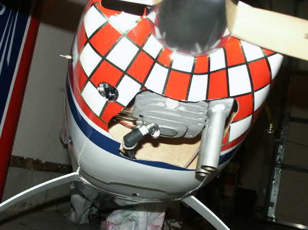

Close to cutting and installing the cowl. Anybody have have any pictures of the WP 300 with BME 50 and cowl installed. Looks like I'll have cut the cowl to make room for the spark plug and Bosch cap.

For the people that were interested in how I cut the cowl for the bme 50. It is hard to tellfrom the pic but the fins do stick out past the cowl about a 1/3 the depth of the motor. The hole looks bigger than it really is from the angle of the pic

Thanks Smallfly, you don't know how much time you just saved me. With the red and white squares, it is like having a road map on where to exactly cut the cowling. Is your BME engine out the required 7 inches from the firebox? I think I read in a past post that your engine is only 6 1/2 inches. Was that you or someone else? Regards, Russ

smallfly Thank you very much! I always get nervous dremeling cowls and always end up doing too much. Now I know I will not mess up this work of art.
