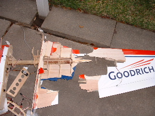

Loved the plane untill about 4 hrs ago at idle in the down line ( 45 deg) rolling to upright right wing separated from aircraft with spar intact what will GP say?
PS. screw the plane what about my motor?

flyn - that is HORRIBLE !!! We need more details....engine size, whether or not you 3D, all up weight, and what YOUR post-mortem has told you....From the pic, it looks like stress fracture of the outer skin caused by failure of the upper and lower spar/longerons....what did you find?
God Help Us!

Sorry about your loss..... Please give us more info....
