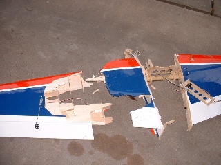

The aircraft had less than 20 flights all which we wonderfull exept for this one. And yes it is very evedent that the wing blew apart in the air.
I spoke with Lisa today and She said to send the wreckage in and they would replace it ( HOPEFULLY )

Flyn - I know you're probably tired of the requests...but there's lots of us who would like to know...
The photos don't show much in the way of spar longerons. Were there any? What condition?
Looks almost like a fracture could have started from the aileron inboard cutout. What's your thought?
As you examined the mess....was it structural, or adhesive related? Do you have any idea?
Is there no aft spar where the aileron leading edge joins the wing?
Were there any symptoms of any structural stuff during assembly? Did anything feel weird??

It does seem to be structural and not adhesive related, to answer the question about how the wing is built it looks to be in the same manner of a 40-60 size wing with no extra longerons or webbing. The spars seem to be made of 1/4 x 3/8 stock. I have never built a large scale aircraft before so I honestly can't compare it with another wing of this size. This is actualy my first 1/4 scale aircraft comming from 60 size birds. I heard that the bigger they are the easier to learn 3D. I love the way the aircraft flies, it tracked well and was easy to handle the plane had a Sachs 3.7 With electronic ignition swinging a 22x10 prop. All up weight was 17.25 lbs. with 30# of thrust.This motor is a bit heavy for the plane but,it is still in the recommended range. I do believe that the wing is a little under built for the motors recommended.
(BT-50 Weighing about 2or 3 oz less than a G 62 ) but I also believe that my Failure was a freak thing.I hope to hear good news from GreatPlanes about the mess. And I hope to hear from you guys on my quest to learn 3D. BTW I'm not giving up.

Flyn, what were the wing spars made of-- balsa, spruce or some other material. Hanger 9 had a problem with the Edge 540 a few years back with its wing. Seems the wing spars were only balsa stock and broke apart in the air. Hanger 9 replaced many planes because of that mistake in production. I hope our PW300s have more than a balsa spar in the wing.

I had a similar problem yesterday. The wings did not sit flush with both sides of fuse, was like the wing tube was too long, then of course the wings were stuck on! Well after 35 minutes of "gently" twisting and pulling the wings finally came off. A closer inspection revealed that the sheeting was cracked a both wing tips, not to mention the dings and bruises encountered during the 35 minute extraction process. If this keeps happening there will be no wings!

hey, i know what happens when there are no more wings (right wing anyways) It aint nothin nice 17# comes out of the sky like a hunk of s!#t. Very ugly. Inspecting the motor closer just happy to see no more than the linkage is damaged.
