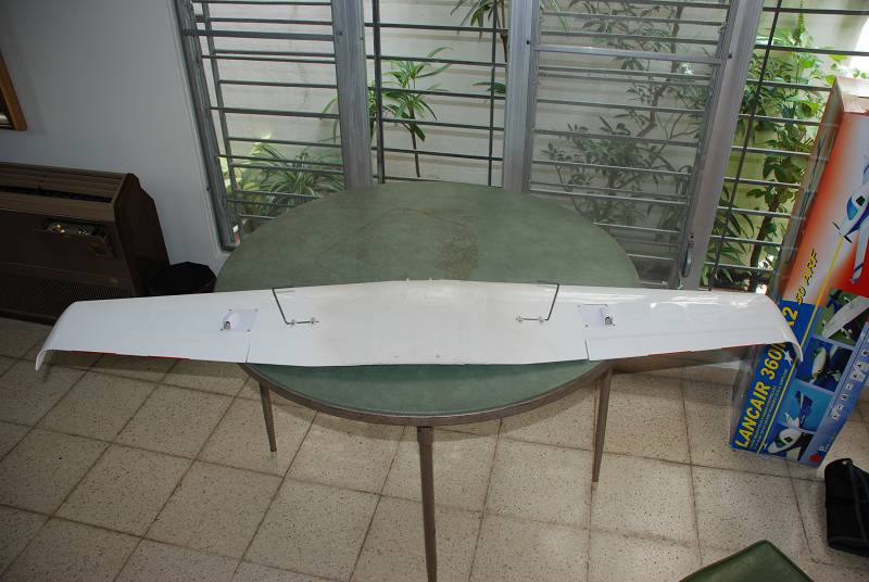

After reading all the horror posts on the CMPRO lancair, I decided to increase the wingspan 9" to tame the horrible tip stall tendency. I added a 9" section in the center of the wing made out of high density foam, covered with 1/16 balsa and a 9" longer aluminum tube. Also had to modify the main landing gear so it won`t be 9" wider apart. Will post pictures nexts week and send a test fly report after the first flight. It is such a beautiful aircraft that it deserves the extra effort.

Finished mine last night, made the following modifications, Added a 7.5" to the wing at the center (will post pictures monday) made new main landing gear so they wouldn`t be set too far apart. weight is 6.25 pounds. Dialed inn the following throws elevator 8 mm up and down, 16 mm total, ailerons 0.5" up an down 1" total, ruder .75" left and right, 1.5" total. cg, set at .72mm from leading edge at the root.
I have a friend that built one without mods, and it flies beautifully, just lands a little hot. Very importat to set the cg. at 72mm and keep the throws in the elevator below 10mm in each direction, if you dial inn too much throw, it will snap when you give it full elevator. I am shure that is what happened to all the people that have crashed it.
Will post pictures of construction and set up monday, also a first flight report.

My son did the first and second flights, had problesms with the engine overheating (new OS .46 that only had burned one tank of fuel). It flies like the unmodified one, only that it can slow down much more for for landings and the glide ratio is shallower. itl does tip stall if it slows down too much. Atached some pictures of my Lancair with the mods (the one with the black stripes at the wing root.
Old 07-23-2007 | 10:23 AM
  #174
Joined: Jun 2004
Posts: 159
From: Panama, PANAMA
Default RE: CMPro Lancair
UUPS no pictures, will send only one at a time.

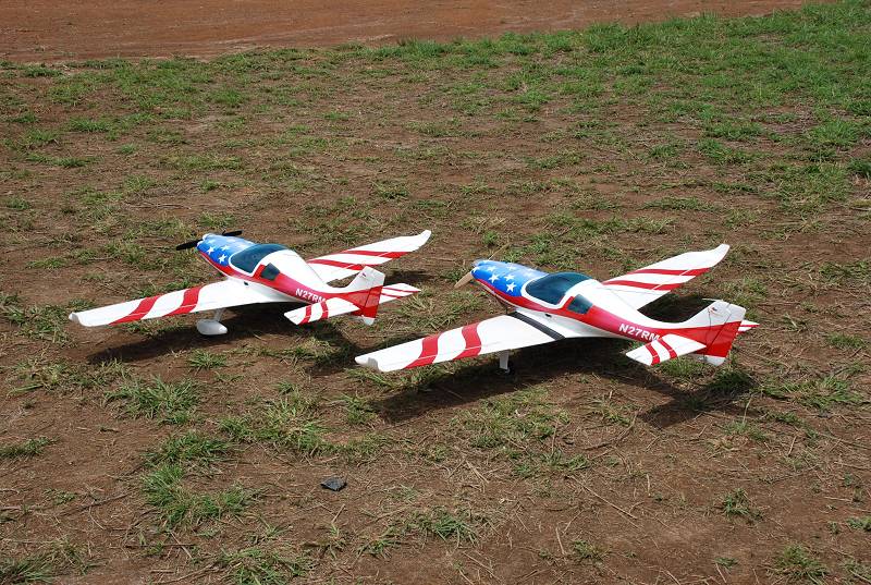

Old 07-23-2007 | 10:26 AM
  #175
Joined: Jun 2004
Posts: 159
LANCAIRS
