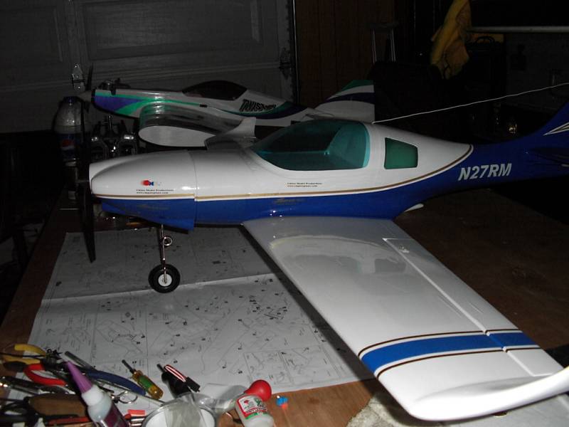

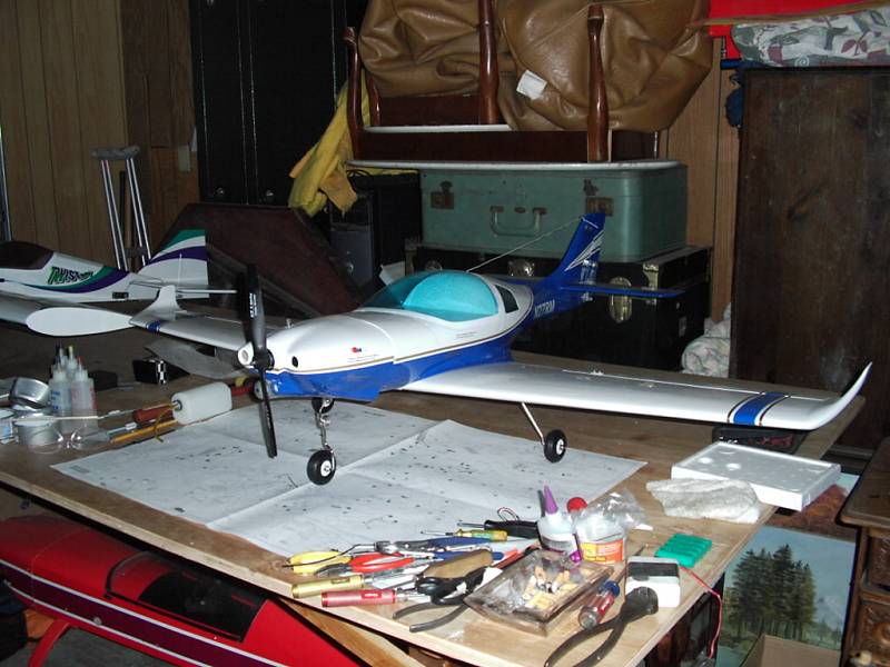

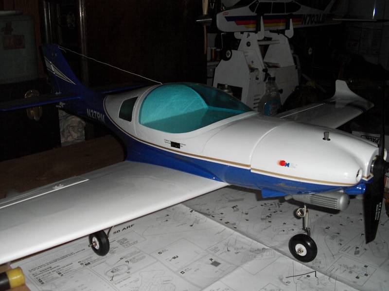

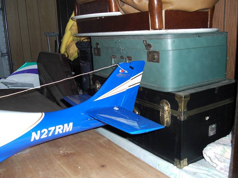

Well heres some pics of how she sits at the moment. still have a little more to do to it before she is flyable. want to make sure i get the cg correct and throws on the elevator Ect. Looks like its gonna be a little bit of a winter project. Wheather has turned bad here raining and the flight field is muddy and nasty went and checked it out today. still have some parts and supplies to get for it .
Could rob stuff from my other planes but that just wouldnt be right and it can wait a little longer. I will have to tune the engine again cant fit the cowl on without removing the high speed needle completely. I'm hoping the mistake on the rudder doesn't have a large effect to the planes flight charteristics. Never used the plastic slide in hinges that use super glue before and was in a hurry to much i think. It may be visable in the pics.
Seems that not to many people are intrested in this plane or its not very popular for some reason, very strange considering its a great looking plane. And it hasnt beeen to difficult to assemble so far i mean i'm not an expert builder buy any means and have managed to get this far without to much trouble.
Been flying the twist 40 to get more experience with low wing airplanes and flying my extra 330L but both are a completely different desighn then the lancair. But i will post my result of the maiden when i get to that point. I'm hoping i will have Someone to video tape it. Since it will be its first flight and may be its last would be nice to have it on video. Have to see how that goes.
But it looks like a Lancair didnt put the cowlings on the landing gear cause the runnway i ususally use is a dirt road out side of town.

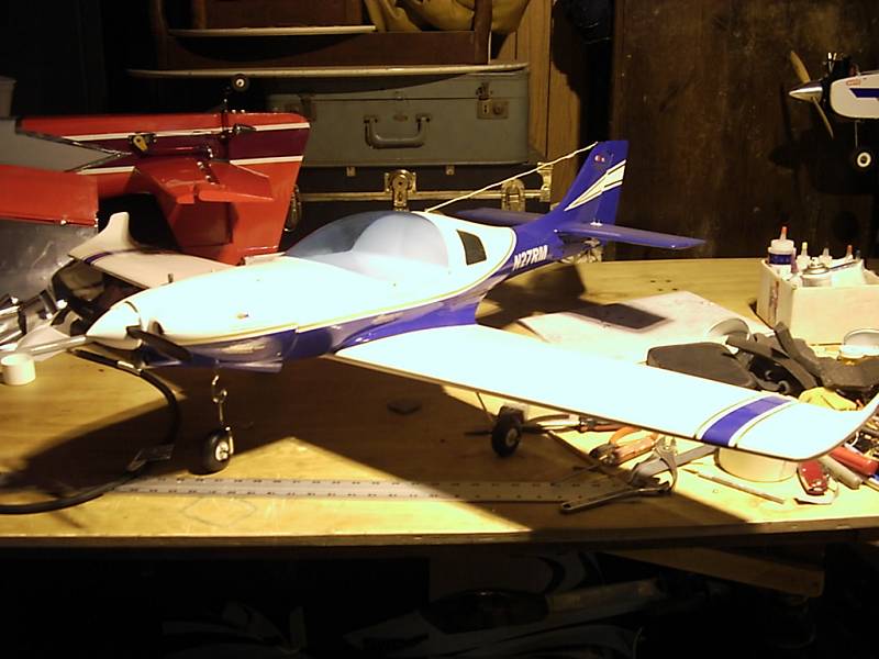

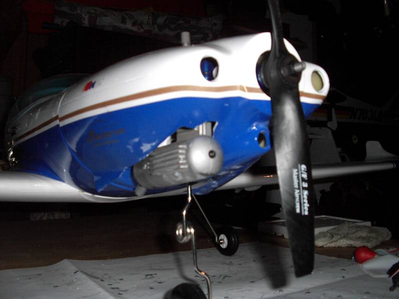

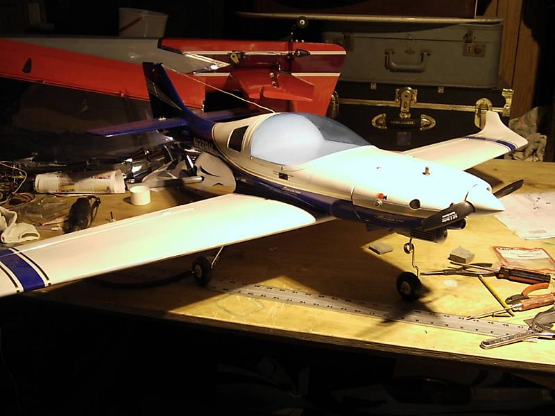

Well it is finally Done Yea I started and ran it have to just check CG wondering if anyone else has had issues with the way the wing is mounted on there Lancair mine has 2 bolts that go through the wing. I have one holding it and need to figure out something with the other one. Has anyone else made modifications to the way the wing bolts on? If so some pics of the moddified mounting would be nice to see i dont like the way the wing mounts.
That the bolt issue and the cg and making sure my flight surfaces are correct and i'm ready to take it up in the air. and the .46 LA seems to have plenty of pulling power. on the ground when i ran it up. Just need a nice day to go and maiden it.

Secondly, anything but the slightest use of elevator caused the plane to snap roll! The elevator is set at 7mm up, 8mm down – with lots of exponential. COG is slightly ahead of the recommended forward position of 72mm.
The landing was fast but successful.
We moved the COG forward slightly but his second flight exhibited the same behaviours as the first, plus this time the plane attempted to roll on take-off and on landing it crashed the last metre to the ground. More damage!
We notice that the horizontal stab has 4mm of anhedral on each side. Is this normal and/or OK? Or could this be the cause of the snap rolling?
Also, the plane seemed to fly with its tail sitting low even after moving the COG forward slightly.
I note that some in this forum have great success with their Lancairs, yet others seem to have problems (particularly with use of elevator). Why such a vast difference? Is this plane actually an unstable design?
I would appreciate any suggestion/assistance that members can offer – before I commit it to the skies again.

I fly mine at 72 mm cg and that seems just right,dont think it should be more forward.
this plane needs lots of speed,it seems more stable the faster you fly it.
I had a 46 in mine and have pulled it to replace it with a 55 ax.
You say that you have plenty of expo on the elevators,mine are set at 50 % and she is still touchy. I think you should try flying with the cowl on the plane has a very short fuse and with such touchy elevators they could be in the turbulance caused by cowling being removed.You have a very wide front end on a short plane now,i might not be right but i would not fly mine without the cowl.
Also the extra drag is going to kill your airspeed and thats what this plane needs,i am sure mine will be a hoot with the 55 in.
Just the fact that they all take so much runway to get airborn shows the need for airspeed.
You say the plane just dropped out the sky on landing approach this also lends me to think the missing cowl is to blame as they do need a ton of speed to land but yours will bleed speed extra fast and the turbulance created by the large unclean frontal area will disturb the airflow at the high lift area around the wing root.
This plane will also develop lift over the canopy due to the shape but again in your case i think not.
Good luck,dont give up.

i agree with alo 111 flying without the cowling is killing the aerodynamics of the plane and sounds like that is alot of the problem and the COG being foward would also casue the plane to want to drop out of the sky like a rock at low speeds. The horizontal stab shouldnt have any type of dehidral of any kind up or down it should be straight across i think that would cause the plane to want to snap roll mine doesnt have that problem it flys like a jet.
And i would say that the plane should be flown like a jet fast. landings are fast but i havent had any problems with mine wanting to snap roll on use of the elevator. i have mine setup to use flaperons on landing and this has helped landing at slower speeds. but if there used it limits the aeleron control and it is best to not let the plane slow down to much and alot of elevator needs to be used with power on landing.
If the plane dead sticks it wont float to the ground it will want to stall and has to be flown in with a step descent to keep air speed up then flared hard to make a successful deadstick landing. on;y has happened to me twice so far. but i havent had any issues of the plane snap rolling did you check your center axis COG side to side such as the left side being heavier then the right side ect.
If the planes is hevy on one side that may cause it to want to snap to one side on use of the elevator this is a plane that is very sensitive to the cg being correct and all flight surfaces being correct it is not forgiving in any way.
It takes alot of runway to take off like a jet and alot to land like ajet and has to be flown fast like a jet to maintain lift and the flight surfaces dont require alot of movement.
I have no expo on mine but my flight surfaces dont move that much i think my elevator is set only at maybe 5 or 6mm up and down have to check that. But definetly fly it with the cowling on it and you will most likely notice a difference. I have flown mine 6 times so far and had 2 deadstick landings and no damage or bent landing gear as other have had i land on the rear wheels and let the front touch last.
If the plane is built corerectly and flown corectly you wont have any problems it is a great scale flying plane that has the feel of a jet in my opion.
It is the scriest plane i have ever flown due to the fact that with changing conditions during flying can cause the plane to fly differently i took mine up the last time and the winds were about 10 mph and then dropped to almost nothing calm and IMO it was alot harder to fly without the head wind. And the plane of course picked up speed. my guess is i have had mine up to at least 60 Mph or faster but i have sealed everyting there is no gaps anywere on the plane all the surfaces are smooth and i wipe it down with a spray on silicone before i fly it just to see if i can get it to go faster and seems to have made a difference in the way it flys. but i dont do any type of aerobatics with mine. i fly it like a pylon racer. usually fast and straight and wide turns.
