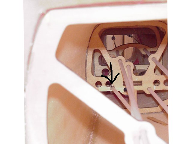

ORIGINAL: knucklebutt
O.K. gang heres the photo of the tail wheel pull pull issue. The arrow points to the tube that should have been about 3/4"further left. When the Robart tail wheel unit is installed it will totally block this tube. If you look you can see where the protruding piece has been broken off by the installation of the tail wheel unit. Blue circle indicates where the tube needs to exit. I am fixing this as we speak and will post the fix as well as tools needed (if it works)
Denis
Hi Denis,
We just dis-lodged that tube from the support and, when the pull-pull system is tightened up, the tube will "float" while protecting things from rubbing. Not much "fixing" really necessary (Unless you are from Texas...)

Here's my fix for the tail wheel issue (certainly not as simple as F-82 Fan)
1. fashioned a cutting tool out of 9/32 brass tubing sharpened at the end to drill out the pull pull tube
2. Drilled out the orginal tube and drilled out a new hole approx. 3/4" to the left
3. Pulled out the orginal tube and placed it in the new hole: plenty of room in the fuse to stick your hand up in there
4. Epoxied tube in new hole
Denis

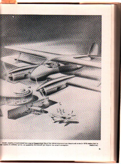

Anyone wanna attempt a conversion into this one ?? If you could pull it off it would certainly get attention
This was a proposed "Twin" Staggerwing
Denis

Maybe your F.I.L. is a little sensitive about letting a Dodge truck owner loose with his Mach 1??? LOL
Dennis,
that Twin SW drawing is gonna make me toss and turn at night with visions of how I can pull it off.
Thanks a lot!!! [:-]
Would somebody else please ask the Lord to lower the wind velocity in Houston a couple of notches??? Can the April showers and kite flying weather be over, already???
AARRRGGGHHHH..............
