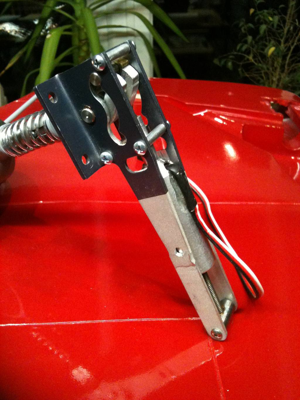

The U/C is the std from Robart,but these are being retro-fitted to electric by Down and Locked in the US
Also for you guys that have flown this model. I'm looking to install a 30cc gasser (Syssa 180HP) which a pretty power full engine. Question is: will this engine be enough? Thanks for the help guys!

I looked at the "lado" route to get the electric conversion,cost there is about $220-00............but these actuators have not been in stock for some months.Christophe who runs Lado from France gives a great service when he has the items in stock,deliver is very fast along with great communication and tracking details.I purchased a set for my H9 Corsair,look great and work very well.
Down and locked is a bit more involved for the conversion..........Lado you can do yourself ( see threads a few pages back )..........D & L,you send the Robarts back to them. Mitch at D & L,will reply to your enquiry quickly,answering any questions you may have.
Check out www.downandlocked.com
Will post some photos.........when I can work out how to do it !!!!
Cheers...........Nick (UK)

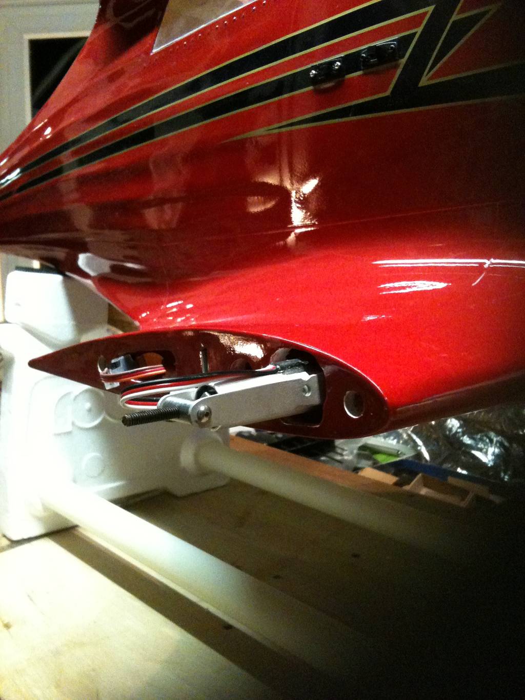

I have just finished my installation of the Down and Locked U/C conversion...............very pleased with the results.works great with a realistic speed for up and down and together with the "slowed" tail wheel retract looks the part !!!
Just a bit of work with the Dremel to give a bit more clearance for the motor/jackscrew set up,so as to allow the wires not to foul on the fibreglass,as on this conversion the motorand jackscrew travel along the retract chassis,the jack screw protruding out of the extension that was added to the Robarts.
Nick (UK)

I was an early buyer of a set of Lados (before things got bad and Christophe bought in). They're a great product, if you can get them. I looked at Down and Locked at a fly-in last spring and was really impressed with the product and the guys making it. They're doing it right. If they had been available when I was assembling my S/W, I'd have gone with them instead of Lado.

I had the Robarts on my H9 B25 converted by Down and Locked. Absolutely first rate in every respect. I'm going to have the ones for the Staggerwing converted as soon as I get around to taking them out of the airplane.
