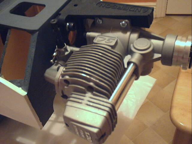

Old 02-05-2003 | 05:59 PM
  #253
wolf123's Avatar
Posts: 253
From: Castelnuovo Rangone (Modena), ITALY
Default Seagull Models Edge 540

Old 02-06-2003 | 09:37 AM
  #259
Joined: Jun 2002
Posts: 274
From: Dublin, IRELAND
Hi Ducati, why not go for a Magnum or SC 1.20fs? If as wolf says the plane has been redesigned to fit in then why not?
I thought my tailplane looked pretty hefty, maybe they beefed that up too.

Old 02-06-2003 | 03:17 PM

Old 02-09-2003 | 05:16 AM
  #266
Edd
Posts: 49
From: Ryde, AUSTRALIA

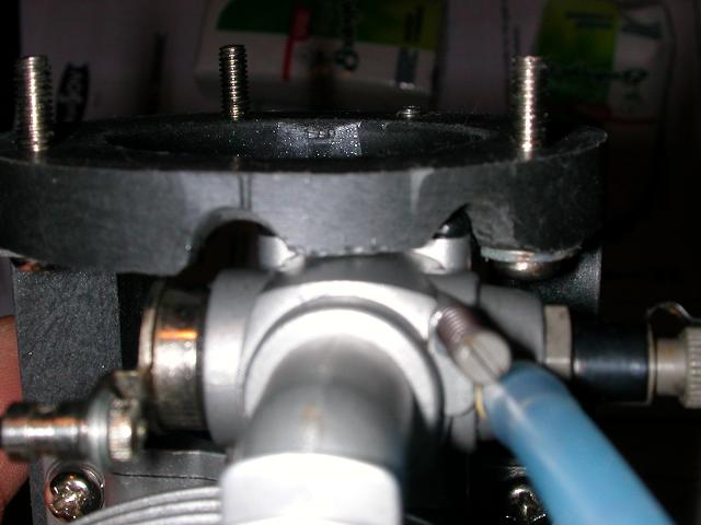

Old 02-10-2003 | 08:55 AM
  #272
Joined: Jun 2002
Posts: 274
Default and another
here's another.
I also performed the Wolf 3D mod to the tailsection but did not check the interior sizing for servos... shockme..... I might consider adding ply on the outside as well to bolster out the servos a bit instead of buying new ones.

Old 02-10-2003 | 11:29 AM
  #273
Posts: 1,687
From: tel avivna, ISRAEL
hi Gricey - use thin ply for sevo ext. please let us know your final weight . best
Old 02-10-2003 | 11:59 AM
  #274
Joined: Jun 2002
Posts: 274
I'd say the weight will be high, I'm mostly concerned with balancing the CG side to side. The engine is tall meaning that there is a lot of weight all on one side of the plane.
Will keep you all posted.
cheers
p.s. does anyone know what size spinner is best for a 15*8 - 18*6 prop? I've been told that Aluminium is best way to go for that size motor. The plastic one that came with the Edge would just about need to be cut in half by the time I've fitted it to the prop :-)
Old 02-10-2003 | 12:54 PM
  #275
wolf123's Avatar
Posts: 253
hi Gricer
i've inserted from the origianl cut a piece of plywood for the second servo . i use allumimium spinner now .
regards
