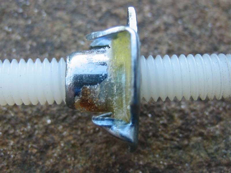

TimC: I replaced the original bolt with the spare which came with the kit - I have no idea what size they are, but they do look around 1/4." Yep, the holes line-up perfectly. My flying pal also had a 40-size Twist which has more flights than mine and his wing bolt is "as-new." As I said: I fly mine really hard, but I can't think that's the reason my bolts are wearing-out - is mine the only Twist doing this?

T.W., I'd be willing to bet a paycheck the threads are damaged in your blind nut. If you have access to a 1/4"-20 tap, try chasing the threads. I think the blind nut is shredding the threads of the wing bolt as you screw it in.
#603
You could be right, but I don't have access to a tap. Tomorrow I'll remove the blind nut and take a close look at the thread . . . . and maybe replace it with one of my spares. Thanks Tim

T.W...Although I agree it is a pain to change those bolts, I strongly recommend NOT to switch to a iron bolt to holt your wing. Reason for that is if it ever so happened that you make a landing in which you might touch the ground with your wing, the iron bolt will holt the wing attached to your fuselage, more than likely causing damage to your wing. If you use the fiber bolt, the chance that the bolt snaps upon inpact is significant, hereby more than likely avoiding (significant/minor) damage to your wing or worse.

TW I agree with TimC and Dutch,, check the threads on the blind nut first.
Don't change to the steel bolt
and another thing I noticed is your bolt looks kind of long, because of where I had to put my receiver I had to shorten the bolt a little on mine, on any plane I have, I always cut the bolt so only about 1/2 inch comes below the bottom of the nut, I have never had a problem with the bolt stripping or coming loose on the plane. I'm inclined to agree its happening when you thread it in, if the bolt is hitting anything on its way through because its to long, you will have the same problem as a bad thread in the nut.

Thanks again Guys. But no, the bolt doesn't hit anything - and the extra length of the bolt probably saved my model from coming completely apart in the air. I've always steered-away from metal wing-bolts in the past, but these days I don't mind using them whenever I need to - they "seem" safer when I'm flinging my models around in the air anyway
Over the years I've had my fair share of crashes (haven't we all) but I don't remember any where the wing-bolt let-go in the way that it's supposed to do - always it's the wood that's broken. My most recent crash-tested model was a Funtana. It did a "pancake landing" after the engine died whilst prop-hanging - too low to build-up enough speed to land properly but high enough to have got the model turned-around into a landing attitude. The arrival wiped-out the u/c and the front of the fuz right back to the middle of the wing, and again it was the 1/4" ply plate wing-bolt retainer-plate which gave-way. Some years ago I began cutting the wing-bolts about half-way through in order to make the bolt the "weak link" that it ought to be, but it made no difference, that bolt was still intact whilst the rest of the model got damaged - sometimes totalled even. So . . . . if I have a metal bolt I'll probably use it
Removing the blind nut isn't a difficult job btw - I just gently push at them with a hot soldering iron and they soon drop out (make sure that the hot nut doesn't land on an area of film though as it may burn right through! I'll remove the bolt later today and take a look at it
You may be right about the nut damaging the bolts, but they both went in there ok, and they tightened-down ok too. It was only after 15 or so flights that I discovered the thread had stripped - and I hadn't needed to remove the wing in-between-times, so something definitely happened whilst the bolt was in-place

I've now exchanged the suspect blind nut for one from my spares box, but the one I removed looks ok to me. I tried fitting a different bolt into the original nut (see pic) and it doesn't seem to bind, or to have done any damage to the thread. Bearning in mind that once I'd fitted the wing in place, the wing bolt stayed-put, as I don't remove the wings from my models between flying sessions. So I guess this means that I damaged the bolt just by flying my Twist hard . . . . and as I asked earlier: Has this happened to anyone else?

I have to say, That bolt looks just fine threaded through the nut,,
I only prefer the nylon bolt as the metal bolts seem to come loose on me, not often, but they have, they are easier to vibrate out in some cases, so I just stay with the nylon,, not that I haven't used a metal bolt in a pinch or for a few weeks, but I always replace it eventually, I don't know why,, Creature of habbit I suppose...
I'm sure a lot of flyers keep their wings on if they can, but I have lost more planes doing that because I wasn't checking the inside connections, The T_ _ _ T is a little different as the major connections are all on the outside of the plane anyway. but I loved my huge garage that enabled me to load and store my planes with the wings on them. and a van to bring them to the field in I could get 3 40 size planes in there with the wings on,,, Bad bad bad I say... I was lazy,,, luckily I have moved and now I have to take the wings off, which ensures at least 2 more flights before a crash.
The bolt breaking instead of the wing has never happened for me either, when the bolt has busted on me, it is because the wing smashed up pretty good too, so to me, if you hit hard enough to break the bolt, you hit hard enough to break the wing or plane as well, maybe it releaves some of the damage, maybe not,, but by looking at my catastrophys I don't see it,. [:-]

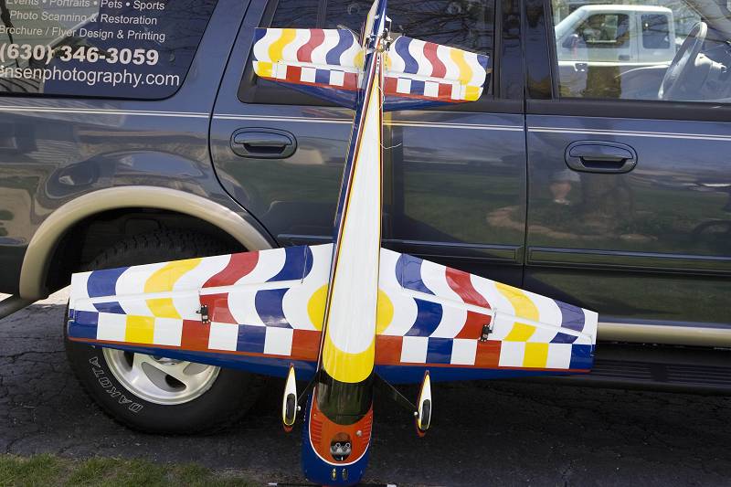

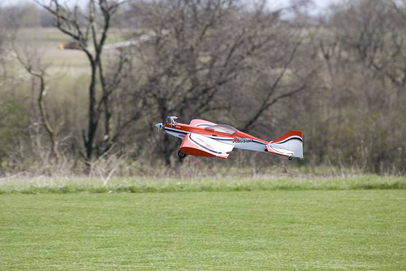

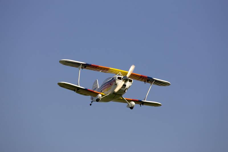

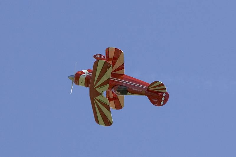

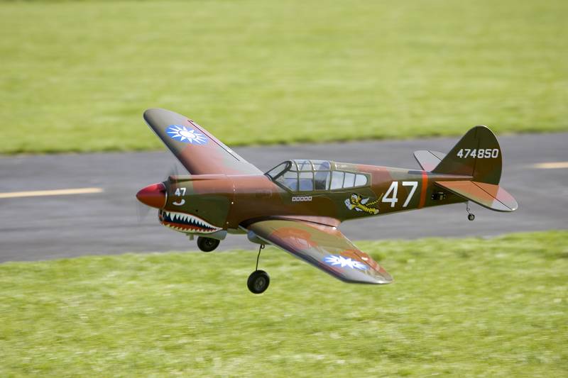

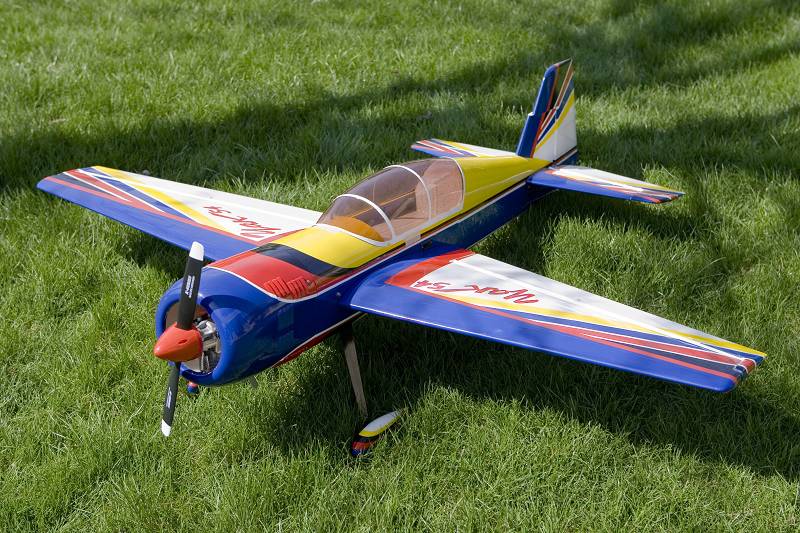

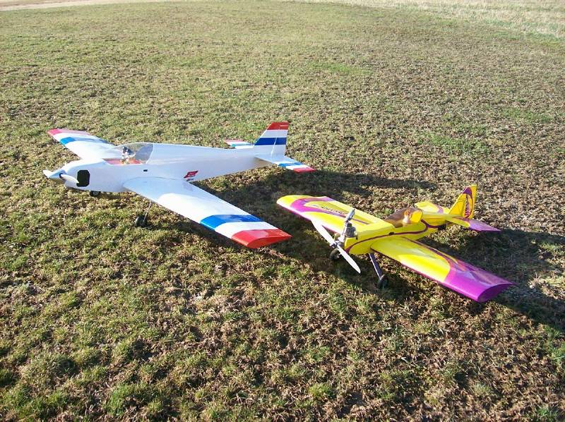

I know how much you like pictures so I figured I'd post a few from today's events. It seems there were more that a few other fellas who played hooky today. We had gorgeous weather today... Sunny, 70 degrees and a light wind right down the runway.
Thanks goodness I decided to have someone else fly my .60 for an opinion. I was having a hell of a time on a few landings, she just wouldn't point her nose down. Turns out she was quite tail heavy. I don't know if something shifted inside or what, but I had this thing's CG right at the front end of the mfr.s recommendation. Anyhow, we fixed it and she lands beautifully now. Hope you all have as good of a weekend flying as we had today!
-Jay K.

Jay...I bought my T_ _ _ T .60 2 days ago, so these pictures are beautiful to see
That 60 looks soooo incredible sharp against that blue sky man...wheww....I envy you...
..Gonna put a Saito 90 in my T _ _ _ T...I think I recall you have the same engine in your T _ _ _ T am I correct??Can you refresh my memory and let me know how you like the flight character of the .60 with your engine??..please??
