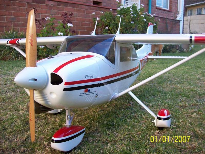

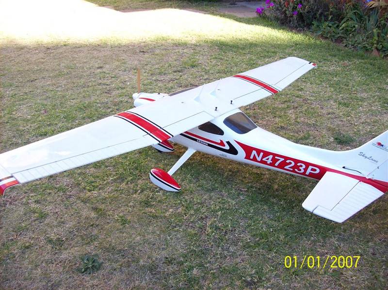

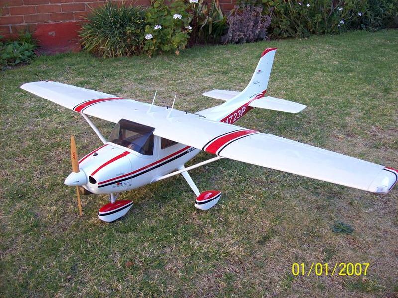

Hi guys.
Here is mine. Finished her over the weekend. My my does she need a lot of noseweight with an OS46AX ....
Also wanted to put a pitts muffler in, been looking for one everywhere and just could not find one. Found a V-MAX pitts puffler but even with that had to do some serious cowl cutting so I opted for the standar muffler. Will keep on hunting for a Bison pitts muffler and then get a new cowl.
Anyway, here are a few pictures of mine.
Marcel
Marcel
