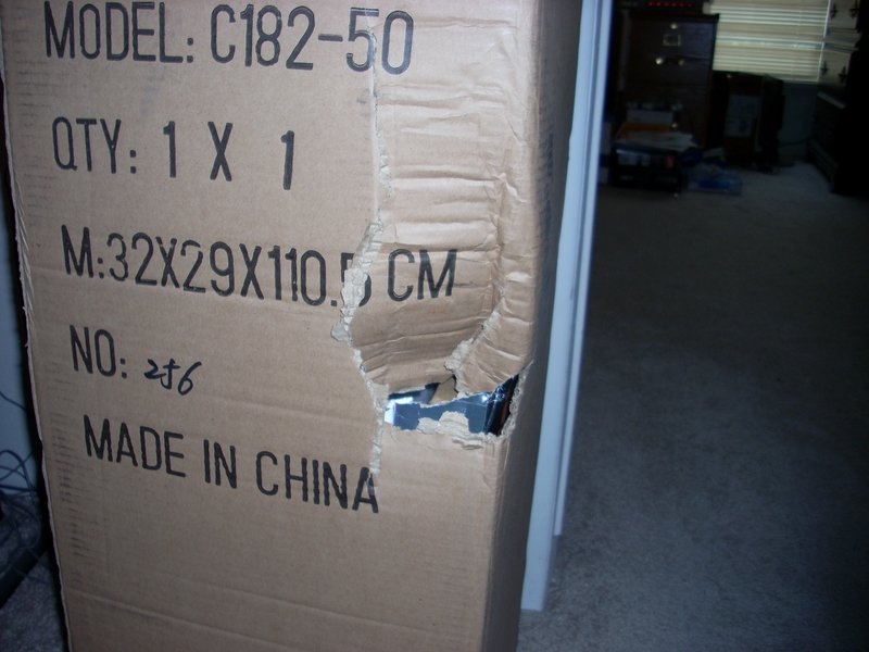

My Cessna just got here. The low life UPS driver had the damaged side of the box turned away so I couldn't see it. By the time I got it inside and noticed the gaping hole he was long gone. My heart was sunk as I opened the box. That soon turned to elation as I noticed the damage was in a void area and nothing was destroyed!
As I pulled the parts out I wanted to kick myself for not ordering two or three. One for electric, one for glow and one for display. It's absolutely gorgeous! I have tons of other projects so I'll be taking my time on this one so it is just right when completed. I'm absolutely stunned with the appearance of this plane! [sm=what_smile.gif]
