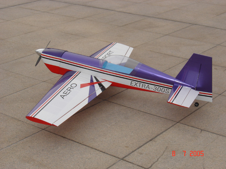

Ok guys I have the aero works extra 300s from ak models. Running a os 91 max on it. Pull pull on the rudder, 1 pushrod with two threaded steel rods running to the elevator. I am using the JR XP6102 radio that I fly my helis with to. The Ailerons have one futaba s3004 servo a piece. It is a joined one piece wing.
I just cannot get this plane to roll fast at all. Very slow roll rate. I mean snal slow. The throws are just about maxed to. I am baffled as to why it is slow. Below is what another member said to me and I was hoping someone could elaborate or explain to me what I need to do to get her to rock and roll

If you want a fast roll rate ,then 30 degrees (up and down)is probably at least what you want.If the hinge gap is too tight,you may not achieve that.Remove hinges and install new ones if that is the case.
45 ounce servos are weak.With a 91 up front at cruise, a 55 ounce servo would be minimum,Servo arms(1 inch) and solid linkages is another considerarion.Sealing the gaps as mentioned is good practice.
For sealing I have used clear scotch tape on the underside of planes up to 1/4 scale.

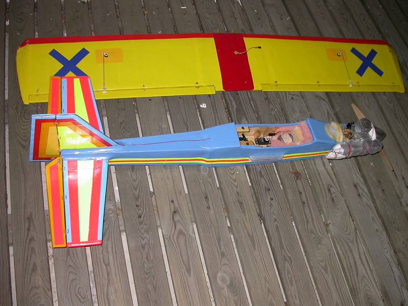

I had the same problem with similar size plane and OS.91 on it, about 4kg weight.
And servos were same Futaba 3004. The Problem is for SURE that you use ONLY one
servo for both ailerons. I have found the SOLUTION in this slow and painful(!) way:
1. I changed to 6V but not just by adding one more cell because the overvoltage then in fully
charged battery pack is 5x1.35=6.75 and that might cause problems on you radio or if in the
radio there is voltage protection that will drain your battery till gets to the 5x1.2=6V. I have
used for each servo a separate voltage regulator 7806 and 8(8x1.25=10V !) cells to make sure
that after the voltage drop over the 7806 of about 2V I will still have the dreamed 6V even when
the batteries are almost exhausted. The Improvement was very little ... the time spent - huge !
2. Then I placed for each Airleron a Separate servo 3004. The rolling improved enourmously
much. Got it like about 4-6 rolls/sec !!! Very Good enough - the Ariplane is not Rock-and-Roll
and is like "PROPELLER" itself - everybody is wandeing what kind of Digital Servo I am using...
and gets very dissapointed when see only the good old 3004 for 12$ there.
3. Then I took away the 6V system and got back to the 4 cells and number of rolls per second is
is only a bit lower, like 3-4 rolls/sec. That is maybe what you call Rock-and-Roll.
It is true that the ailerons are bending, but that is avoided to great extend if your control point
of the Aileron is about 30-40% from the outer end of the Aileron. Gap is also important, but I
did not seal it - it is even too big now, about 3 mm at least but that is something to fix on
the next airplane.
Of course the simplest solution would be to put powerful servo, but then the bending of the
Ailerons will be there to ruin the effect and then you have to firm the Ailerons which is not
very quick and easy job. While making two servos on the wing and connecting them in
parallel takes just couple hours work in total.

How slow is slow?
What is the throw in degrees?
Gap sealing will generally increase the aileron effectiveness about 15 to 20%.
I have found that the roll rate will increase as the CG inches towards the rear. The speed will also go up considerably as the CG becomes correct. However stall becomes more pronounced.
If the ailerons are reflexed the roll rate and speed will be slower.
Passive boast tabs will sometimes assist in speeding up the roll rate but is a more complicated subject.
Bill

I got hung up on this "aero works" Extra 300 from AK Models. Aero Works doesn't sell through AK Models and even if they did, they don't make a 60 size Extra. So I looked it up. For everyone's info, this is what he has.
Fellers: You are never going to get a really fast roll rate from that plane. It wasn't designed for it.

BTW, got a picture of YOUR airplane? That shows the aileron gap? Aileron gap has got to be horrible to have that much effect on roll rate.

No I do not have one servo for both ailerons. Sorry if I confused you. I have one s3004 on each aileron. that is one servo per aileron.
The roll rate is about one revolution per second.
That extra in the pic is the one I have to.

It is getting interesting here, let me trow some "Fuel on the Fire". I will post one of my oldest planes.
Below I attached a photo of an Very Old and Very Crapy Seagull Boomerang, after hundreds of crashes,
which rolls about 5-6 times per second, no kidding. The parameters are 4.5kg weight dry, engine OS.91FX,
propeller 13x7, fuel 25% castor 75% metanol and 6V battery chain as I described above.
For sure it is an ugly plane and that is why maybe it does not obey all the nice theories much...
in fact it is a "horror-movie" for the shop-keepers - it does many things which the expensive ones don't.
Maybe important think to mention is the speed, it is about 150 km/h, that has of course main effect. Surely
that crap is not for IMAC, neither for 3D, it is just for fast stunt drive and does the ROLLING FAST and in
the wings are just Futaba 3004... Surely there are many nice ideas posted above, but still I believe also
what I see when I turn the sticks ... and on top of every thing it is Upper-Wing plane ...
Cheers,
Nick
