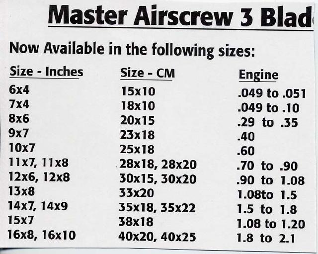

A 12 X 8 3-blade should be fairly equivalent to a 13 X 8 or 14 X 6 2-blade prop. Any of the three should be a good match to your Magnum 91 4-stroke as long as you've enough ground clearance and the 3-blade just looks good on the T-28.

I tried a 14 x 6 two blade against a 12 x 8 three blade MAS prop on the bench. They ran within 50 rpm's of each other. They may run different rpm's at wide open throttle with the plane flying in the air though. Don't know.

Outstanding information Balsa. I just got a few 3 blades for $3 a piece at a swap meet and right now I can't remember if they are 12 or 13's. My question though is what about the two strokes. I have a Magnum 91 2 stroke.

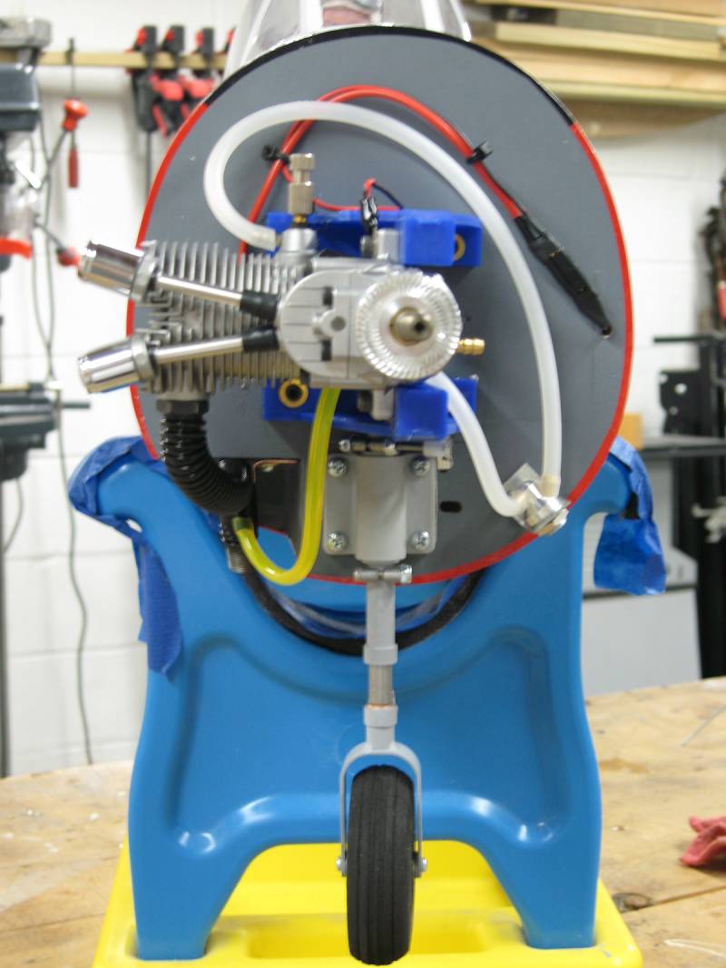

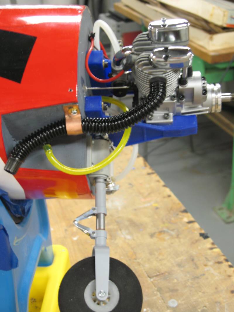

Finally finished my T-28 today!!! I was waiting almost two weeks for the straight exhaust manifold (the coupler between the engine and the muffler) for my Saito 82. It never came and I might have got screwed by an online dealer, so today I went to Corvallis, about 50 miles from Salem, to a hobby shop there that had the part...I had called them to confirm yesterday. Brought it home and had to cut off about 3/8" from its overall 1.5" length. That makes the stock muffler fit inside the cowl. So here is a pic of the business end of my T-28. The needle valve extension is visible, and is not as close to the nose gear as it looks. They are about 3/4" apart. The stock muffler is completely inside the cowl and what you see is the rubber exhaust deflector connected to it. Might need a larger exhaust hole by the nose gear if I have any overheating problems. Looking forward to trying this baby out as soon as the weather permits here! Jon
#611
maukaonyx, the plane looks great. I really like what you did to the cowling and the exhaust. the biggest thing i found was making sure the air gets pulled over the head. It looks like it will be pretty close with the baffle and the hole where the extention is at plus the hole around the landing gear. Also your head is exposed where my 2 stroke is completely enclosed minus the pitts muffler exhaust tubes.
