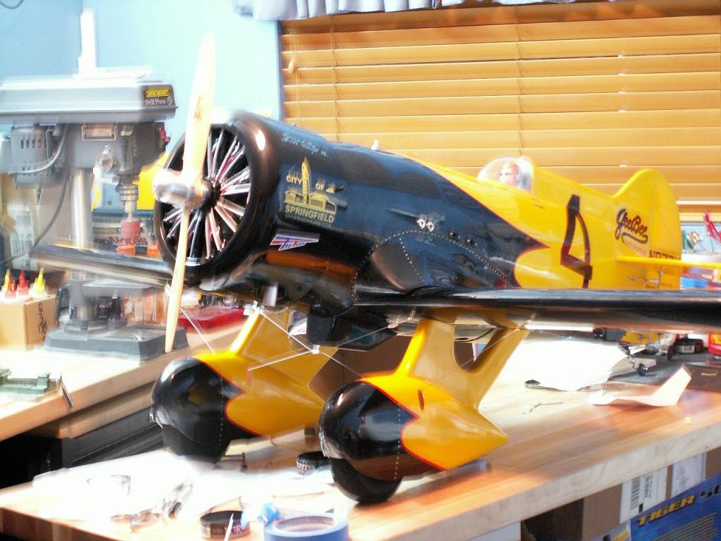

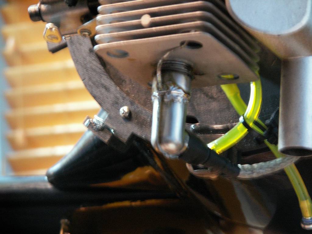

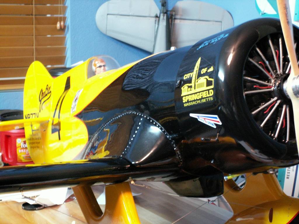

You are going to kick yourself if you don't get a gasser for the plane. The extra dollars spent on the gas engine will be recouped several times over in the money you spend on nitro. Not to mention the weight you'll have to place in the nose.

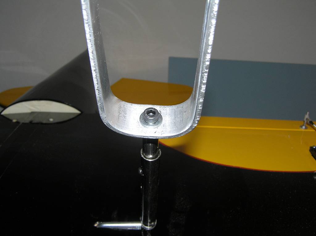

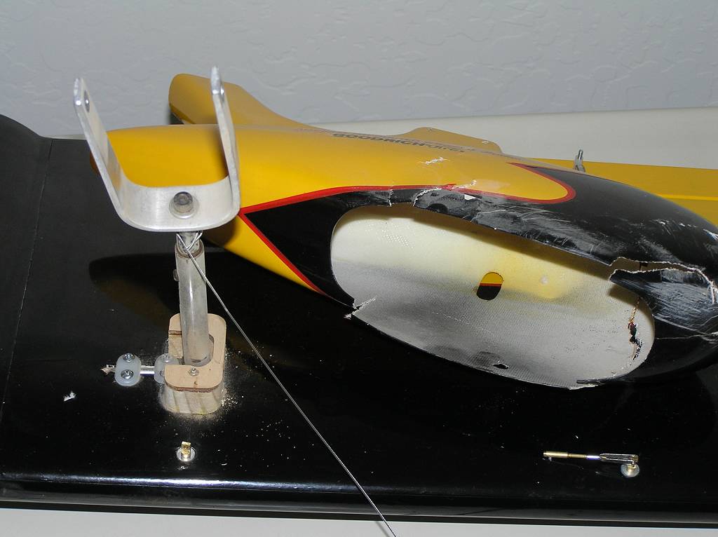

The basic problem is that you have a "U" shaped item sitting on one bolt that is supposed to hold its position - going to take a LOT of glue/solder/whatever to stop the torque of a wheel twisting a bit on anything less than a perfect landing....
