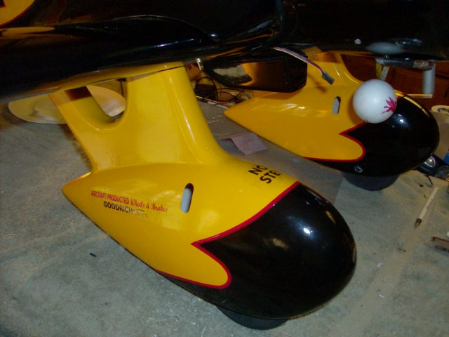

Hi Steff, I will probably stay with the stock gear set up, but will modify it (try to keep the forks from turning) and use narrower wheels, and open up the wheel pants at the sides and rear. I have had very good luck with my pac aero Y with the pants opened up. On landing, I also tend to come in low and keep my idle high and then cut the throttle when the wheels touch down. I have a gyro on the rudder and that seems to help keep the roll out straight..... Works for me! I have a 1/4 scale Fokker DVIII and at 19 lbs, one has to fly it in and wheel land it well above stall speed also. This thread is a good one with lots of great info available. Duane

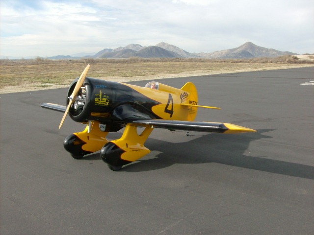

Well, today was the maiden flight, after a few aborted attempts, as we have been having some windy conditions here in So Cal these past few days. All I can say is Wow!!! Low high speed passes down the outside of the runway looked so cool. Radio is a Futaba 6chnl 2.4, and a gyro on the rudder. Gee Bee needed only a couple clicks of left aileron trim, and a few clicks of up elevator, as I was flying it at about 1/4 throttle. (later flights at higher throttle settings, took the up trim out.) Landings were picture book touch downs, even the second one which was dead stick, as I had the throttle trim too low and motor died. Narrow tires and plenty of pant clearance around them, seemed to work great. Loops, rolls, split S, great. What I thought was going to be a tiger by the tail turned out to be a ***** cat! Lets see, 30cc turnigy motor, 17/8 prop. 7800 rpm on the ground. Airplane weighs 11 3/4 lbs, with ignition and battery pack up front on the shelf over the motor. Flight battery at the rear end of the servo tray. CG is slightly foreward. Nice model, what a gas!

Congrats on the first flights, good to see some one else having a good experience with the Z.
She does look a treat on the low passes & as has been mentioned in this thread a few times a bit of an attention getter.

Hi Racj, good luck with your R2 project, sounds like you have a good plan. As with the Z, keeping the wheels from snagging on the pants is important. I think trying to keep the weight of the heavy stuff low in the fuse may help also. I got my tires from hobby king they are hard foam and 4 1/2 inches in dia., 3/4in wide, $3 each, I think! I have about 1/2in clear at the front and sides and about 2in at the back from the pants. The oleo struts seem to be doing their job so far. Bringing the plane in low and touching down gently is the key to good landings with this plane. So far I have not noticed any tip stalling tendencies at all. I did twist up the wing tips and heat up the covering on the wings to shrink it and hold in some wash out, I think this helps also. Duane Edit/wrong tire size! sorry!

THANKS for the pics and wheel sizes. I'll definitely use this when I get to the GB Z. If R2 lands good with no pants on I'll trim for clearance like this when I add the pants.I suspect wheels locking up on these big pants is main issue on the R2. THANKS,RACJ
