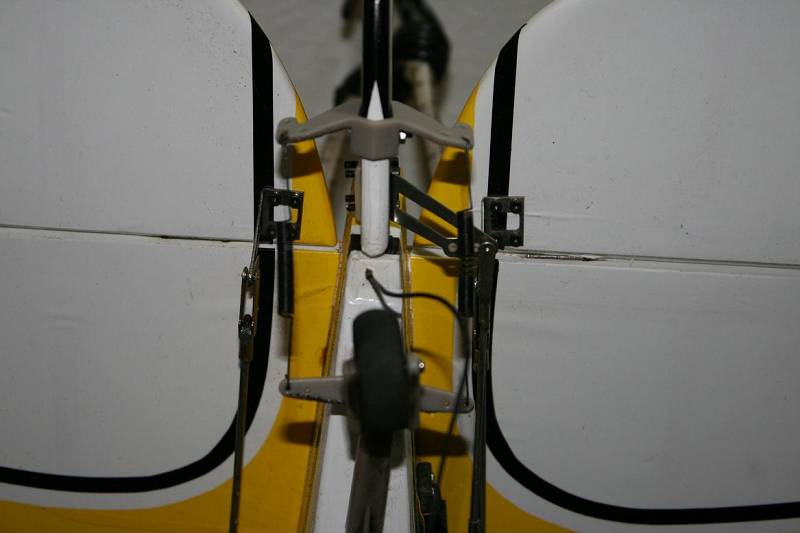

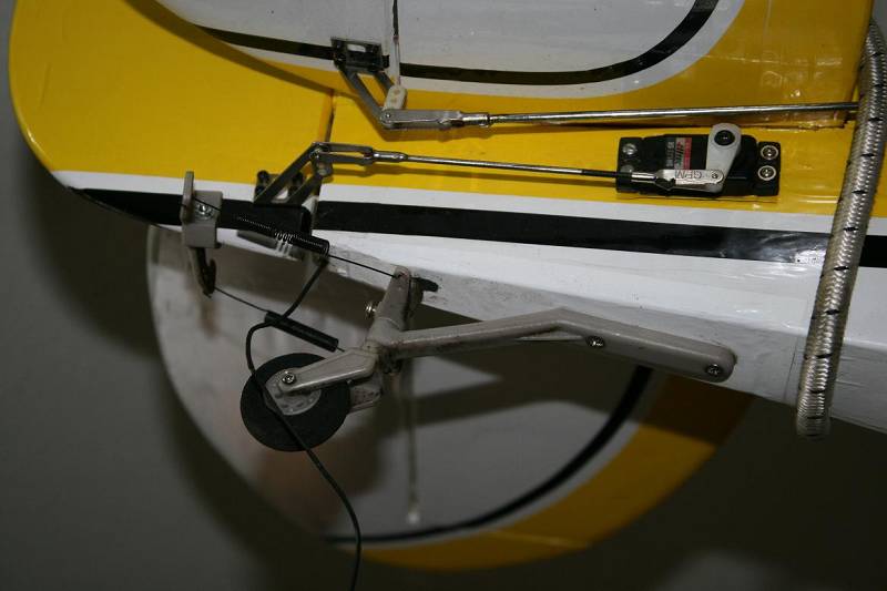

If you are going to se the canopy screws to hold the two wings spar bolts together you will need to get longer M3 screws.
I found that the tail gear set up is crap [:@], after each landing the wheel would turn all the way so I would have to go out and
reposition the tail wheel, I think if you change that wheel collar that secures the wire to the tail bracket it should hold.

Here a is a pic of the tail set up, this was installed wrong, the triangle pasltic part goes on the leading edge of the rudder and the
wheel should be back more so the springs go forward towards the rudder hinge line
