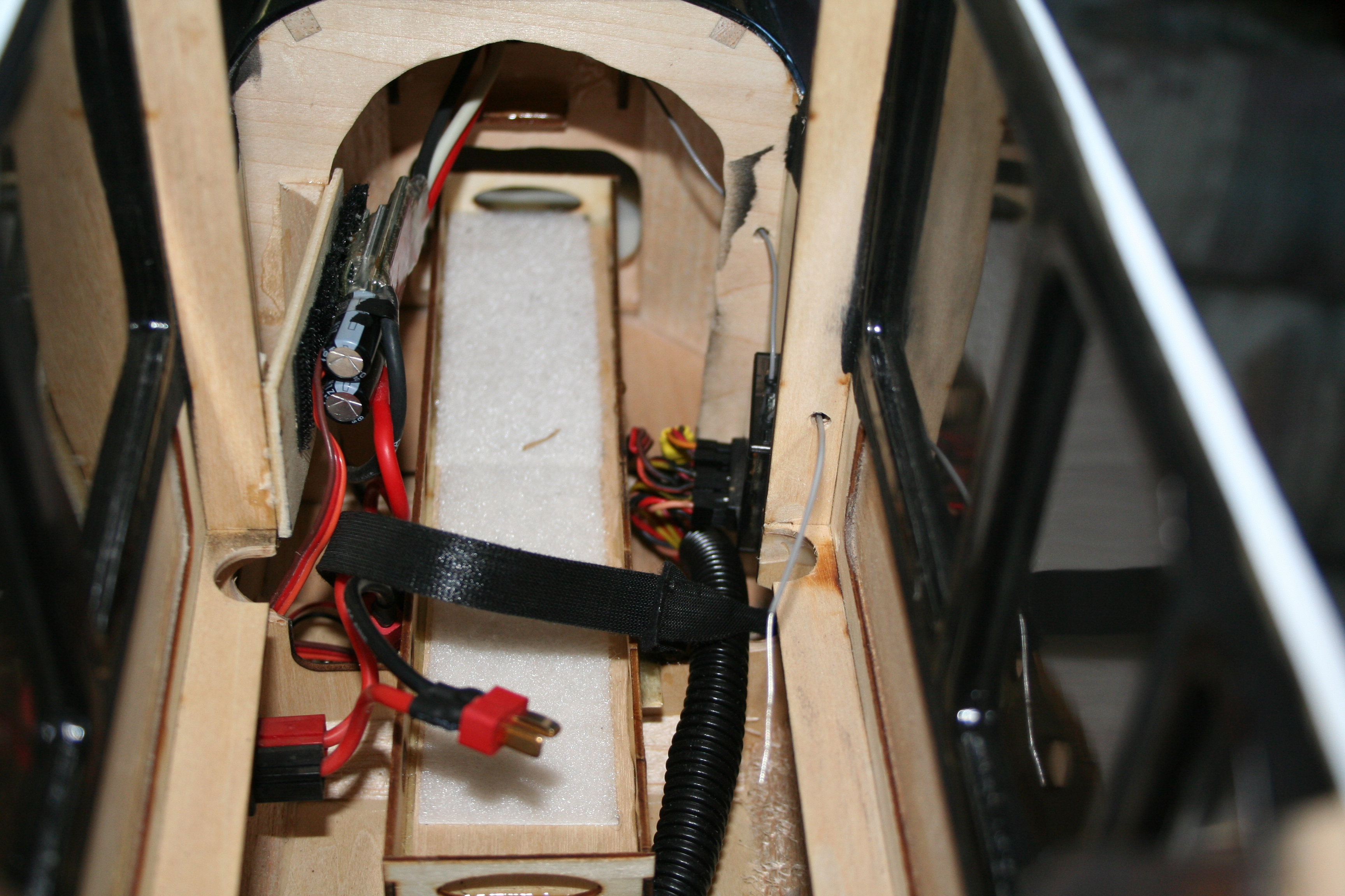

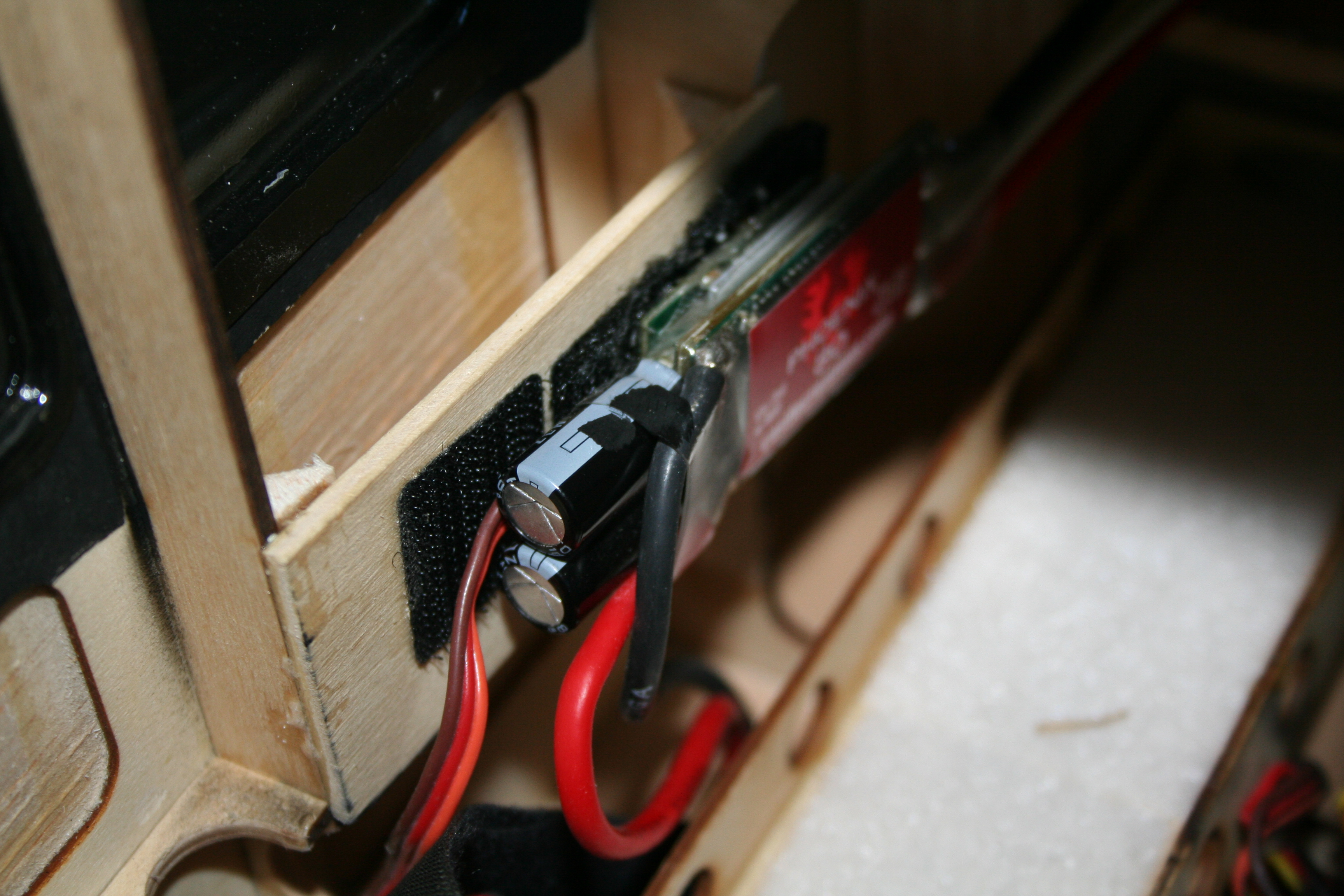

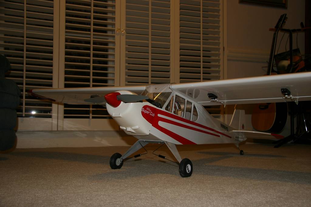

Hello to all,
Thank you for all the useful info that has been posted on this thread. I too have also built this Super cub and love it. I have been flying it for about 3 months now and always have a great time . I went with a electric setup on this project because I have gotten rid of all my glow stuff and only fly electric now. My set up is as follows,
1. Scorpian 4020-14 motor ( 1.5 to 1 power ratio)
2. Castle 80 amp ESC
3 Hitec Hs 475HB in the wings and 485HB in the rudder and elevator
4. 16X8 Xoar prop
5. I use a 5S 5300 MA 35C pack
It comes in at 8.5 lbs all up weight. With this pack I get 35 minuts of fun. I useally split it up into 2 or 3 flights.
I access my pack by taking off the wing. With the disarming plug on the outside of the plane, I dont have to worry a bout the pack wearing down between flights
This is a very solid plane and very stable as you would expect a cub would be. I use my flaps all the time for 6' take off's and slow landings
I have had alot of fun doing flat spins with this plane and when i say flat I mean frisbee flat, but be careful it takes at least 3 rotations of the plane to recover. So give yourself pleanty of highth, oh yeh it helps to have the CG a little towards the tail. I can do 200' inside loops and can also do very nise axial rolls. But the best part is flying low and slow. I intend to put a tow hitch on the plane and tow my buddies gliders up.
Well thanks again for all the info and please check out my picks, The 2 flying pics down below where taken on the same flight the moon was in the east and the sun set was in the west
Thanks Fizzy

WOW what a nice job. It makes me Jealous that I didn't do a better job on mine. I particularly like the way you managed to enclose most of the connecting wiring to the the aileron and flap servos. I don't think I'll be doing any flat spins on purpose that was one thing I was taught as a pilot to avoid at all cost but maybe a few tail spins. I am going to go back to work on mine and see if I can't find a way to enclose the wire to keep them from flopping around inside. I haven't flown mine as the weather here in south GA has been rainning and windy. I am still awaiting 4s and 5s batteries to arrive from Hobby King. I left the front windows on each side out to see if I can access the cabin that way and I think it will work since I can get a hand in from each side but haven't tried it with the struts in place . Thanks again for all the nice pictures. Terry

Hey Terry
Thanks for all the nice comments. I have been in the hobbie for 30 years, so I have built alot of planes. You pick up a few things along the way. One of the reason's I ran all my wires out of the way was to make room for a cock pit and pilot. A buddy of mine that I fly with has the H9 Piper cub same size as the super. When I was looking for a cub I did not what to get the same one he has. His cub has a barbie (cut in half) as a pilot and I though had cool it looked with a pilot. I dont think I am going with a barbie though
The wires I ran up to the wing are just long enough to stay connected with out any tension on them, but also do not have any slop. Because I have to take the wing off to get to the battery,I didnt want to tape or hot glue the wires to the bottom of the wing. It works out really well I dont even have to disconnect the wires while I am changing the battery. After I ran them down the side of the fuse, I didnt like the way they were exposed so thats why I put them behind the angle stock. Then I put all the exposed wire in side the tubing to keep it nice and clean inside the fuse. This plane is as stable as they come, If you have aligned all your controll surfaces straight and you have the CG correct the cub will fly it'self. The only thing I would give you a heads up on is the ground handling. With a wing this big it is very sensitive to wind so make sure you are heading straight into the wind on take off and landing. I am going to add either some more monocoat or some kind of hard plastic to the wing tips. I dont think I have had but 3 landings that the wing tips didn't make contact with the ground, after landing. The link below is of my buddies cub on RCG look for post 516 his name is AKU
Hope your weather clear up soon so you can fly
Fizzy

After seeing your fine job here is what I came up with. I drilled a hole on each side of the "floor" and attached some velcro on the wall. I found some light plastic tubing and put velcro on that so I can easily remove and reattach. I ran the wires down under and back to the receiver. The wires come out the top of the tubing so that I can pull what ever I need to attach to the ailerons and flaps and then stuff any excess back into the tubing. Its not very pretty but the wires won't be flopping around and get hung up on the servos. I really like the Barbe doll in the cub -might try something like that after I test the plane. I don't know when that's going to happen as we have SNOW forcasted here in South Ga for the first time in years. This "global warming" is really getting me down. Terry

what did you end up doing about your battery access, Are you going threw the windows or are you doing something different

Hi Fizzy, Well so far I have just left the Front window out on each side for battery access and have added a quick disconnect plug to the out side like you have and made a few other changes. I had to move my ESC to the side of the motor to get better CG. I still haven't flown it as the weather has been bad. There may be some occasions that I will have to take the wings off but by and large I think it is going to work out by manipulating through the windows.

Correction that's move the ESC to the side of the motor mount.
