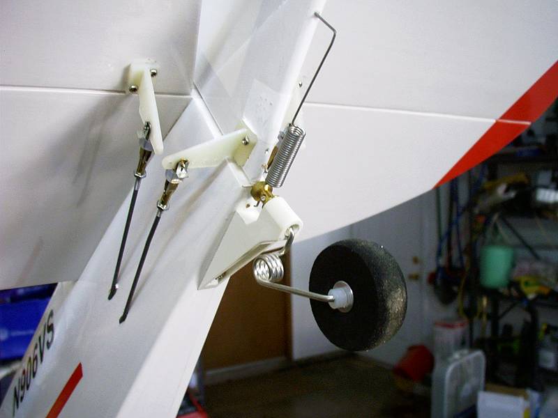

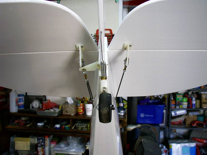

The fuel tank stopper deos not make a good seal, I went to Hobby People and one fo the guys that work there said that his had the same problem, if you use the sullivan round 12oz you will need to dremmel the former that holds the fuel tank because the stock tank is oval.
I finally got my new tail gear, to install it you will need to remove the stock rudder control horn, the new tail set up has a double horn that fits around the leading edge of the rudder, if you made the hinge gap really tigth yo will need to re-hinge your rudder, also the new control horn is a little wider then the thickness fo the rudder so I cut the old plastic bracket that screws into the rudder and used it as spacer to fill the gap. it took me 10 min to change it out, it looks good

Does the stock tailwheel work ok? My cub came last night but I have a great planes cheroke I'm working on first. Looks great. Nice sized plane (cub).

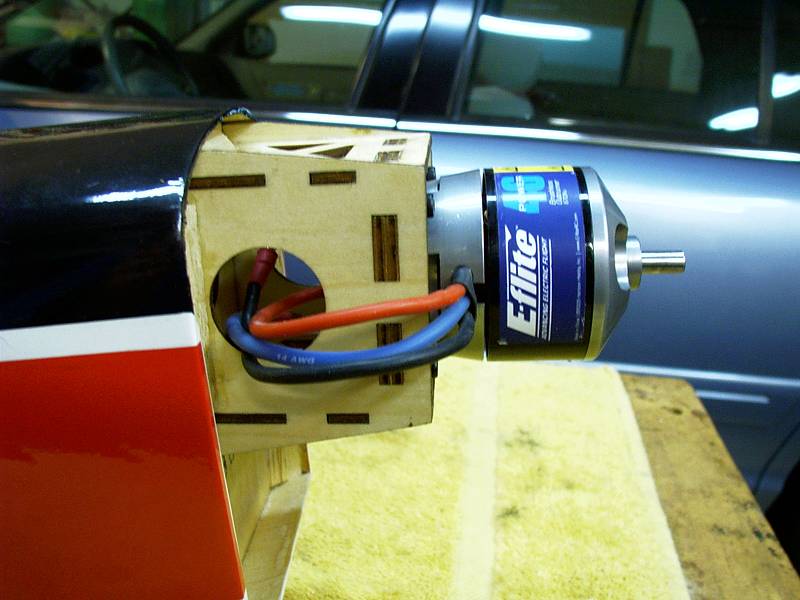

Looks good guys, what is involved in the EP conversion, You said there is a different mount, have they included anything else like a way to get to the battery without pulling the wing off?
Cheers Dale

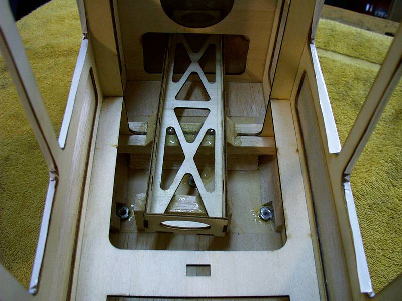

This is my setup. The instructions state to glue to firewall and the two formers. This leaves the back half unsupported. I added some square stock to widen the formers surface area and added a support for the back of the tray. The included motor mount was perfect for the Power 46 both on total length from the firewall and the installed blind nuts. I have not completed the inside yet but initial check looks like it will be a bit tail heavy with the 4 cell 3200mah and 3650mah lipo packs I am using. Priorities have put this on the back burner but all that is left is install the receiver and balance. As for the battery install I have left out the large windows and still can't get to the battery well enough to leave the wing on. Looking forward to better weather soon. Tis' the tornado season. Ahhh Spring time in Oklahoma. Hope this helps.

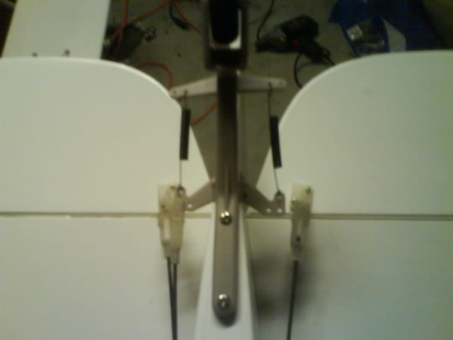

The stock tail wheel looked a a bit weak so I used a Sullivan. I have had good luck with them in the past and it doesn't hook directly to the rudder/servo.
