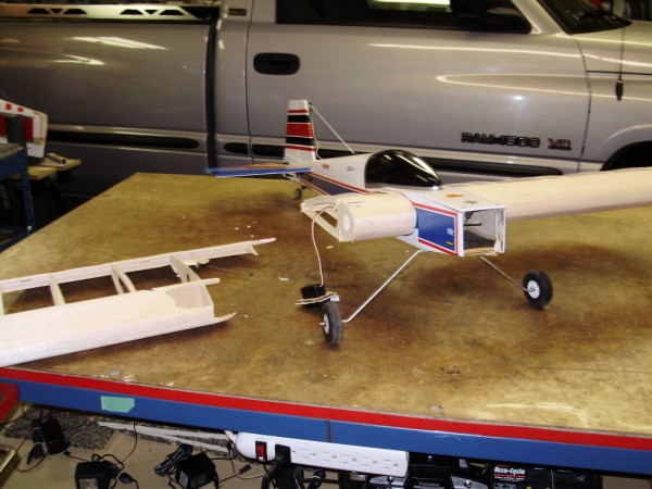

i just got a dazzler arf 40 size. going to put a supertiger 45 in it. anyone else have one? what do you guys recommend extra. some i think talk about adding stuff to make landing gear area stronger. any one that did this have pictures of the change?

how was the parts that came with the plane?
the engine mount in the instructions is the metal clamp kind like mp pts mkII. the one on the plane is a plastic one that is a bit too narrow for the supertiger 45 i got. i think it will work out. but the instructions have the engine much closer to the firewall than possable with the plastic setup. i guess if it is heavy on the nose tail weight is not too bad.since it is far away from c.g.
the servo plate in the wing will not fit with the long square pieces it mounts on.had to trim it narrower. then had to widen the inside for the servoes to sit down. what a long pain in the A.

I am just finishing up my Dazzlar - what a piece of $%^&.
I hope it flies better than it builds.
I'm starting with my 40 LA and will put on the 46 FX when I get a chnce to break it in.
I will eventually do a piece on all of the build problems.
I had to add a weighted prop nut to balance, you may be OK there.
Receiver fitting is tight with standard 72 receiver - good luck on that one.
The wheel locks I got did not fit on the landing gear I got.
The motor mount hardware was metric not SAE as the instructions listed.
My buddy recommended throwing out their engine mount bolts - to soft.
Good Luck and report back on how it flies.

so for the most part it is done. got to check the cg tomorrow with help. wow either i am slow not doing this stuff for 25 years or it was hard. so the parts missing as far as i can tell is i was short the two clips out of four that hold the radio hatch on. the #2 sheet metal screws i wish more came with i would of put 8 of those landing gear straps on.
trim the area of the wing ribs down before putting wing halfs together to make room for the throttle servo to set all the way down. i had to trim what i could and add 1/16 plywood shim.
the 4/40 cap head screw (allen) was missing for one of the throttle cable clamps glad i got a couple packs of small screws and 4/40 was one of them.
man setting up the servos and linkages and the programing of the radio (DX6i) took a while. but i got it.

I recently kit-built one and powered it with a .46LA. It took about an ounce of weight in the nose to balance with the RX and battery as far forward as possible.
The landing gear area seems plenty strong as designed, if the ARF is anything like the kit. My dry weight is right around 4 pounds.
I have only flown it about 4-5 times so far, but it is a lot of fun. The ST-45 will make it haul. You should be able to balance it by moving the battery back.
The biggest downside to the ST-45 will be flight times. They are pretty hungry engines, and the plane only has room for a 6 ounce tank.

nice work. how did you get the wing ribs out or did u make them?(from what).

almost got the engine back in. i moved the engine back so the rear holes are now the front and redrilled the rear ones. had to trim the bottom flat for the nuts. now reassemble and i will post pictures. then re balance. hope no rain tomorrow afternoon.
Joined: Apr 2009
Posts: 155
From: lebanon, PA
ok i am done except balance. it is pouring out side.
old position
holes drilles and bottom trimed for nuts
new better look close to plan picture
old position

the landing gear on this plane is junk. i have never gotten to taxie it back yet. yes i am landing in grass but even a rolling stop the wheels are bent flat and out some what. was up 4 times. last time i leaned it out till it ran correctly. till that it was a full turn rich from now with apc(which broke last flite) 10x7. now a evo 11x6 on it.
anyone put aluminum gear on thier dazzler? i am thinking i am going to. i took out a lot of aleron throw so i do not over do it. i am at only 30%. pull the switch and it looks like it wants to brake them off. hehe...i need stick time.
