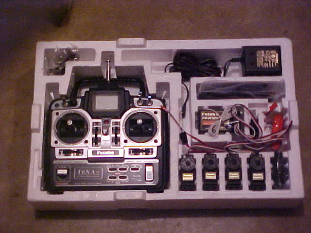

Have a look at this, I got it just for my new Extra. Of course it will hold 6 planes so I need 5 more planes!!! LOL...
Hope the wife sees it this way hehe.
VF just sent me an e-mail saying they have my check and my bird will ship in 3 or 4 days.
How long is it taking everyone to get these things ready to fly?
Miloh.
