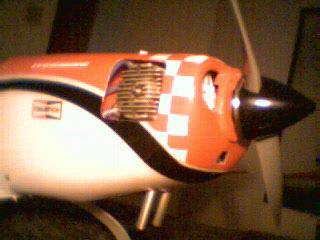

The air leaving the cowl need to be 4 times the air entering the cowl this means a large hole in the bottom and in some cases a baffle needs to be built to direct the air.The bottom of the engine does not need to be cooled as much as the top and if a O.S. 91 is being used this is very important.I just went through it with mine.The engine flew great for several flights then suddenly became touchy.Most of it was due to heat,but there is a issue with the gaskets on the needle valve.If you have problems with the 91fx call hobby services and they will send out black gaskets to replace the white ones.

My ASP 91 is a clone of the OS 91 2 stroke, it will not fit, fully enclosed in the cowl.

David, thanks again for the info on the covering material. Am still trying to determine if anyone out there has mounted either a Tower or Supertigre 2-stroke .75 horizontally or inverted in the 66" Extra 300 without having to cut the cowl. Thanks, Joe

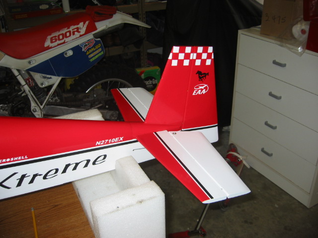

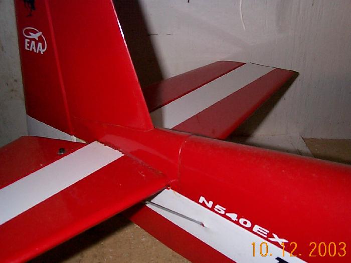

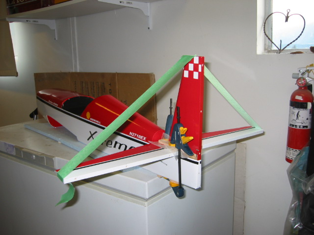

Here's a photo of mine while I was glueing it up. The turtle-deck ends at the front edge of the horizontal stab. so when everything is assembled you need to fill the area in top of the horiz. stab to carry the line of the turtle-deck to the aft end of the fuse. VF supplies a little plastic cover that you are supposed to glue in here. I just couldn't see a way to make this look nice, and last. Given that additional support for the rudder and horiz. stab is advised, I thought I'd just build my "fairing" with blocks of balsa and carve/sand them to shape.
The second picture shows what it looks like done.

Hay Cooter is the Edge done with the supplied plastic parts? and is that glue showing on the Extra and is this how the finished product will look?
I'm also wondering what kind of hardware you used on these birds, did you upgrade or use the supplied parts and what is the impression of the parts used?
I will be house bound when mine shows up and want the right stuff here to complete it, if I had the benifit of your hind site I could go shopping before I become imobile.
Hay David Moen you could chime in here too.
Thanks, Miloh.

Its probably my prospective... either thass a small freezer or the extra looks like a 1/4 scale plane.
I just ordered one friday, how wide is the stab? the plane looks large, or larger than i would have expected.

It's not a big freezer...All the measurements are on the VF web site aren't they? The big stab/elevator is probably why these planes are very sensitive on the elevator. Scroll up a page or two in theis thread. I posted a picture of me and my Extra at the field, that will give you a better idea of the size.

Uh, yes, that's the plastic that was supplied with the kits. And yes, that's a sloppy glue job. I should have wiped the excess off with some alcohol, but was in a hurry, as usual. I could touch it up with some white paint, someday...........
