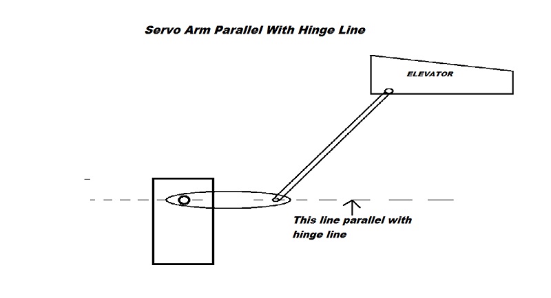

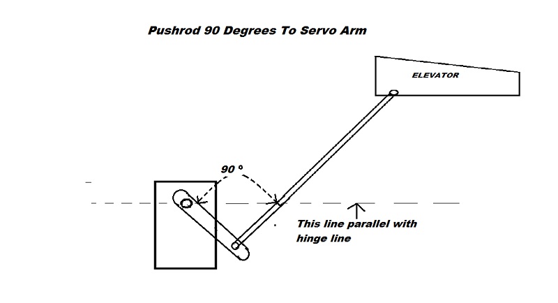

Hopefully I can get an answer once and for all on pushrod setup. After searching for hours on the Internet I still haven't come up with a black and white answer.
Even though i and Windows Paint don't get along very well I muddeled up a couple drawings tohelp with my question.
In this example, the dual servos are in the fuse and the pushrods are crossing each other. The pushrod angle in the drawing is a little severe just to help get my question across.
Most of what I've read says that for the elevator to have the same amount of travel the servo arm should be parallel with the elevator hinge line
It seems to me that to have the same amount of travel up and down that the servo arm should be 90 degrees to the pushrod.
Which diagram is correct for the same amount of travel both up and down.

your first picture is right. The servo arm and the pushrod must be a 90 degrees when the surface is at neutral.

OK, now we have a concensus. I wish that I could get on the Internet and delete all those 10's or 100's of pages that said the servo arm should always be parallel with the hinge line. So if the first one is correct then my next question is about the setup for the ailerons. If it helps I will get back on Paint and make a couple more diagrams, but I should be able to describe my question.

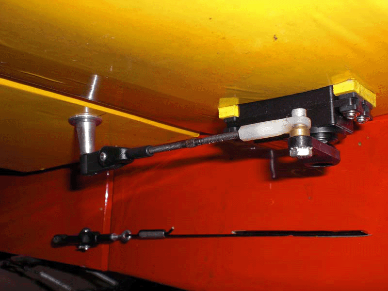

The servos are mounted in the bottom of the wing on their side using a hatch. So the servo arm sticks out of the bottom of the wing through a slot cut in the hatch. The pushrod is going to run at an angle to the chord line of the aileron, when the aileron is at neutral. Forgetting about differential for now, to have the same travel up and down the servo arm should be at 90 degrees to the pushrod. Correct?
Like my first question, there is a lot of information out there that says the servo arm should be perpendicular to the aileron.

Yes, with the servo arm poking through a slot, the arm should still be perpendicular to the pushrod when the surface is at neutral.

On the kinds of planes that beginners fly, how important is it that the elevator travel be exactly equal in both directions? My guess would be, on a scale of one to ten, about zero. Rudder travel, sure. And for ailerons, you usually want differential.

wait one second here I think the first picture is wrong. the arm should at center be parallel to the hinge line. That way when the arm moves it has equal up and down movement. the push rod should be 90 degrees or perpendicular to the hinge line. the second picture is right but it looks off because the pushrod is not perpendicular too the control arm

Now we don't have a consensus. Okay Rlipsett, lets say I am going to use a stiff carbon fiber pushrod that has very little flex. There is no way to run the pushrod 90 degrees to the hinge line.
If the servo is mounted in the fuse and the control horn is on the elevator the pushrod is going to run at a slight angle to the hinge line. Not as much of a angle as in my drawing, which I exaggerated to get my point across. What do you say now?
Pat

The first picture is right! Not the second!
Look at it like this. The pushrod is what you should use as a reference line!
Then you imagine 90 degree lines to the servo center and to the pivot line (Hinge line) where the elevator is attched to the stab. Simple as that!

I agree with setting the push rod 90 degreesto the servo arm and control arm but for maximum throws the arm has to also be parallel to the hinge line which the first picture is not even close too

The elevator hing line is in the middle of the rear line on elevator picture drawn. If the control rod is 90 degrees to the servo arm center... and at the same time....rod is 90 degrees to the elevator hinge line ...the trows are equall!
