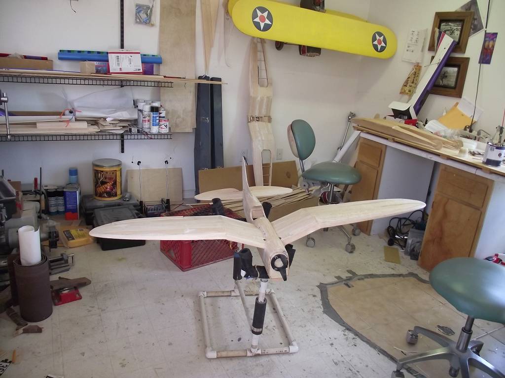

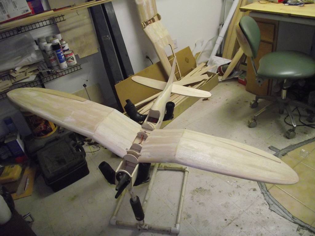

ORIGINAL: BillinIndiana
. What I am going to do is build another set of wings when I feel comfortable flying the trainer as the plan says to build it. Then I'll probably reduce it by about half the angle the plan calls for.
That plan is if fine if you just stick with the stock dihedral at first. Now if you want to talk dihedral on a conventional trainer to make it more aerobatic for down the line forget just flattening the wing, lets talk anhedral. Using about the same anhedral as it formerly used dihedral will impart a very neutral roll response much like a pattern airplane and its that 'stays where you put it' feeling that is so prized by the pattern pilot.
Also the airplane will be more stabile than it would be if you had just flattened the wing. Just remember I definately do not recommend this for any one new as the achilles heels is the difficulty in maintaining orientation with the unusual configiguration. This is just one example of the time honored propensity of the modelers tendency to 'kit bash'.
Just don,t do it now!

HOW MUCH EPOXY IN ONE COMPLETE BUILD?? About 15 years worth.
I just used about 6 ounces of CA and about an ounce of Epoxy in this build including the floats.
There was a lot of epoxy used in the gull sections, I use acid brushes to mix and spread epoxy. I buy several packs at a time at Harbor freight. Just starting to glass now. The other one is getting covered with TEX. This one is mine and it's fully sheeted and getting glassed.
There were a lot of diffeent types of glues used in the builds. Bill what would you do about this dihedral???
