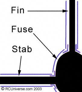

I know I am getting ahead of myself here, but now is as good a time to ask.
Many builders of the Kadet LT-40 recommend gluing a piece of triangle stock to both sides of the fin where it mounts the stabilizer (see photo 1). I don't want the aggravation of trying to cover around those supports when the time comes. Also I don't like the looks of them. I like the basic square connection of fin to stabilizer.
MY QUESTION IS: Instead of the tri-stock supporting the fin is it possible for me to drill 3/16" holes into the first upright 5/16" square balsa piece of the fin and the 5/16" X 1/2" balsa trailing edge of the fin and insert 1/2 of a 1" piece of 3/16" dowel in these holes and the other end of the dowels going into 3/16" holes in the fuselage/stabilizer? (see photo 2)
I would much prefer to have the dowel supports over the triangle stock supports as the dowels would be buried into the parts and hidden from view and I can have the added support and the basic square connection of fin to stabilizer that I like.

IMO you would get a lot more strength done per photo #1. This is what they make Trim Irons for. Your choice in the end. You will need to be VERY accurate in your drilling leaving 1/32 on each side only.

I have not done either to my LT-40. I have been meaning to go back and add tristock, but have not gotten around to it. Anyhow, I fly the heck out of it and have not had a problem, but I would agree with Bruce, go with the tristock if you are going to strengthen the area.

I actually broke my vertical stab off, and re-attached it by doing both of the options you have outlined above. Instead of 3/16 dowels I used tooth picks, and put 3 of them in. Worked really well. And since mine was white, I picked up some fuel proof paint and just painted them white instead of trying to cover the tri-stock.

ORIGINAL: brocja01
1]With the top part of my fuselage and stabilizer and fin being red would it work with me to add the tri-stock and just paint it red like you painted yours white?
2]How does that finish blend with the rest of your covering job?
3]Would there be a real big difference in appearance with the painted tri-stock and the Coverite fabric that I will be using for the rest of that area?
4]I really would just prefer to paint it to match the covering if I really should use the tri-stock. Do they have fuelproof paint that matches Coverite fabric?
5]What size tri-stock is preferrable to use? Should I go small with perhaps 1/4" or should it be more along the 1/2" size?
Please HELP
Especially all you other LT-40 owners, let me know how you handled the fin/stabilizer mounting.Thank you to all who help me decide!!!
UPDATE: I think I am just going to use the tri-stock for the support and just paint it red to blend with the covering. Now that I believe I made up my mind: A]What paint blends well with Coverite fabric? B]What size tri-stock, 1/4" or 1/2"?
ANOTHER EDIT [:'(] - - - I thought I read somewhere that a certain spot in the fuselage should also be reinforced with tri-stock. Am I dreaming this [sm=bananahead.gif] or did I really read it. If I am not going crazy right about now
and it was brought up at some point somewhere, where is this spot in the fuselage that should be reinforced and what are the details?

Ken, when you cover the tri-stock with covering, and then glue it onto the fin/stabilizer won't the seams be too unsightly? There would be a seam all the way around the tri-stock. Would that be acceptable in neatness? I will more than happily use tri-stock and cover it with Coverite if someone can show me how to do it without leaving huge unsightly seams around the perimeter of the tri-stock. If it only leaves tiny seams hardly noticeable then by-all-means I will attempt it.

First of all. When I build a plane I completely assemble the plane BEFORE I cover it, so covering over the tri-stock is not a problem at all. But in your case, what is wrong with applying a small piece of covering over the tri-stock after you attach it? Nobody will even notice it unless they are looking for it.

Ken, although the plans call for the stabilizer and fin to be covered before attaching to the fuselage, you are going to assemble the whole thing first and then cover it? That is how you recommend doing it? I am not even going to attempt covering mine until I see you do it.
. Although I have attempted twice to assemble the whole frame of the plane before covering (with the PT-40 and the Air Scout) with unsatisfactory results to my liking. Should I attempt it again with the LT-40. I kinda wanna see if it is easier covering before attaching them but I wanna follow your lead also and have a better chance of doing it good for a change.
EDIT - I am probably looking at this as a bigger problem than it is, but I am sorry - that is how my mind works [sm=bananahead.gif] I know it is probably easier to just attach the flying wires and not even worry about tri-stock but I don't really believe they would look good on a trainer (and I don't know how to do them).
I am just going to keep following Ken's thread and I will finish this
by Spring.
DECISION MADE: I am following all your advice and I am using tri-stock [1/4"] and covering it with Coverite. The painting would prob have looked worse than the seams would ever look and prob would not have blended well. Now one more question ( I really hope you don't mind): Do you glue the stock all the way the whole length of the fin or end it where the fin meets the fuselage and just glue it to the stabilizer? You guys have helped me make up my troubled mind
and I thank you so much for it.

Spring? More like Christmas I would suspect, even if you work slow. That is if we can get Ken back to work. [:@] There are times when covering some parts of an assemble plane seem tough but is is just a matter of taking your time. If it gets to a point where you are getting frustrated, go watch TV for a while and relax, unless Oprah is on. [:'(] That could be enough to make you stomp your plane.
Use a trim iron in the tight areas, a standard iron for the edges and the gun to do the shrinking. Once shrunk, I go back and make sure it is stuck down good to the wood. Lay it out straight and snug to start and let the gun take out the wrinkles. It's just another skill to learn. 10-20 years and you will get it down fairly well.
