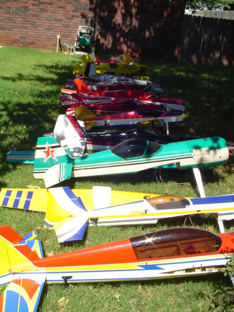

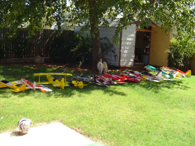

I have several different planes. The scale or size you want to fly depends on your budget and the place you have to fly. The smallest engine I use is a Saito 72. The three planes I fly the most have a Saito 1.80, Super Tigre 90 and a Saito 82. I will do a second post with a pic I took last week of my fleet. AS you will see I have a lot of different sizes and styles.

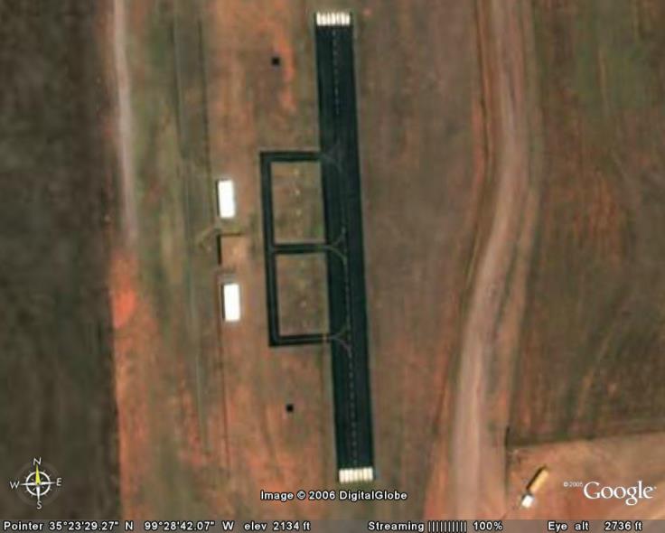

1. How can they invest and operate this very big flying field?

I did get your email and I sent you a reply.
1. We do not have a sponsor. Our flying site is on property that belongs to the city I live in. If you notice in the pictures there is a race car track next to our field. Next to that is a motorcycle race track. Further east from that is a place to ride horses.All this belongs to the city. We rent the land for $10 a year. We did all the work and do all the maintenance. It took us 5 years of work and many donations from local businesses to get our site done. Elk City is a town of about 11,000 people. In our country smaller towns like ours try and have nice areas so people will want to live here. This is why they help us out.
