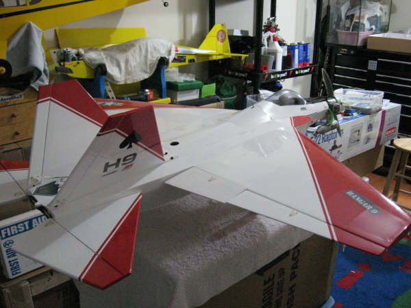

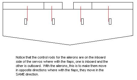

Newbie here - I posted the same question on the ARF/RTF section then realized that I should probably post it here in the NEWBIE section, duh! Ok, question:
I'm installing flaps on the F-22 Raptor (PTS) from Hangar 9 and I'm having issues. The inst. tell you to "just install them" and when I did, I get reverse throws (one flap goes UP, the other goes DOWN). I'm using Futuaba servos and a Y-adaptor but what gives?! Why are they going reverse? I could turn one of the servos around (physically) but this would cause me to modify the servo arm and the flap installation area under the wing. Much more work then the manual makes it out to be. I don't think this is what Hangar 9 intended.
What am I doing wrong?

You cant have the flap servos installed normally, and connected with a normal Y harness. You need to either have the flap servos in different channels, have a "reversing Y Harness" or flip over one of the servos like you mentioned.

The easiest thing is to install the servos so they both go in the same direction but at this point, since you already have them installed, a reversing Y harness is the easiest. Something like this:

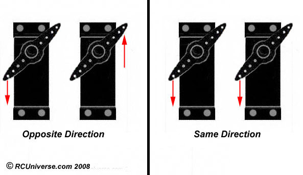

How did you hook up your linkage? With ailerons, if you have dual aileron servos (one on each aileron).. I don't have any idea how the PTS is setup, so I'm going blind here.. with dual aileron servos, both control rods are on "the inside" or "outside" of the servo (meaning, both setup with the rods closest to the fusleage or on the other side, furthest from the fuselage.
With flaps, one goes on the inside, and one goes on the outside. Then you can Y connect them and then reverse them as necessary to have either flaps (down) or spoilers (up). I will post a drawing shortly to show you what I mean.
CGr.

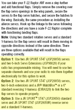

That manual for the F-22 explains this, and gives you 3 options.
[ul][*]Option One - Use standard servos and program a computer radio for flaps so that the servos move opposite each other.[*]Option Two - Use a reversering Y-harness to connect 2 servos to the flap channel.[*]Option Three - Use a JR ST47 standard sport servo and a JR ST47 reversed sport servo connected to a Y-harness plugged into the flap channel.
[/ul]

Default RE: F-22 Raptor Hangar 9 - Installing Flaps
Just switch the arm on one of the servos

THANK YOU SO MUCH, EVERYONE....I should have been using this msg board a long time ago.
Yeah, I missed out on the details of the instructions, I breezed past the "reverse" servo detail and went straight into the frustration level. For those wondering:
I'm using a Spektrum DX7 Radio (love, love it!) and for a while thought that my issue was the Tx and me not understanding servo reversing or other programming available. Then it dawned on me that you can't reverse (only) 1 servo when 2 are connected to the same line (Y-harness). Chalk it up to the newbie learning curve.
CGRetired: The F-22 has separate servos for each aileron & for each flap (exactly like your diagram), what I failed to realize was what RCKen posted; the instructions! LOL! Need to pay more attention I guess. So in essence everyones advice will work great - but I'm probably going to roll with what Misselman said with the reversing Y-harness since I already have both servos installed (and paid for!).

Since you already have them installed, then, yeah, the reversing servo Y cable is the way to go. Just make sure they do what you intended to do before you fly the plane. Nothing like having the flaps working against the ailerons.. like ailerons in the opposite direction as the real ailerons. That could really confuse things!![X(]

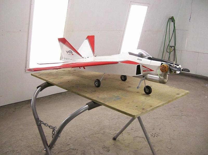

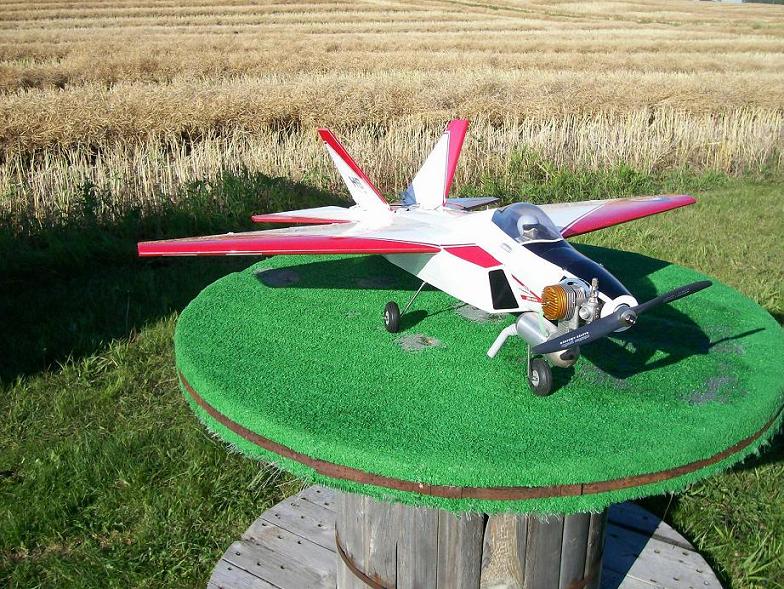

Yes it is heavy. If you decide on a .46 for power it will fly but that is all. I put a .61 GMS in mine and I'll tell you it is nice having the extra jam to get out of sticky situations[X(]
