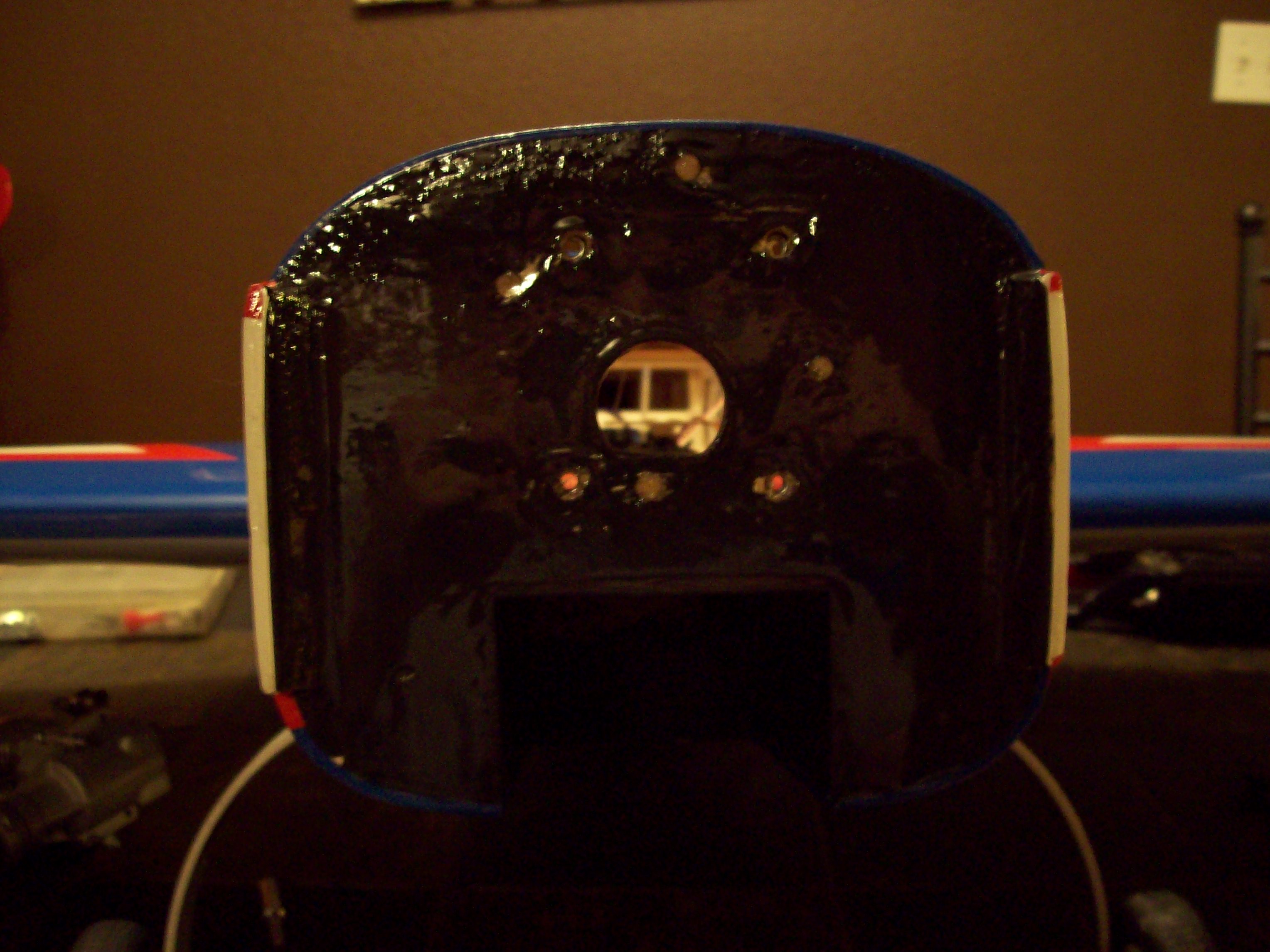

alright guys let me start with this, last sunday I fly a bird with the engine on her and she was sputtering during flight and then called for a mayday landing which resulted in a blown bird " fixed already." I thought it was the glow plug so I changed her out and tonight I can get it up to 1/2 throttle and she dies hummmm??? I removed the auto restricter on the needle valve and to no luck will it run correctly so i'm at a loss for words. ANY AND ALL ADVICE WELCOME !!!!!! evolution .46 nx never will I buy another 1 nothing but problems mind you the engine has had appx 3 tanks throught it and the engine seems to get kinda hot "ER" than normal

ok good advice guys keep it coming im willing to try just about anything but taking that motor off, it was a act of god to get it mounted on the nexstar the needle valve set way too far back against the firewall and could not get an allen wrench on it confusing none the less but try to put a evolution on a nexstar plane and mount and you'll know what i mean
permanently mount an Allen wrench and poke it through the side of the fuse. Until you get into scale you don't really get what a hard engine install is

i've done mounted a scale engine i took out the 270 deg motor mount blinds an moved them to 90deg along with figuring out all the etc stuff that was nothing comparded to mounting an evolution engine on a nexstar
