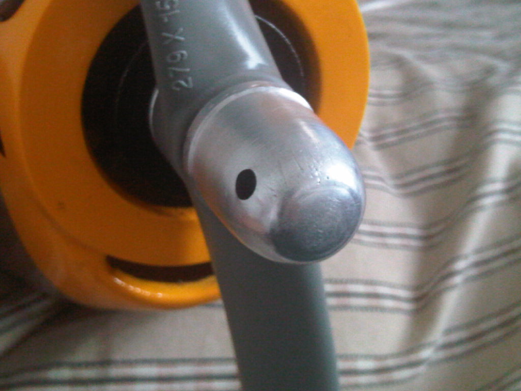

Well,
Now I'm kinda perplexed whether I should use the washer or not. As per Dsegal yeah, my washer came with engine as one engine is Evolution .46 PTS other one I purchased was Magnum .46 XLS. The washer I have, has back side flat and front side is little arched/curved or concaved. Naturally flat side would be touching the prop and lil curved side would be touching the prop nut. I'm also attaching the pictures of My Mustang as well as Escapade. If you may noticed there is a little bit slit between the prop nut and the washer. I have now installed washer on both of my planes. I flew my Mustang without washer did not encounter any problem of spreading the pressure all around prop or confining the pressure at one spot.
Please clarify me, do I need washer or not, or if I may get the thin washer for me Evolution .46 PTS and Magnum XLS .46.
Thank you and pix are being attached for y'all to look closely.
Mody

The prop nut you are using in your pictures will be just fine without the washer. It is a large diameter nut which spreads the force over a large surface area all on its own as others have pointed out. When I originally said that the washer was necessary, I assumed you were talking about the small hex nut that came with the engine.
Ditto,
Cheers,
Colin

mcline, ChuckW, Crash Campbell
You guys have much more experience and knowledge than me. I respect your advices. I'm gonna do as you say. Roger that. I I CAPTAIN
Only prop nut is gonna be used gotta loose 'em again[:@]
Thanks and happy flying.
Mody

Using the spinner nuts you have posted the pictures of you do not use additional washers. Agine no washers.

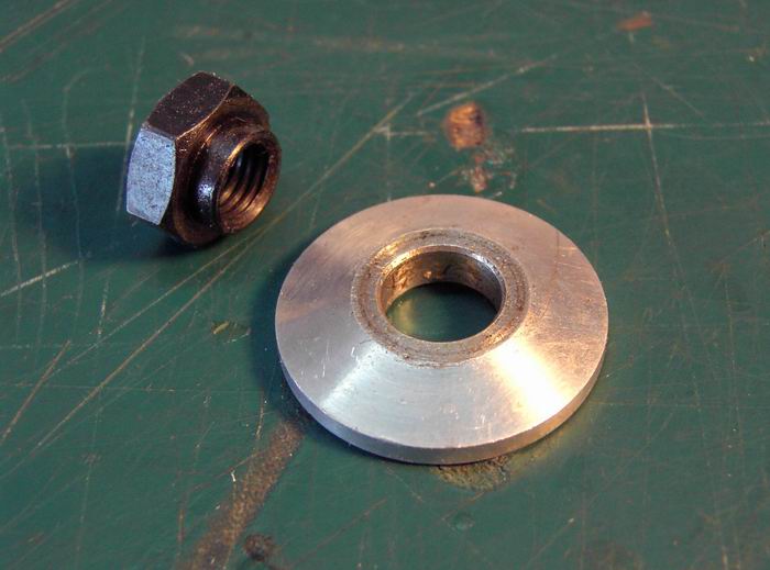

DJ I suspect what you have something similar to this with a shoulder nut and sized washer and of course this is yet another variation among others.
John

Old 04-16-2010 | 07:50 PM
armody's Avatar
My Feedback: (10)
Joined: Aug 2005
Posts: 1,454
From: Rockwall TX
Default RE: Is it necessary to use washer with prop nut?
Yes these are the washers I used to use when I was using hex nut.
