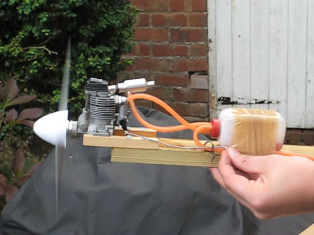

I ran up the OS FS-30S engine today on the bench with a 10x5 prop - I reckon I might get 18-20 mins duration from a 6 oz tank. Started first time and sounds sweet at idle or full throttle. It's my first I/C engine and was not quite as messy as I expected - just a little fuel dribbling out of the carburettor and greasy exhaust.Will post video link later.

We got the engine mounted on a stick for running in - just tried posting avi but not accepted
. Running time was 30 mins, over the whole speed range and running quite rich. Should give nice long flight times.
EDIT: Just added the video to youtube - it's not much but it amuses me:<span class="Apple-style-span" style="font-family: Arial, Helvetica, sans-serif; font-size: 13px; font-weight: bold; ">http://www.youtube.com/watch?v=Un7_34iZ94Q</span>
QJ

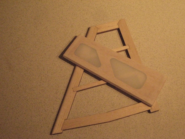

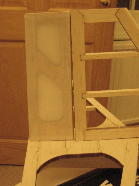

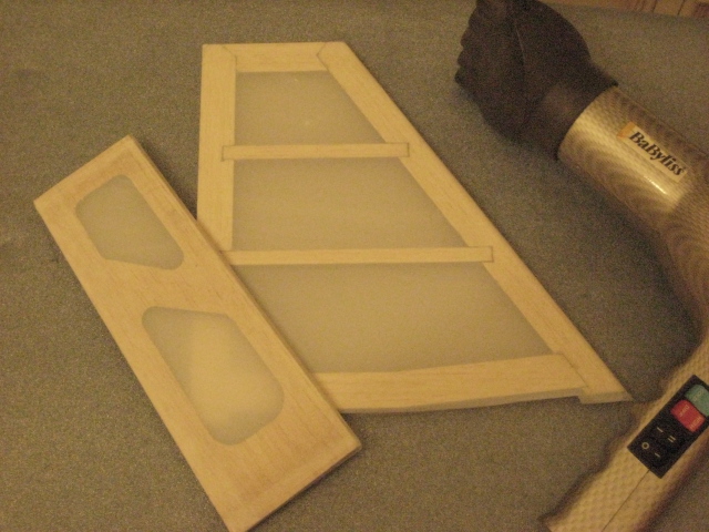

I covered the rudder this evening using my (clothes) iron - smaller covering iron is in the post.![](https://www.rcuniverse.com/forum/js/fckeditor/editor/images/smiley/msn/regular_smile.gif)
The transparent white seems quite... erm... grey and nondescript but I think it'll be ok when its all covered with orange up front and orange trim lines. I think I'll use the LT-25 decals on the fin too. I used 'Balsaloc' on the wood first and it does help I think to grip the covering when you stick some heat on it.
It's not the neatest but it could have gone a lot worse! I'll tackle the fin next - should I do it in one piece (wraparound) or in two pieces?
QJ<br type="_moz" />

I like that look! It's natural.
I did the wrap around on mine. I think its easier.

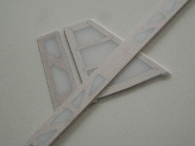

After using Balsaloc and heatto stick the Prolight/Oralight to the rudder, Iread the covering instructions. Apparently there's a thin transparent protective film attached that Idid not notice
. No wonder the 25µm film seemed so sturdy!
I'll have to remove the scrapfilm from the rudder and do it again. At least Idid not waste a bigger area. Ireally should read first and do later. It will probably work out a little more transparent when done correctly. And will probably stick better once Iconnect with the adhesive.
QJ

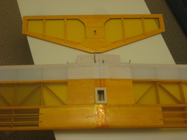

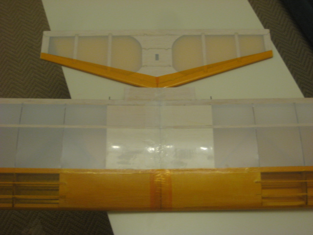

I have covered the fin now and it looks great. I plan to put white on top of the tailplane and orange underneath. The white covering is semi-transparent so you don't see much through it.
EDIT:I did the elevator this morning and got too much air stuck inside the air pockets. I had to use heat to un-stick a part of the edge to get a blade in and let the air out. Quite stressful. Looks ok now though. I was so tempted just to stick a needle in it but I guess that would be a bad idea with so much tension in the stretched covering.
Can anybody advise: should I use dope underneath fuelproof paint, or just paint directly onto wood (balsa/ply)? The SIG manual recommends to paint straight onto the wood - is this right?

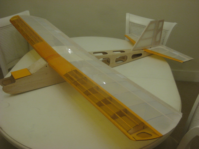

Not much time! I covered the wing this weekend - total weight is 480g. The oracover/ultracoat is really easy to use - I thoroughly recommend it.
The wing is much stronger now with the covering in tension, and easier to handle without turning to matchwood.
Update: the rudder is now hinged (sweat!) but the other control surfaces are still held on with sticky labels. Engine bay is fuel-proofed and I don't think I will bother with orange paint.
