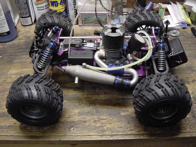

Here are some pics of my big block .21/.28 Fun Factor. It has an Ofna engine with Savage header, cut U MT2 manifold, Pirate 10 pipe/fuel tank/tires and Cen big block engine mounts. I ran it today for the first time and actually did not break anything. All I can say is that the .28 fun factor is a wild ride when it hits top speed.

lookin very nice and tidy digout. out of interest what clutch and gear ratios are u running in there? 2 speed?
word of warning - i had the rear mounted battery box, and i founs that wheelies would sometimes rip the lid off, leaving the batts dangling out the back!

The gear ratios are 11/14 for the clutch bell and 44/47 for the spurs. These gears work well for the tall Ofna Pirate P10 tires. I would rather use the single speed set-up knowing how the 2spd shift pin break so easily. You are right about the wheelies and the battery box. I may have to reinstall the all-in-one P10 battery/receiver box. If things start breaking, I plan on going back to the .15 rear exhaust big block or OS 18 CVRX set-up for cvas/axle longevity.

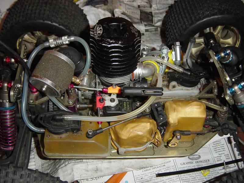

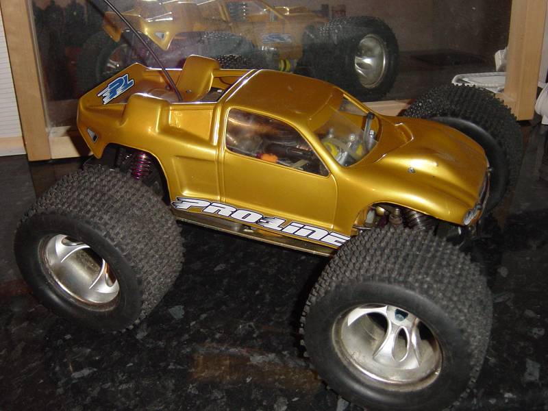

sorted the shell position out, and added some elastoplast, i mean stickers, to cover up some nasties and make it look a bit prettier... awww int that nice
[8D] also moved the rx and failsafe to on top of the steering servo - ballooned up.

PJ, did you paint those balloons gold or did you go looking for ones that would match the paint scheme? Oh and that mini RC18, that thing is going to fly, going to embarrass much bigger competition with that.

lol paint em? nah, i needed some so kept my eye out, spotted a selection in tescos and got some pearl effect ones - well yknow if they are there then u get em - dont want u thinkin i hunted em down. they are loads thicker than the cheap balloons so dont split easy.
