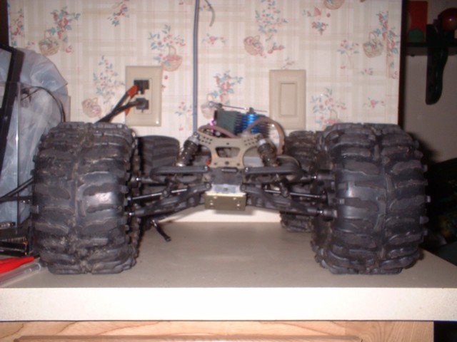

Here is a list of parts that I used.
Diff cups, http://www.acehardwarehobbies.com/2....oducts_id=6652
These need to be shortened 1.5mm and flats ground to slide into diff. Taper ends in for clearance and clearance the underside of the arm a little bit.
Nuckles, http://www.acehardwarehobbies.com/2....oducts_id=6607
Axles you will need 2 of these, http://www.acehardwarehobbies.com/2....oducts_id=6659 and the pins need to be filed down so that they do not protrude out of the diff cups.
Traxxas pivot balls, http://www2.towerhobbies.com/cgi-bin...33&FVPROFIL=++
Traxxas piviot ball caps, http://www2.towerhobbies.com/cgi-bin...=++&search3=Go
The spacers that Traxxas uses on their pivot balls is not long enough so I used some extra shock pistons as spacer, 2 on the top and 1 on the bottom.
So far every thing is working great but I need to get some longer turnbuckles to hook up the steering.
I found my camera but I keep getting DNS errors every time I try to upload. Even if I try to upload to my gallery.
rolland

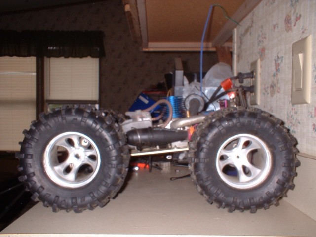

lookin very nice!! i especially like the truck stand!
what wheels and tyres are they? hope they dont give u the spur eating trouble that i had... should be ok with the 18 tho.
oh one thing i noticed looking back at mine was that the plastic shafts are now quite twisted, can twist them by hand... a lot... it could well be acting as a good shock absorber for my diffs... are u on the standard diffs rolland?

The OS box is the perfect size for a truck stand.
I am not going to run those tires I took them off of my X-Factor for fitment. They are Imex Romulins with Losi LST tires with shaved foams for rock crawling.
I am going to run buggy tires first (they are cheap) and then order another set of the Romulins. Mainly because I have to do the rear first and I can get buggy tires that are about the same height.
I am running the machined cross shaft and the standard gears in the diffs.
I think I figured out the pic posting prob.
rolland
rolland

lol, wow man couldnt u find any bigger tyres?
and im not so sure u should plug it into the mains either!!
im having a rummage around in the uk for those shaft parts, bearings are just plain boring! prices are scary here tho...
what tyres are u looking at out of interest? and hows ur brake? mine took a bit more stopping with the bigger wheels... alloy brake helped, uprated servo sorted it.

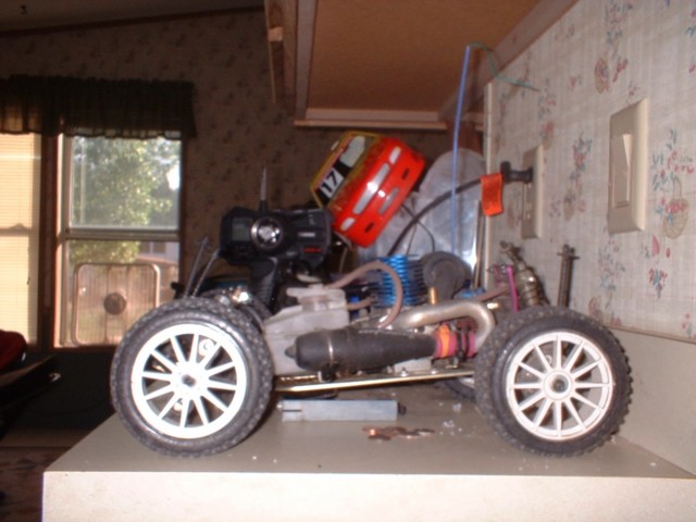

all looking and sounding good rolland, keep it going mate!
clutch bearing is heat, and the spur is just rubbing on the diff casing for some reason... feels smooth, just stiff, think its straight forward.
might just go with ceramic bearings to be sure... have to get 10 at a time tho, so will sell some on i think, cant see those failing quickly... i hope... theyre from the US tho, so gonna take a while to sort it out im afraid[&o]

thanks for the thought mate, but no, i left a tiny bit of play in the bell. its the first time that i have used plastic sealed bearings in the clutch - they came with the bell, and i was told that they would be fine with my setup by the people i got them from. steel sealed bearings have been my choice in previous runs with no probs.
nearly there then mate with ur shafts! u are running 17mm hexes i guess? i realise u will be trying the buggy wheels first, but do the 17s leave many mt wheels available that will work? or do u just want rid of the romulins adapters? hmm that would make sense i guess...
as for tyres, i really cant fault the brick pins, but then they are all i have run in an mt setup on this truck. they are wearing very well tho, better than any of my rally tyres.
good luck with the parts rolland!

Ran the truck with the buggy tires today and all I can say is "why didn't I do this sooner".
Handling is far better than stock and the turning radius is unbelievable.
The only thing that needs to be done that I didn't do is to put some fuel tubing behind the CVJ's on the diff cup side to hold the cups in place because they slide out a little bit due to how the axles have to be adjusted to get full articulation. Other than that no problems at all.
Now that I broke a rear dogbone the truck is on the shelf until the LHS gets the parts that I need to do the rears.
This weekend I will see if I can find the Ofna parts to do the swap. I know that the CVJ's are the same but I do not know about the diff cups and the knuckles.
rolland
rolland
