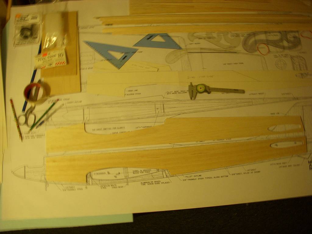

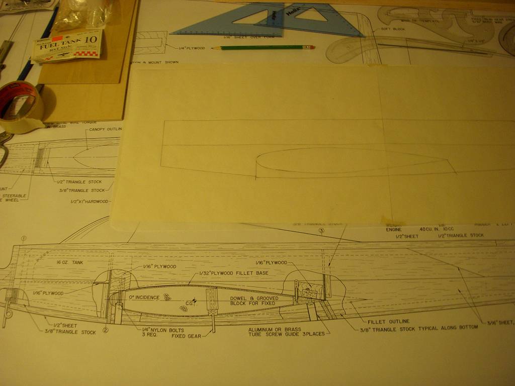

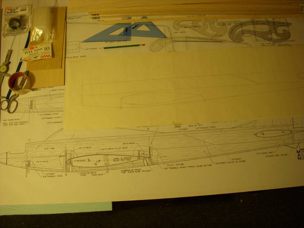

Tail parts are done the same way. I'm using 3/8 balsa for the rudder and vertical stab. The fuse top will also be 3/8.
I used 1/2 inch triangle stock for the top of the fuse, and 3/8 for the bottom. This will require me to design fuselage frames and the firewall to fit. I'll probably widen the nose slightly because it's a tight fit for the engine mount.

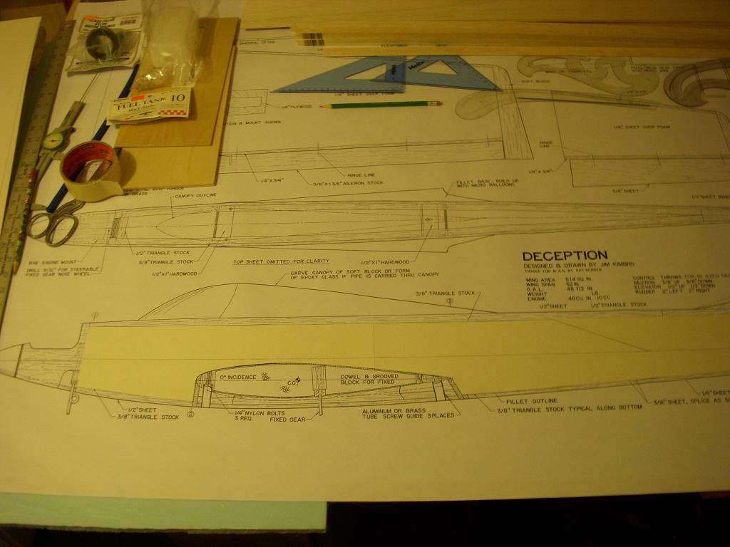

That's the progress so far. My goal is to be framed up and ready to cover by January 3. I'll update as significant progress is made. Your questions and comments are welcomed.
I am waiting for a friend with a CNC foam cutter to come through for me and cut cores. If this does not pan-out, I'll have to send it out for custom cutting. Solicitations and a quote are welcome here.

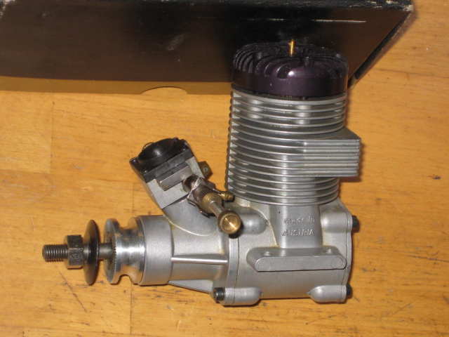

Mitch,
if you can bring her in at 80 oz AUW (5 lbs), that would give you a nice 22.5 oz/sq ft loading - nice for a 40 size pattern model. I have the feeling that you can bring that airframe in at 40-45 oz - especially if you are going to be covering with MK. What servos do you have in mind? You could go with mini's on the ailerons and throttle, then two standard on elevator and rudder.
For reference, my MK covered Tsunami 40 (with a 58" span) with a ST S40 and a tuned pipe and 5 standard servos came in at 5 lbs dry on the nose. That leaves you with 8 oz of "room" for fuel. It is also conventional gear but is a light airframe in design. For the D40 you could use 1/8" fuse sides and bottom and 5/16" fuse top. If you want to keep it light, use only a frame of 1/8" for the inner fuse top under an outer 3/16" fuse top. After all, you don't really need all that thickness on top other than on the sides to shape the fuse. You could definitely shave some ounces there.
Greg, how much did your painted Tsunami weigh with the muffled 55 AX?
David.
David.

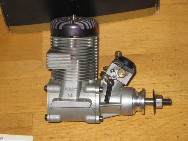

David,
Main problem(s) with my built up wing last year were weight (I don't know how to build light) and keeping it straight. Scott has brought me out of the ice age of old style foam wings with his great cores. I'm thinking I'll see a much lighter airplane this time around. Plus... the first build was pretty time consuming.
The vertical fin and rudder were framed in 1/4" x 1/4' and 1/4" x 1/2" strips of light balsa. Embedded a small piece of 1/4" ply to hold the steering "tiller" arm of the tail wheel wire, then 1/8" light balsa skins to make the 1/2" thickness I needed.
The Webra RE should be awsome. Tell me about the pipe you end up using.
The Tsunami was running the OS .55AX and it weighed (roughly) 7.5lbs. Really fast! Deception number 1 (with the Webra .61) was about 8.5lbs and flew pretty well once I got the engine problems solved. Would have been better if the wing had been perfectly straight and the weight a little lower.
