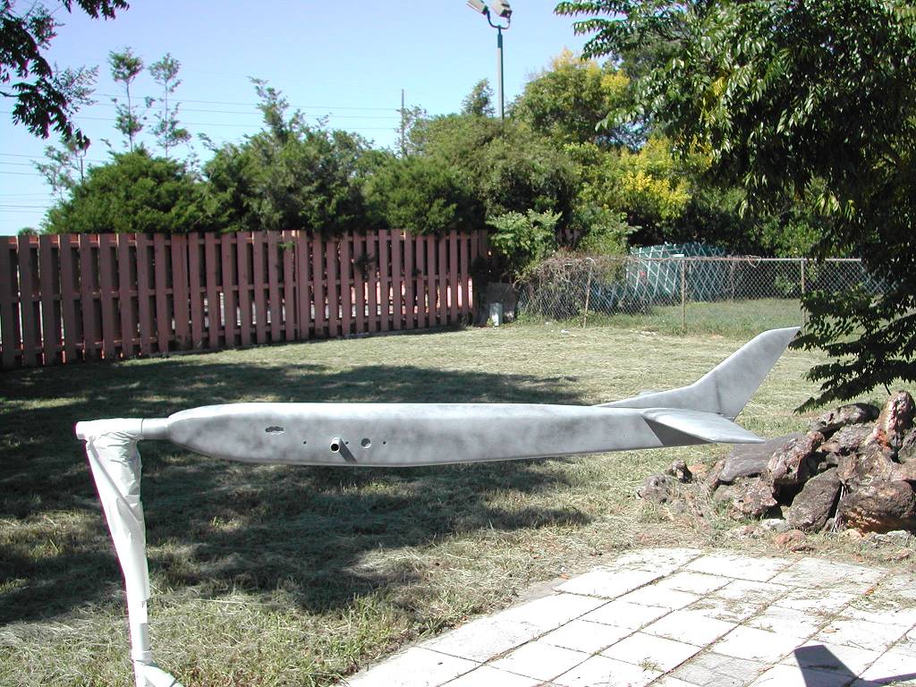

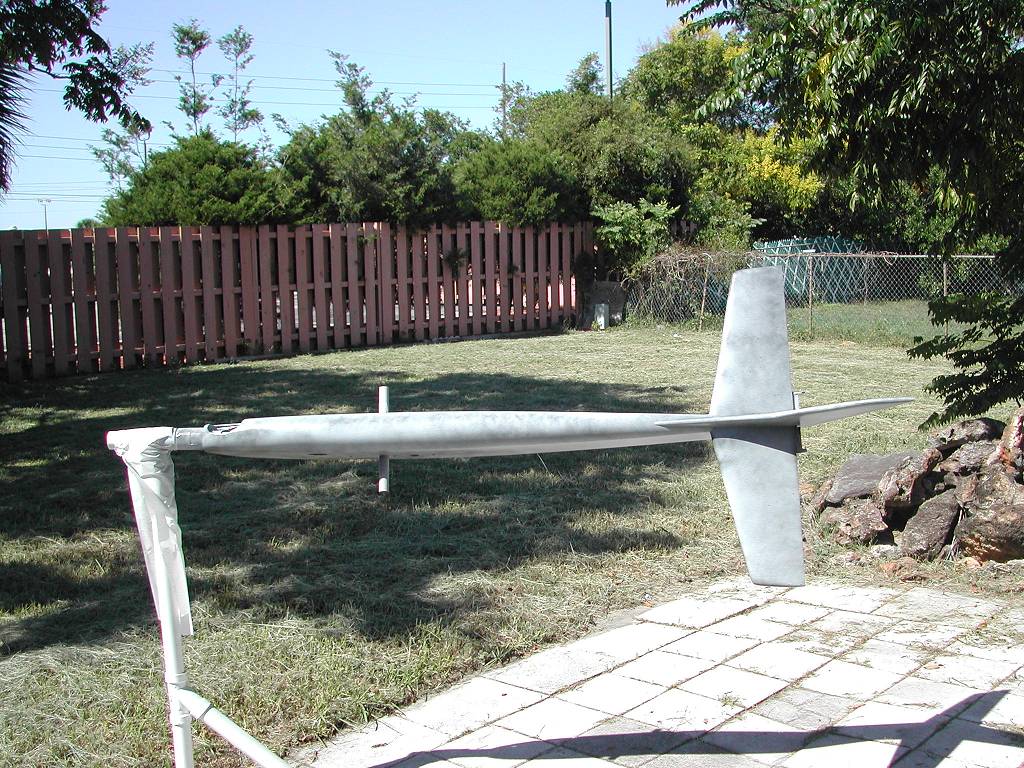

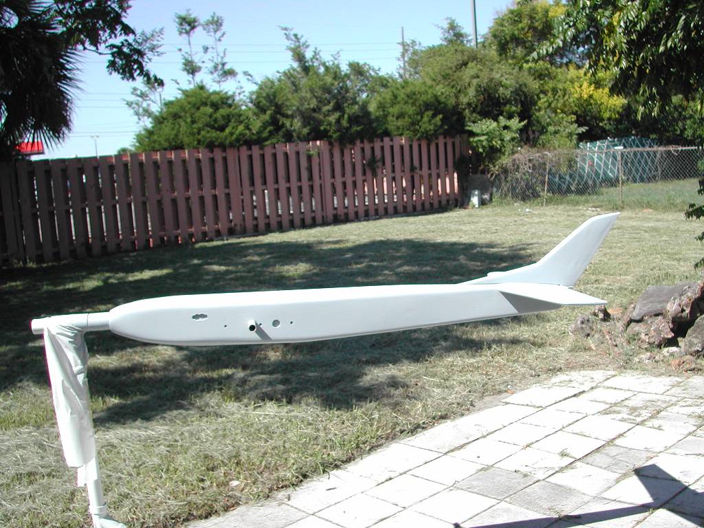

All Kazmirski paint schemes use the red/white/black colors, and all are variations of the red/white and black stripes, the top stripe being separated by a white band at an angle. Simple but elegant. I love it.
Bill;
For all practical purposes, nobody is going to be looking at how wide the L.E. black is underneath the stab. I didn't care that much about that measurement, but just let it work out. The red to black stripe up top can fall anywhere between the bottom of the stab, L.E. (which of course must be black), to the greatest thickness of the stab bottom...that should give you about 1/2" or so to "play with". The important part here is how the red to black strip looks on the side compared to Ed's picture. One of the side views shows you exactly how I did it. If I were going to paint mine again, I'd make the red stripe extend another 1/4" wider, (further down).
The main "cues" to me are 1) the bottom of the red to black line (stripe), and where it intersects in the stab area, (in all cases it must be below the L.E. of the stab). 2) the second is the top of the dash either running on, or very close to the thrust line, and 3) the top of the black stripe that is supposed to tuck what looks to me to be beneath the wing L.E. at least 1/2", (but maybe a little more depending on how things look overall). 4) I would use the place where the dash cuts through the wing as an important final cue in order to make final placement of the dash. The dash cutting through the wing is an important landmark; that's why I am probably more interested in this line, and where it falls on YOUR plane than any other marker. If it cuts through the wing correctly, you're there.
Of course, everything depends on the height of the wing, so if our final choice for wing placement isn't quite right then the white stripe may still be a bit too wide, but it should be much closer.You will be surprised what effect a 1/4" difference can make in adjusting the various stripe widths because making one wider makes the next one thinner at the same time. You DO have a little room to adjust the lines up or down to give the best overall effect. I use a pencil or even a pen for the final lines...you may have a much better way that guarantees the lines won't be visible, but that worked for me.
As I said in the earlier post, when I realized how thick that white strip was on the original prototype kit, (too thick!!), I raised the top of the black stripe right up to the L.E. , (raising it higher would make it noticably wrong, at least to me), in order to make the white stripe a little smaller, (this was done later, and shows up ONLY on the "wet runway" photo). You have some leeway in choosing the thickness and length of the dash, (the dash should extend almost to the back of the wing. Use the wet runway photo as guide, not the others because the dash was too short in the first pictures), and the space between the dash and the stripes, (both red and black).
When I'm home I'll include some detailed measurements of how mine was done..you can adjust yours from there depending on how things fall on yours. I'll exactly measure the length of the dash, and where it ends relative to the wing...NOTE: the dash is longer in the "wet runway" picture than it appears in the other earlier pictures. That should help you. I also need to measure the thickness of the white stripe that separates the red on top from the black at the back behind it. Mine originally was too wide, and had to be made thinner in order to look correct, (which I think it does now). Masking off that white stripe just before the fin that separates the red from the black is tricky because that part of the fuselage is pretty "busy" and precise, (how it is masked off also affects the fin and in turn the stab, and where the colors fall, so be careful here...(I'll include some measurements of how wide the black and red dash on the fin are), because you lose perspective with all that masking tape all over, and only see the "final product" when all the tape is removed after the fact.
As I said in a previous post, I was very happy with the fin and stab, (and how they turned out), so I think you can use my measurements (when I take them), with confidence if you choose to follow my lead there.
Hope all this helps. I have taken a number of "interior shots" of the double hatch areas including radio installation which I'll be posting soon. BTW...I had forgotten that my battery pack, (5-cell) was moved way up front by the tank, so watch the tail weight.

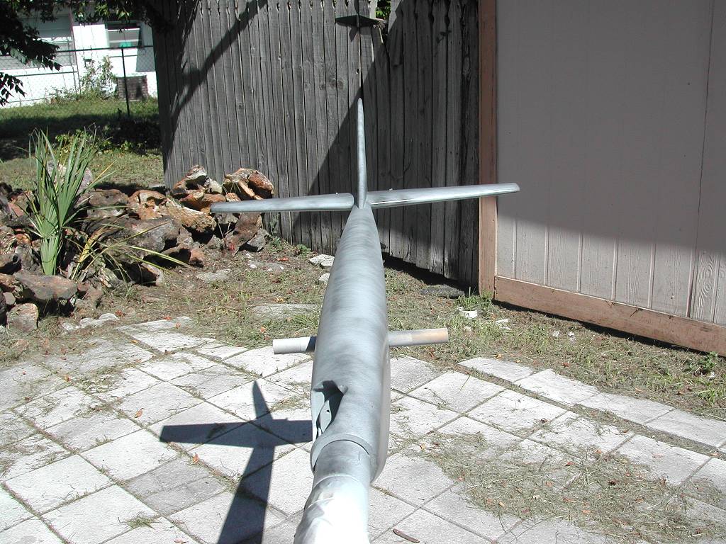

...... photos of rough dash layout......

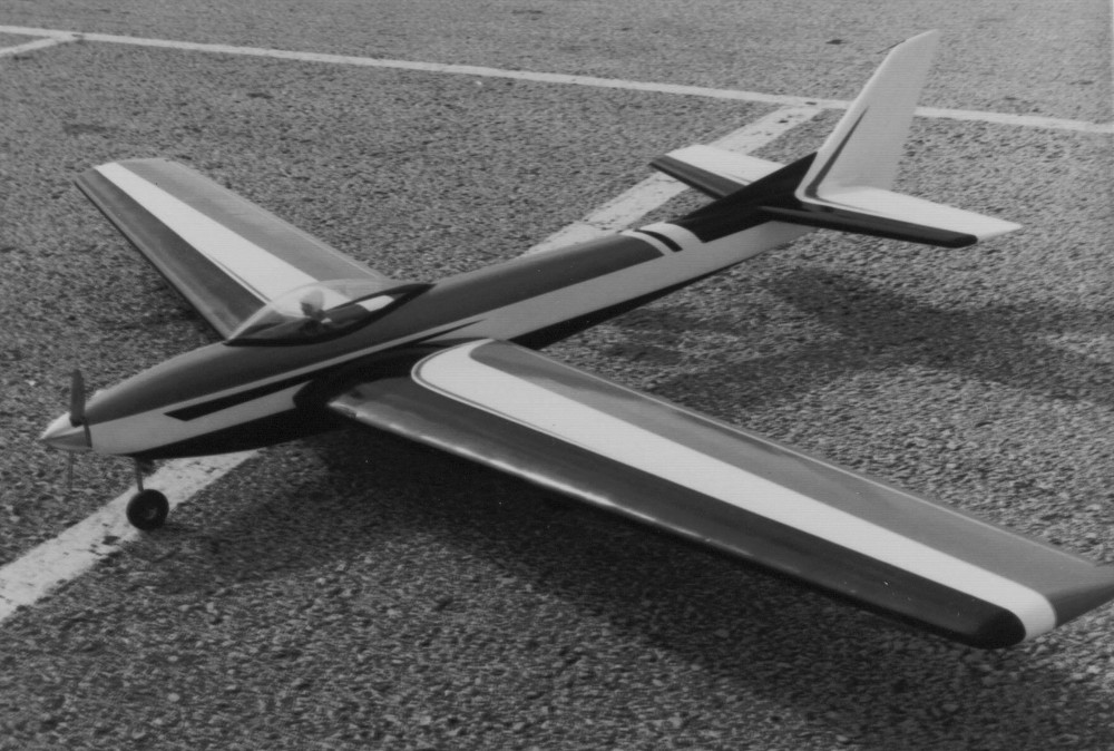

1) the dash needs a minor adjustment. The angle of the front of the dash is a little more angled than it needs to be, (it needs to be a little more "up and down"). If you make the angle a bit less steep, you'll probably have to move it forward slightly, and adjust the length.
2) the top of the black stripe line might be lowered just a bit, (maybe 1/4"). You can see on Ed's Simla that it doesn't go all the way to the back of the fuselage behind the stab....it disappears into the fuselage side.
Just an initial opinion. You have the model right there. What do you think?
Duane

Yeah, I know the front of the dash is angled too much and curved from top to bottom.I was planning on fixing that before it gets any paint.
I also am aware of the problem with the bottom black stripe. The problem there is more at the front than the rear. If I lower the stripe then it will begin to fall short of the front of the fuselage. It's true that it will stop farther forward from the stab, but it won't reach all the way to the spinner if I keep the lines all parallel. It is going to be difficult to get it just right, but not impossible. I'll just have to work at it a little more. After all I spent a whole 10 minutes laying out the rough draft.
I was just trying to get an idea of what it would look like so that I could share it with you and get your input. So far, so good.Basically, the top red/black striping will lay out very well all the way through the stab and the dash will work out too. I'm only going to have to work on the bottom stripe. Considering what we have to work with and the extrapolations involved, I think we will come out fairly well. I willdefinitely keep posting photos of the process so that I can get your opinion and that of any other concerned Simla builders.
Thanks again
Bill

I just noticed from the picture of Ed and the Simla that the lower black stripe could not possibly go all the way to the spinner. What was causing the confusion is closing in the nose as I did. The question now would be how to cross over from side to side at the front of the fuselage and how far back from the spinner? In other words, would it run square to the nose, curved to the nose or perhaps chevron shaped? What do you think?
My opinion is that the adjustments that you guys made brought it just about perfectly to where it should be. Only Ed would know for sure. But then that's just MHO. In any case I was pretty satisfied with the possible end results.

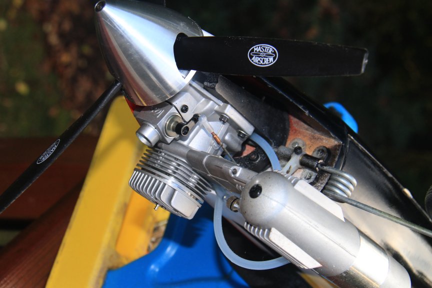

Did you have to mount your 1.20AX back as far as it would go? At least on mine, a rough fit shows that if I don't, the prop washer will stick out ahead of the nose, which we don't want.
Richard
Richard
#514
Joined: Oct 2009
Posts: 338
From: ORLANDO,
FL
Richard,
No. But then I think I may have added a small block to the very end of the fuselage since I chose to close it in. I typically leave room for the fuel lines to come through the center of the mount and around the engine.I would not be able to do that if I installed the engine as far back on the mount as it would go. The end point for the nose is somewhat adjustable. Make it longer, add a block. Make shorter, saw it off. Easy!
Bill
PS- Now that I think about it the fuselage nose is one of the few places where creative adjustments can be made without drasticallyaltering the overall scheme of things.
Bye Now
PPS- Theoretically, as you move the engine forward you could reduce the diameter of the spinner say 1/4" and get a sleaker/ slipprier front profile, as well asmoving the CG forward to offset any extra tail feather weight. Just a thought.

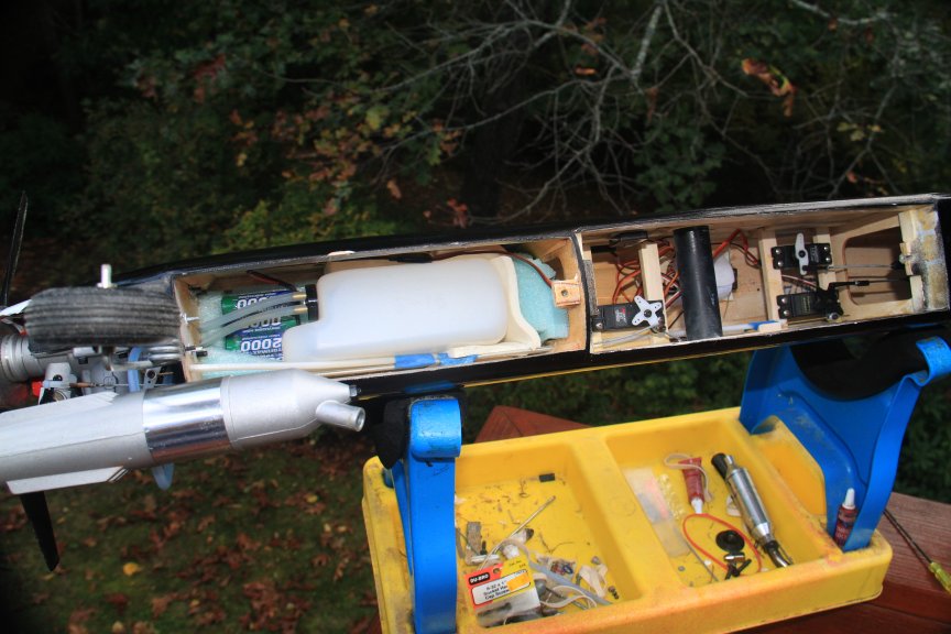

Here are the rest of the pictures. Notice the position of the battery pack ...at least on my plane. It has been awhile, but I must have found it necessary to do that to get the calculated C/G.
BTW...the Simla is the ONLY plane I've ever flown that flies equally inverted as upright with NO down elevator pressure at all when inverted. Maybe it shouldn't be that way, but right now it's kind of "neat" to just flip it over and not have to think about any DOWN elevator correction.
Duane

I had planned to leave bare spots for gluing. But painting the firewall is pretty mandatory, since I have pencil lines all over the front.
Cheers,
Richard

The additional pictures are posted in post #518. There is one of the engine compartment. One nice thing about Ed's decision to leave the compartment open on the original is the tremendous accessibility to everything. Because of the muffler, you hardly notice the compartment is open.
BTW...I'm pretty much done with additional photos unless there is something you'd like to see. I'd be happy to photograph any part of the plane if it will help someone.
Duane
