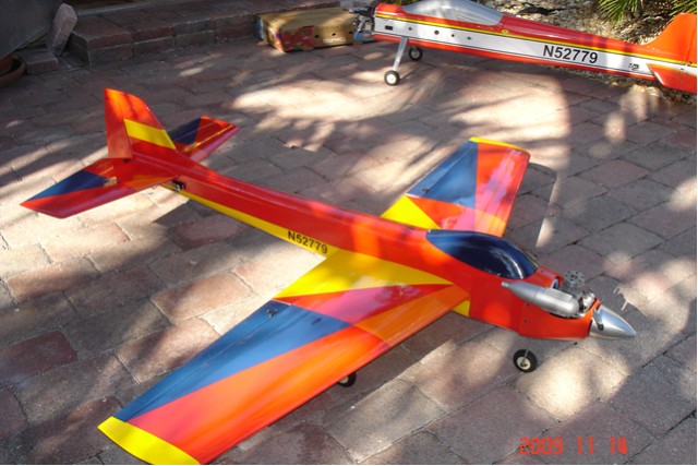

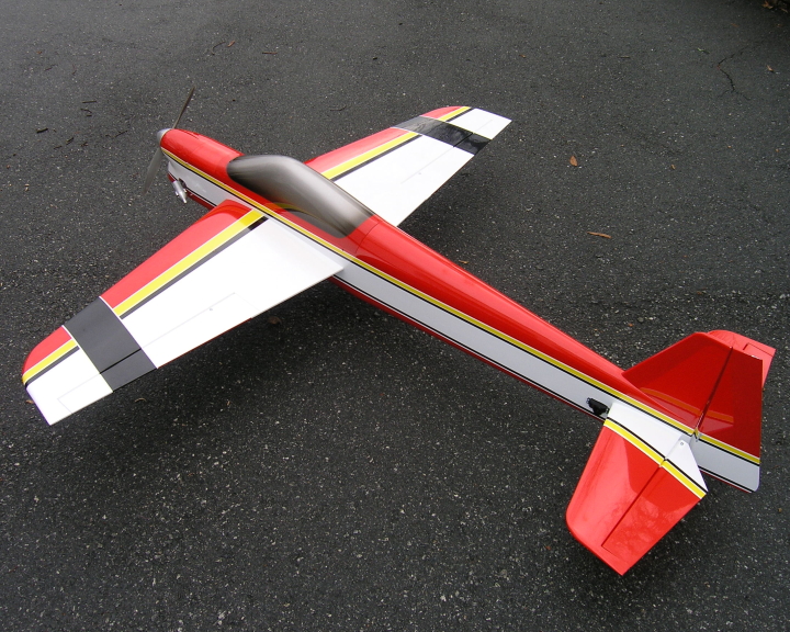

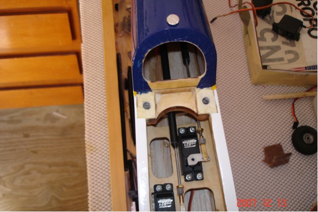

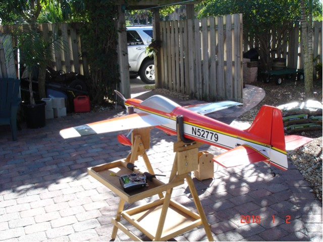

Here are a few picture's. Look at the picture's of the Intruder. You can see the one pix, where the wire's were used, the two piece's going to the elevator's, the plastic joiner at the servo end, not used, the wire's are wrapped with wire and soldered together. Look right under the wing bolt's, you can see the tube's. Another picture of DB pushrod's used, different plane.
Also, the aileron set-up, I make my own pushrod's out there, all 440.
There is probably some kind of Chinese rust preventative on the wire's. I stuck those dude's in there, and jimmyed them back and forth about a 100 time's, till they were loose to use in the tube's. The Cub is a bashed Arf, siamesed cowl, Saito twin.

#130
Chief....

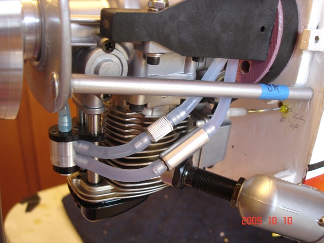

I cut into the fuse bottom at the former just in front of the tube exits.....then I just cut away the glue and with pliers ripped those crummy plastic tubes out of the airplane.
Mine had sharp bends in them which made the cosmoline soaked wires drag even more.
I installed Sullivan red and yellow pushrods.
I used the plastic pushrod joiner in my installation and it has worked well for a couple of years now.
The entire installation works Cadillac smooth now. This was a lot less work than putting servos in the stabs....and trying to balance the model.
My airplane balances just right with the OS91P, LiIo battery with Jaccio regulator....
Originally, the elevator servo arm would twist severly and would have broken off had I flown the airplane with the original wire pushrods and plastic tube guides.
For the wing bolts.....I tapped a couple of hardwood blocks for 1/4-32 and put nylon bolts in there.....same thing for the bottom hatch cover with an 8-32 nylon bolt.
The general construction on my model is pretty bad....especially the elevators.
Each ele half was built on a flat surface....wrong....this means the c/l of the trailing edge is not parallel with the hinge line....ensuring that each elevator cannot be aligned to the other.
So.....I split the difference...one side is too high...the other is too low....
It flys ok after I diddled the adjustments and got it trimmed off.....
Hopefully, other examples of this airplane are built a lot better than mine.

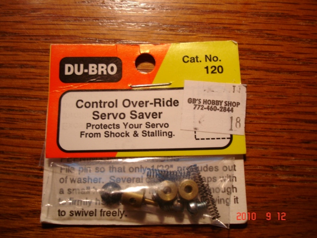

Throttle servo. Throttle over-ride. Hook up, no set screw needed at the center of the arm pin. I have secured this in the past, not needed. You can adjust the spring's, out and in, when too much stick is used, as in the old day's, this will prevent over riding on the servo, affecting the throttle arm on the carb, etc. This can also be used on the nose gear steering arm. With modern radio's now, we can use travel adjust. This is just a safety valve.
Stopped in the shop on way out to get the morning new's, picked up one of the package's for the over-ride. These are still available at your LHS, or order on-line. Few picture's one of the Intruder's in flight.
Vince

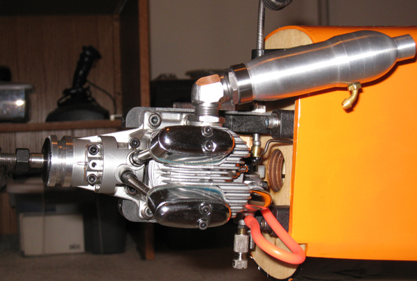

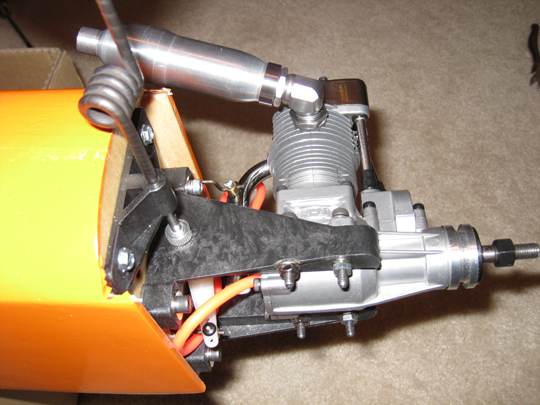

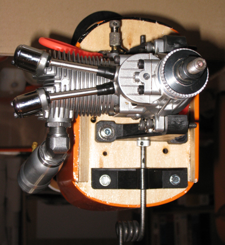

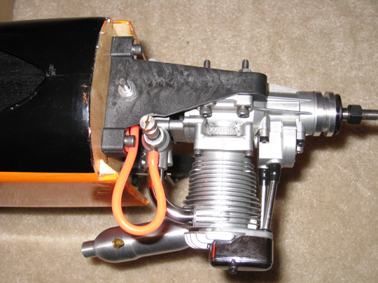

Never noticed that "overide" connector before.....
Looks like you're having a great time flying that Intruder. Are you competing with it? If so, do you consider it "competitive" with the other airplanes out there?
A few shots of the "business" end of my WM Intruder attached.....
Greg
