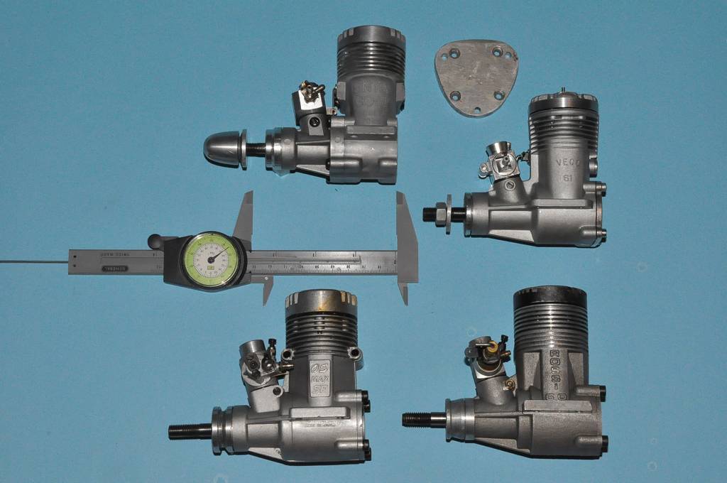

I have posted a shot of several vintage engines. Top left is the Enya .60 II/III which was Phil Kraft's weapon of choice during the glory days of the Kwik Fli III. Top right is a Lee/Veco .61 from the same period. These were "bypass-ported" engines. On the bottom row is an O.S. .61SF and a vintage Rossi .60. The O.S. and Rossi shown are both "Schnurle-ported" engines, and because of the port arrangement with ports fore and aft of the cylinder, they are physically longer. The calipers are set at the length of the longer engines and shown next to the older engines. Also pictured is a backplate style mount used on the Kwik Fli III, which were about 1/8 to 1/4 in. thick aluminum.
You can see that if you use a Schnurle-ported engine and a later style mount, you will increase the length of the nose substantially, possibly affecting the appearance and balance of the plane. I would recommend sticking with a period-correct engine, or use a modern small-case engine such as the O.S. .55AX to maintain the original style of the airplane.

Thanks for posting that photo RCDENT! The Veco appears to be the shortest of the group.

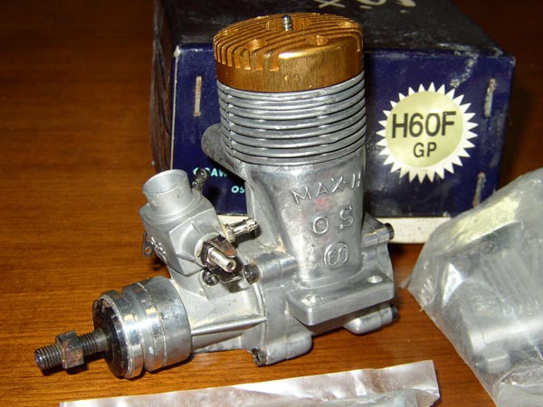

Today I received the engine that I'll be using on the Kwik FLi, a NIB O.S. Max H60F. I was expecting it to be a bit stiff and gummy since it had never been run, but it was very free and seems to have good compression. This weekend I'm going to try to find a clearer so I can deal with the corrosion issues on the case.
Can someone tell me what would be an appropriate prop for this engine? 12" x 7"?

OS Gold head's will turn almost anything in the 60 size prop range,
mine works best with a Master Airscrew 12 x 6
I found that a 12 x 8 made landings too exciting [X(]
My light weight ugly stick just would not slow down enough at idle with a bigger prop

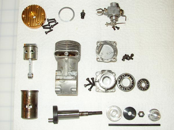

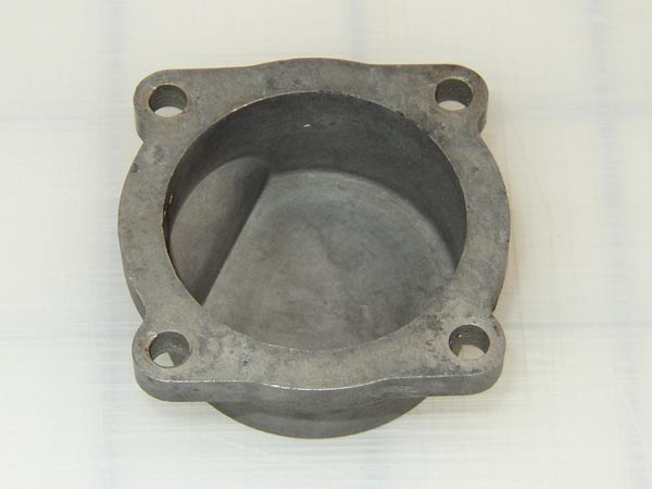

This morning I disassembled the O.S. Max H60F. I was a little concerned when I removed the back plate and head and saw what looked like rust on the sleeve! Turned out to be just some dried up oil and goo! The bearings seem good, just a little gummy. Overall the internals look pretty good.
I bought some Eagle One Mag Wheel Cleaner to clean up the corrosion on the cast aluminum parts. This stuff is a blend of three different acids! I tested it on the back plate first. The instructions say to spray it on and let it soak for 30 seconds then rinse with water. So I did that and it did clean it up a bit, but not to where I was hoping it would. So I it did it two more time and each time I let it soak a little longer, 1 minute and again for 2 minutes.
You can see by the photos that there is a definite difference, before and after. But it's still not quite what I was looking for. I was hoping the cleaner would etch the aluminum to the point where it would be a more even color. Somewhat like a new casting would be. Maybe soaking it longer might help, I don't know. I don't want to soak it too long and turn it black! Maybe I'm expecting too much, it does look much better than it did. I might take the back plate to work and hit it lightly with the bead blaster. This might give me what I'm looking for.

That wheel cleaner did an impressive job. Most would call it done at this point. After a very light blast, i would coat the parts in a good corrosion inhibiting penetrating oil such as ACF-50 or CorrosionX etc.
#38
And if this engine has never run, then 20% castor only fuel, 11x6 prop, slobbering rich, ie won't run unless the throttle is full open and plug lit. Then slowly leaning until it will sustain ignition by itself, lots of short runs. 12x6 and 12x7 props are likely to be too big, 11x7 or 11x8 will be the flying props. do not run lean, you can't get new liners and rings, and it will only take one hot run...

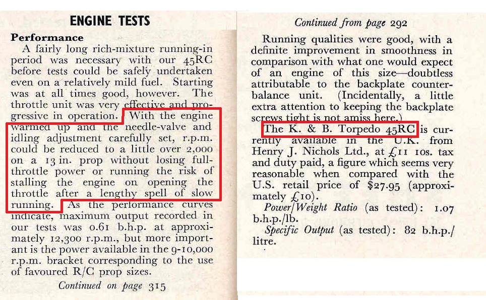

The K & B 45 RC was a wonderful engine, I did tell it often before. With 75% of engine volume the engine not even did have a ring, but you could became world champion with it!!
See picture 1
Cees

I understand Ed, I could not resist because it isn't a Dutch engine and I have to tell you this!
About the engine, see picture.
Cees

OK, I finally got around to finishing this engine restoration project.
The wire wheel cleaner took care of the corrosion although not as well as I had hoped. I tried bead blasting it to get a more even color/texture on the casting, but the beads we had in our blaster at work were a little course and I wasn't happy with the result. So in the end I just used steel wool and good ole fashioned elbow grease! It took several hours of rubbing, but I think the results are very acceptable and this engine should work out just fine for the Kwik Fli MK III. It has very good compression!
One thing I didn't get with the engine is the carburetor instruction sheet. There is no model number on the carb, just the O.S. logo. Does anyone happen to have a copy of the instructions they can post?
RG

My Feedback: (17)
ORIGINAL: R_G
RG
RG

Looks like the copper cleaner does a nice job! I'll have to keep that in mind for future use, I don't really want to tear the engine down again.
Thanks Mike!
RG
